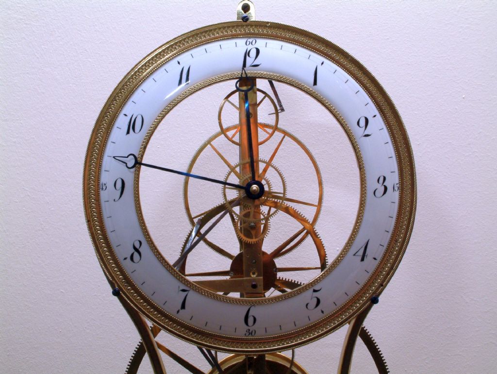

                                            I would have thought dividing to that precision would be well within the capabilities of the clockmakers of the time.
                                            This is mid 19th century work.
                                            The dial is 230mm across, the third wheel (centred in the dial) is about 75mm diameter and less than 1mm thick. I haven't counted the teeth. And I don't think I want to try and make it!
