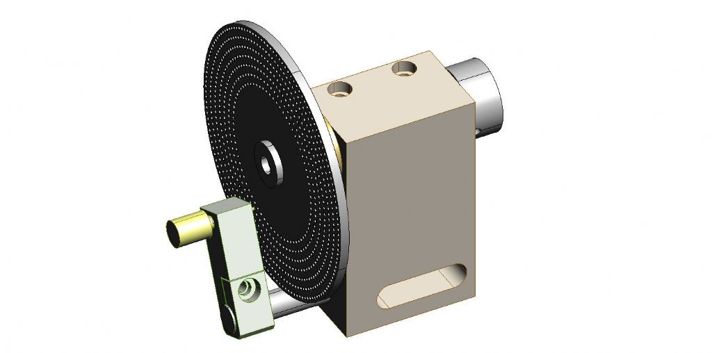

      Hello All
      As I stated, I’m a total novice in clockmaking.
      I have already got a lot of help from your guys.
      Right now I’m working on a dividing device that should make me able to cut wheels and pinions.
      The device I intend to build as a direct drive unit, i.e. the dividing plate i fix to the shaft chuck – øøeh hope this gives meaning.
      Now I have made the plate with the following set of locating holes :
      140-130-120-100-96-80-76
      This should give a lot of dividing setup, but before I go on, I would like to know if I should ensure other numbers of locating holes, in my effort to make useful wheels and pinoins for clocks.

        #63120
        MICHAEL WILLIAMS
          @michaelwilliams41215
          There are several numbers which can’t be indexed directly with your plate but rather than build up a collection of plates for all purposes best wait until you know for certain which numbers you need and work from there .
          There are other things that can be used for indexing such as gears . Also worm and gear set ups with simple plates which can be contrived to index almost anything .
          When indexing small numbers such as for the teeth on a pinion it is usually better to make or find an index plate/gear with the actual number of counts in it – this avoids mistakes which readily arise when trying to count index advances of say ten holes in a seventy hole master to index seven teeth .
          Accurate index plates for small numbers of divisions can be made directly without having another plate to copy .

                          #63492
                          Mogens Kilde
                            @mogenskilde92996
                            Hi All
                            I think it’s time to show my CAD of the intended tool
                            Mogens
                            Edited By Mogens Kilde on 03/02/2011 21:42:34

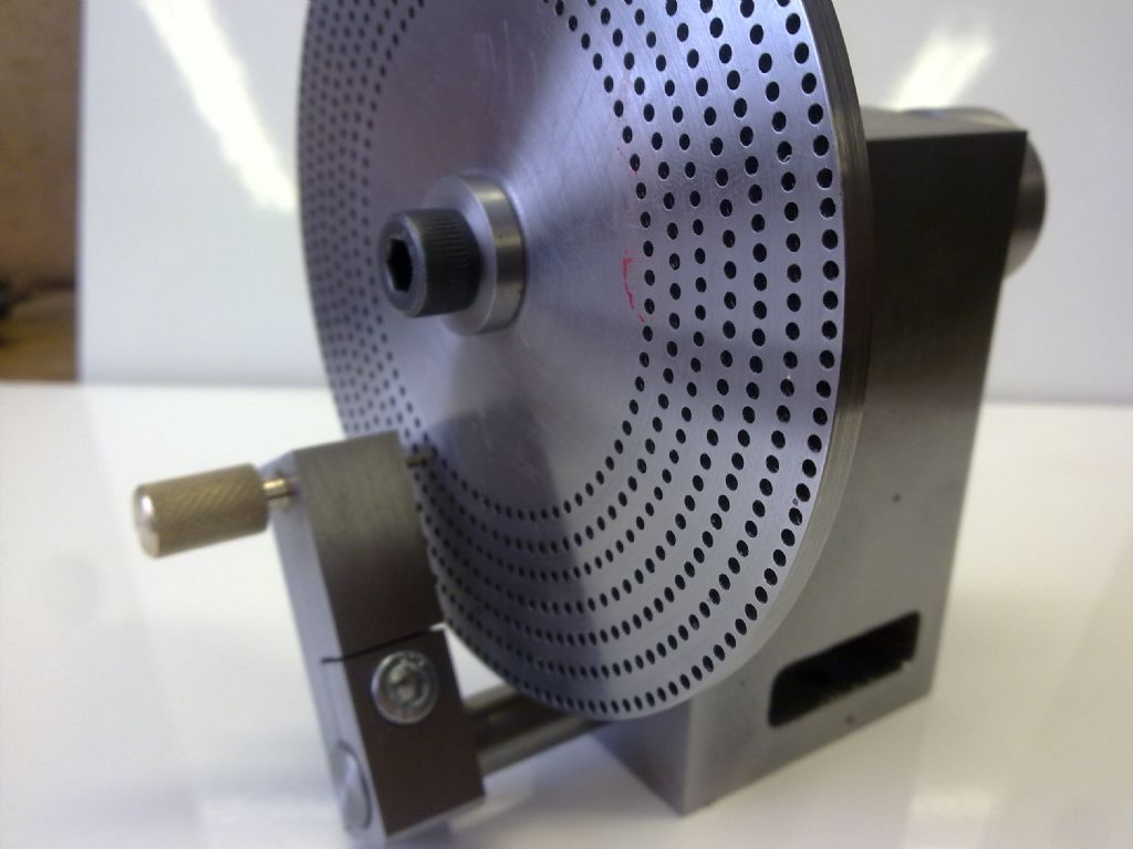

                            #64906
                            Mogens Kilde
                              @mogenskilde92996
                              Hi All
                              I now have finished my dividing tool
                              http://m_kilde.skysite.dk/
                              Edited By David Clark 1 on 18/04/2011 11:03:22
                              #64930
                              Ian S C
                                @iansc
                                Morgens, do you have some way, other than the indexing pin to lock the shaft? It looks a very usful tool, and nicely made. Ian S C
                                #64958
                                Mogens Kilde
                                  @mogenskilde92996
                                  The main shaft is locked in the tool post after indexing
                                  Edited By David Clark 1 on 18/04/2011 10:59:09

                                        #66944
                                        Versaboss
                                          @versaboss
                                          Ahem, cough, Michael, do you really need a plan to clone such a gadget?
                                          No big secrets here I think… But the clamping method for the detent arm is a nice solution; I hope to remember it when the need arises next time.
                                          Greetings, Hansrudolf
