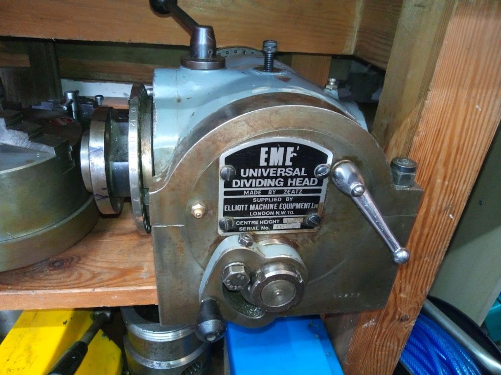

                    Robert T: Your dividing head bears a resemblance to my EME model. Not an exact match, but similar in many features.

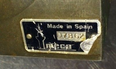

                          Posted by Robert Trethewey on 27/03/2022 14:30:32:
                          I recently purchased a 6in dividing head and and have stripped and rebuilt it – However the original manufacturers nameplate had the name rubbed off – please can anyone identify for me the original manufactrurers name as the name plate says Made in Spain the part number is D1494A and it appears to be a Hoffmann type unit it weighs 50Kg it has a double sided plate with hole circles ranging from 49 down to 15 holes per circle it has a DIN 55022 or DIN 55027 faceplate see attached images 24 stop positions and power feed via 25mm shaft 6mm key
                          My album Robert Trethewey (6in Dividing Head Rebuild)
                          Name Plate
                          Here you go:-

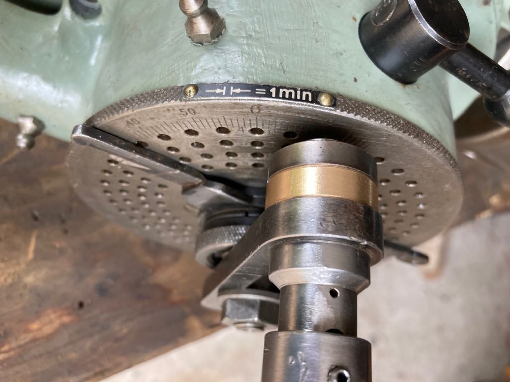

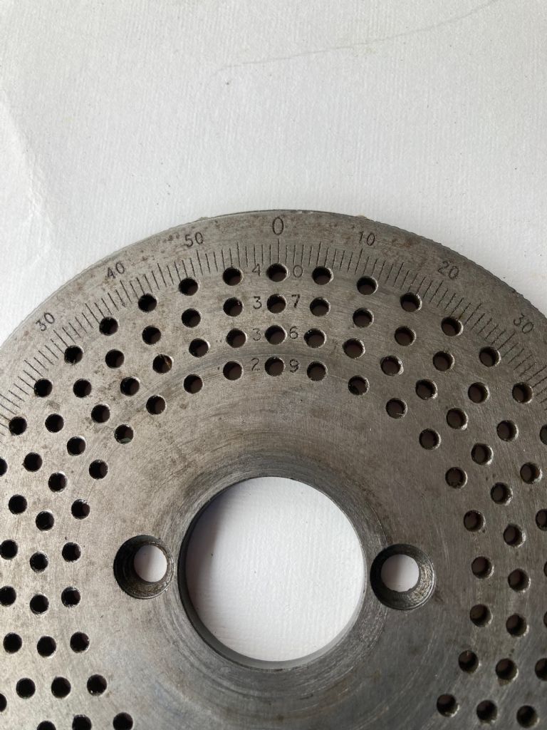

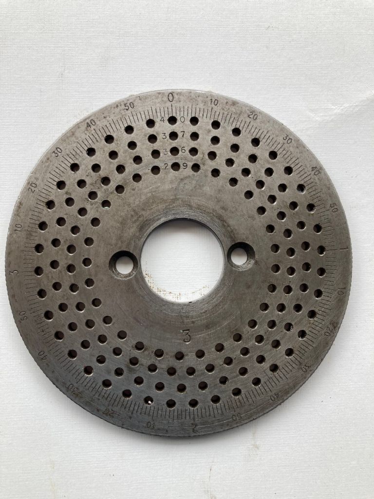

                            Hi: Can anyone please help me identify the Dividing Head shown in my latest album 4in Dividing Head the item I'm most interested in is finding out if anyone knows where I can find new or used pin plates to go along with the number 3 plate that came with the DH when purchased. The DH is a 4in the pin plate is 123.6mm dia. and has a knurled edge with a black plate pinned on the outside circumference saying each division =1mm the plate is 5mm thick it has a 30mm inside dia. the number 3 plate has 4 sets of drilled holes 40, 37, 36 and 29 holes. The plate is attached to it's backing piece by two chamfered screws the holes are 3.3mm dia. and have a 42mm PCD

                                  Robert,
                                  You say in your post that the outside of the plate shows 1 division = 1mm, but the photo shows 1 division = 1 min. Either a misreading or typo.
                                  Sorry, can't help with the identification. They are all basically the same internally – at least in the manner of their function – what you need to know is the worm/wheel ratio to aid with the choice, or design, of additional plates. Yours is unusual in that it is secured with only two screws. Most that I've seen use three. That, in itself may help to narrow down the manufacturer.

                                                I've had another look at your album and I see that there are 360 divisions around the periphery of the plate. That would make the worm ratio 90:1, so that 90 turns of the handwheel results in one full revolution of the table.
                                                #594417
                                                  Posted by John Hinkley on 14/04/2022 17:28:46:
                                                  … That would make the worm ratio 90:1, so that 90 turns of the handwheel results in one full revolution of the table.
                                                  I started with that, and thought the dividing plates for Robert's machine would have the same number of holes as an HV6. But they don't!
                                                  HV6 plates have:
                                                  A: 15, 16, 17, 18, 19, 20 holes
                                                  B: 21, 23, 27, 29, 31, 33 holes
                                                  C: 37, 39, 41, 43, 47, 49 holes
                                                  Which match the corrected table supplied by Howard Lewis.
                                                  Whereas Robert's No 3 plate has 29, 36, 37 and 40 holes
                                                  Presumably, HV6 plates will work on Robert's Dividing Head providing his machine really is 90:1 and the plates are the same size. I'll measure mine and report back later.
