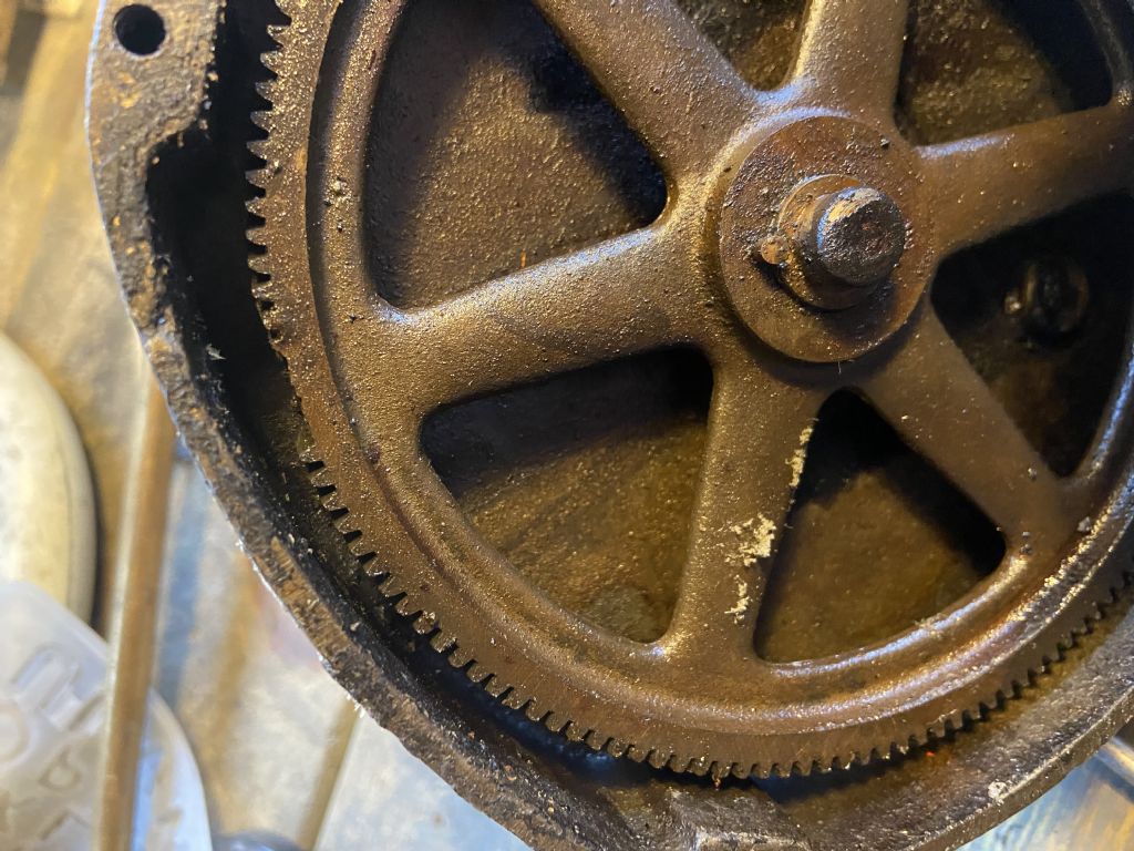

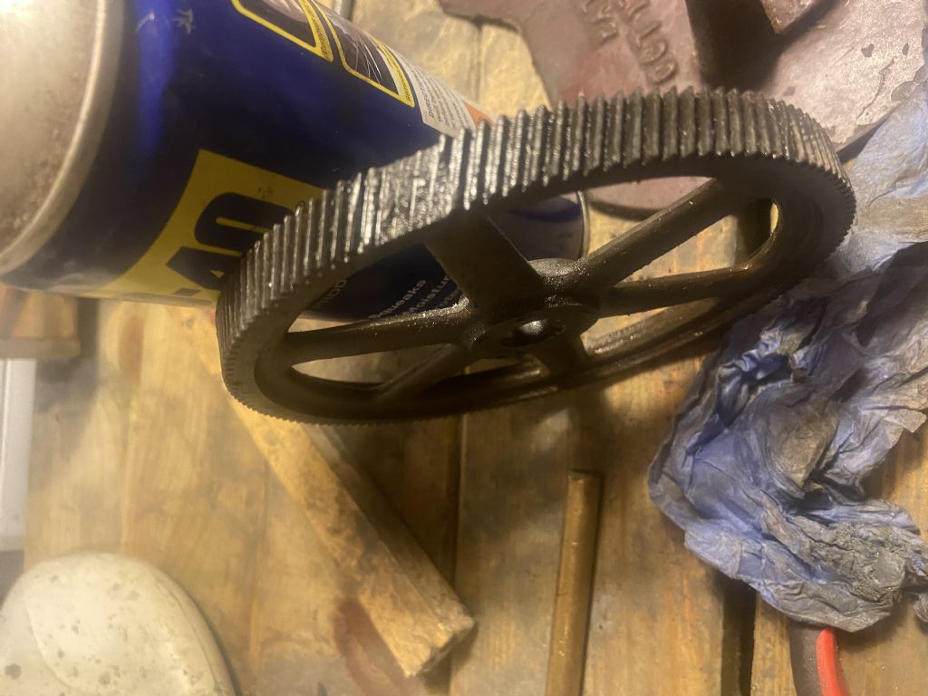

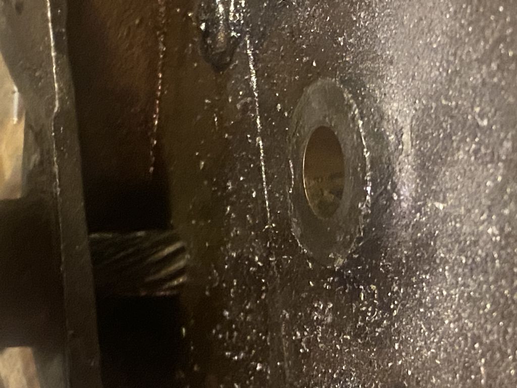

      I took another look at the grinder I want to fix, looks like it’s a 5 1/4” gear with 144 helical teeth.
      Perhaps I will start with a couple of change gears for the lathe!

        Well you could always just use the existing gear to index 144T on the new one or just make a section to fit into the gap and save yourself the cost of a dividing head.

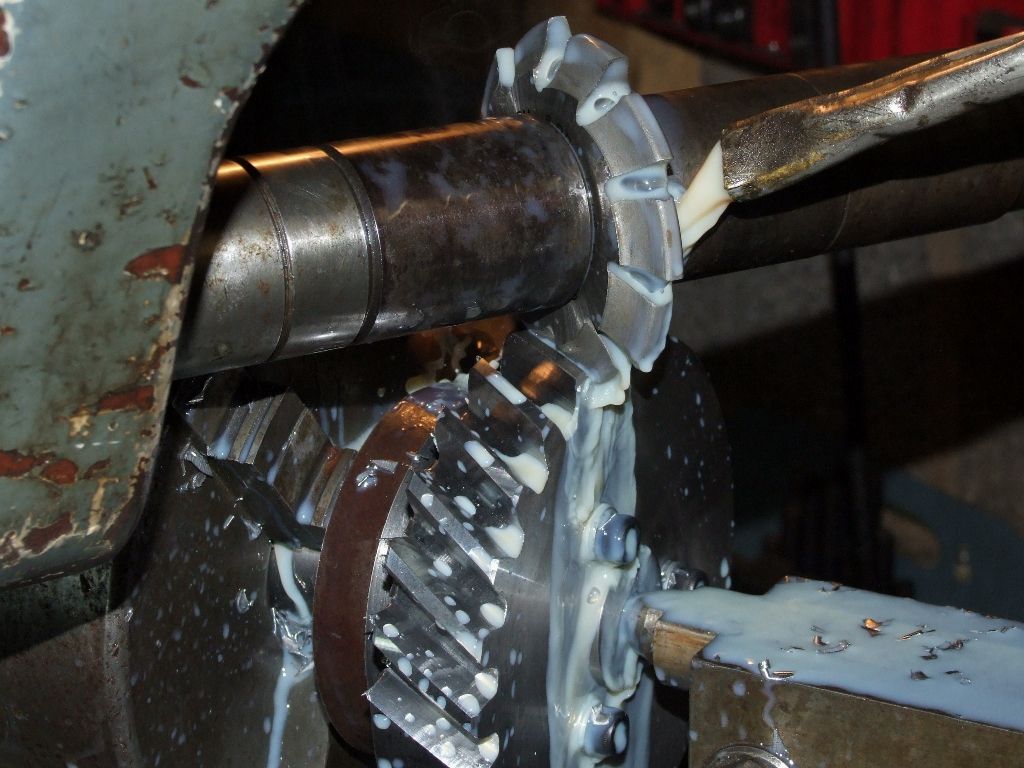

          If it is a helical gear then one ideally needs a universal dividing head (where the dividing head can be driven by the table leadscrew) and a universal mill (where the table swivels). Like this:
          To cut the tooth spaces on a helix:
          However, if the gear is narrow, and the helix angle small, then one might be able to get away with a straight cut at the helix angle. A picture of the gear in question would be useful.
          Andrew

              here’s a couple of pics Andrew. The small gear is clearly helical, but the large one (the one I want to remake) may just be diagonal cuts. I would say that if a universal table and head is needed, that’s well beyond the scope of me and my little mill. I’ve just had this grinding wheel for ages, it has a broken gear, and I thought it might be a decent little project to learn the process. But perhaps not… there are probably much easier ways to fix it – a welder and a file come to mind.
              Steve

                    The thing is, the pic shows the worst area but there are several other damaged teeth, perhaps 5 or 6 damaged areas altogether. One other damaged tooth can be seen in the pic of the gear out of the casing. Hence why I was considering making a new gear originally.
                    The purpose was to learn how to do it rather than necessarily fix this 110 yr old grinder. But fixing it is on my list of things to do so I thought perhaps I could combine the two.
                    Anyway, assuming I am going to do the repair on the mill and not with a file, I would still need a chuck or arbor holding device to keep it steady and concentric. If so, I may as well get a dividing head or similar.

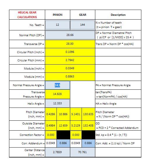

                      144T and 5.25" dia gives 27.8 DP, so 28DP, for a 5.21" OD?
                      Since it is an old machine, a guess says 14.5 P A?
                      Relatively easy, if it were a spur gear. The inclined teeth make it more difficult, but not impossible, if the teeth are straight rather than genuine helical.
                      So the D H will need to be set at an angle across the table of a horizontal mill or inclined on a vertical mill.

                        The equation for OD, number of teeth and DP for a spur gear does not work for a helical gear. The helix angle also needs to be taken into account. A helical gear has two DP values, normal and transverse. Normal DP is most common, ie, the DP at right angles to the helix. If I get time I'll look at the numbers in more detail later.
                        My gut feel is that straight cut teeth would probably work, although it would depend upon the precise application and how fast the gear runs. I'm not sure what grinder means; the gear shown looks similar to that on my defunct power hacksaw, used to give a substantial speed reduction.
                        Andrew

                              Ah so the big one is the pinion
                              You can use an online calculator to work out angles and the DP. I did it for 12T & 144T but just change the tooth count to suit your machine

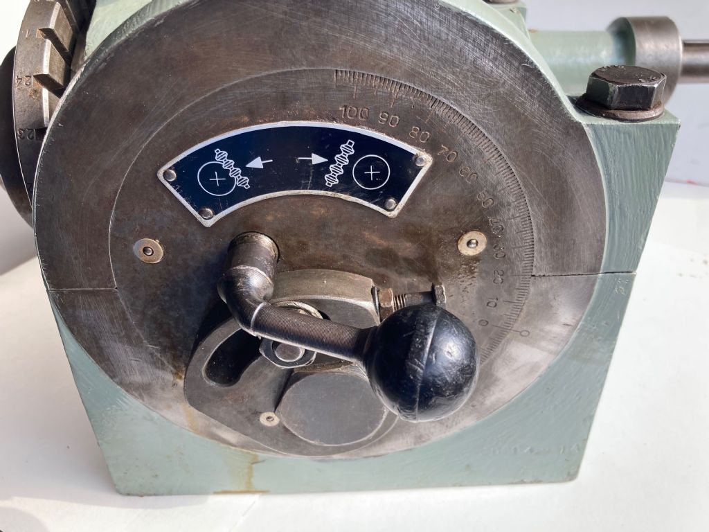

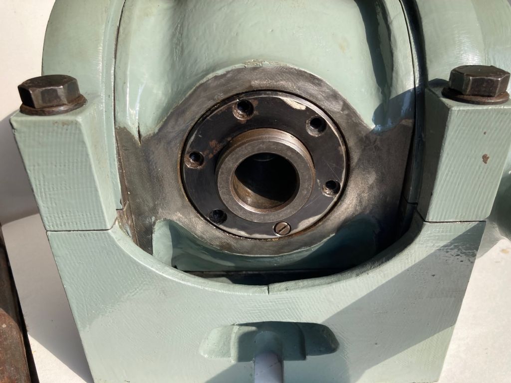

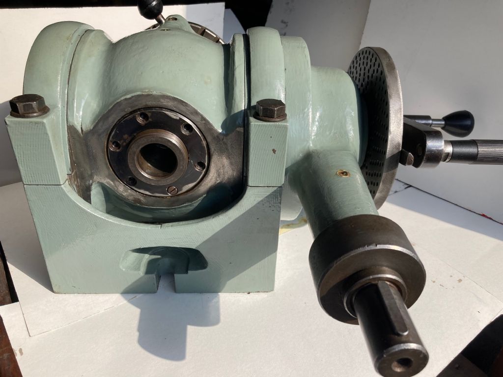

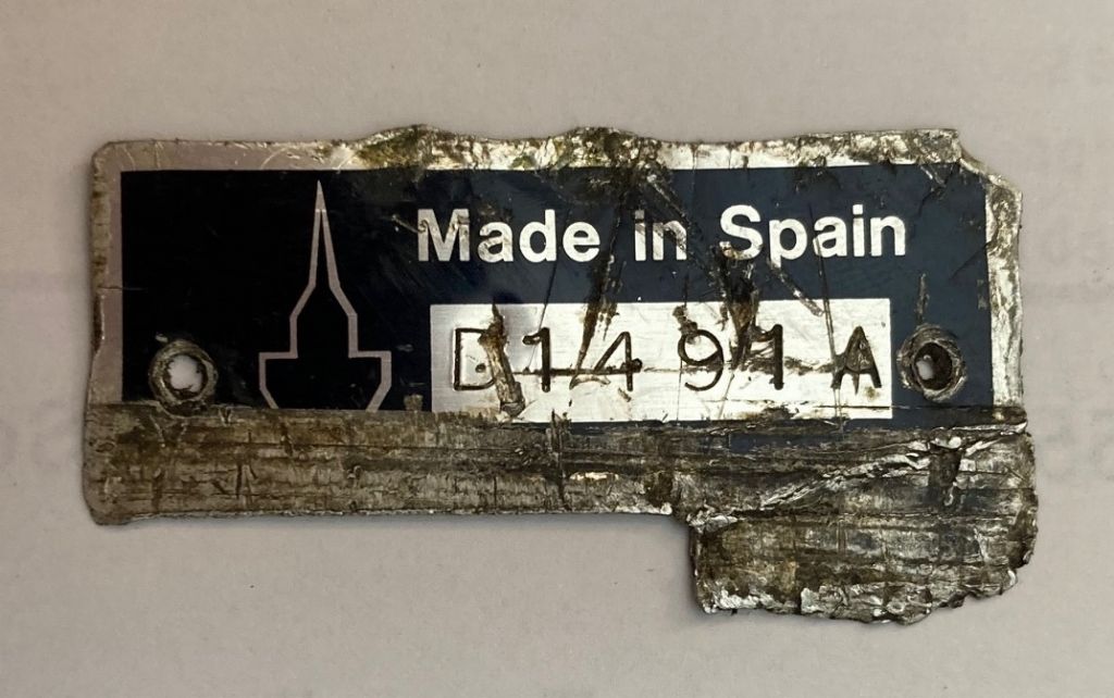

                                                    #591727
                                                    Robert Trethewey
                                                      @roberttrethewey

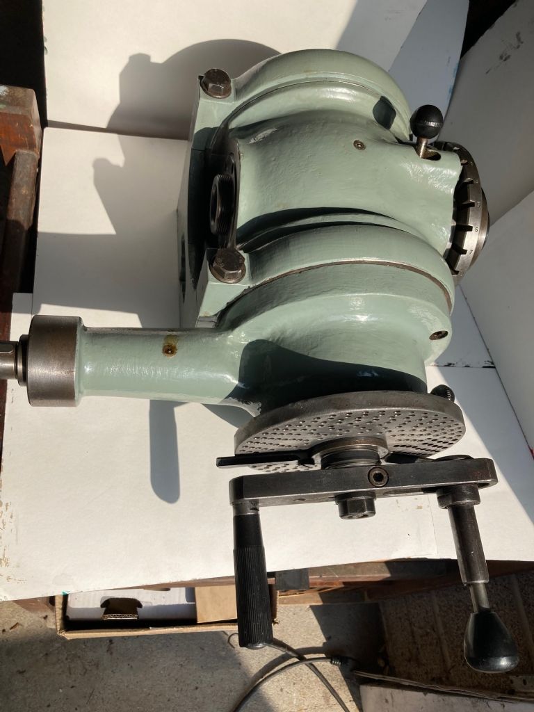

                                                      I recently purchased a 6in dividing head and and have stripped and rebuilt it – However the original manufacturers nameplate had the name rubbed off – please can anyone identify for me the original manufactrurers name as the name plate says Made in Spain the part number is D1494A and it appears to be a Hoffmann type unit it weighs 50Kg it has a double sided plate with hole circles ranging from 49 down to 15 holes per circle it has a DIN 55022 or DIN 55027 faceplate see attached images 24 stop positions and power feed via 25mm shaft 6mm key
                                                      My album Robert Trethewey (6in Dividing Head Rebuild)
                                                      Name Plate
