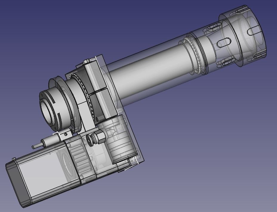

                                I have a 80 mm Saba rotary table. It was cheap (€ 60,–) and a peace of junk but I have used it for many years. I use the rotary table mainly for milling gears and hex nuts.
                                I build one (40 mm) that fits in my vice so it is ready to use in seconds. It is controlled by a Nema17 stepper (1:30 gear ratio) and locked pneumatically. I used 3 mm balls to make 45° contact angle bearings so the spindle is free of play. I fitted an ER32 collet holder for clamping 20 mm bars. The runout measured at the collet taper is 0.015 mm.
                                Once it is ready (documentation and video) I will publish a video and the (freecad) drawings. I estimate it will take about 40 hours to make one.
