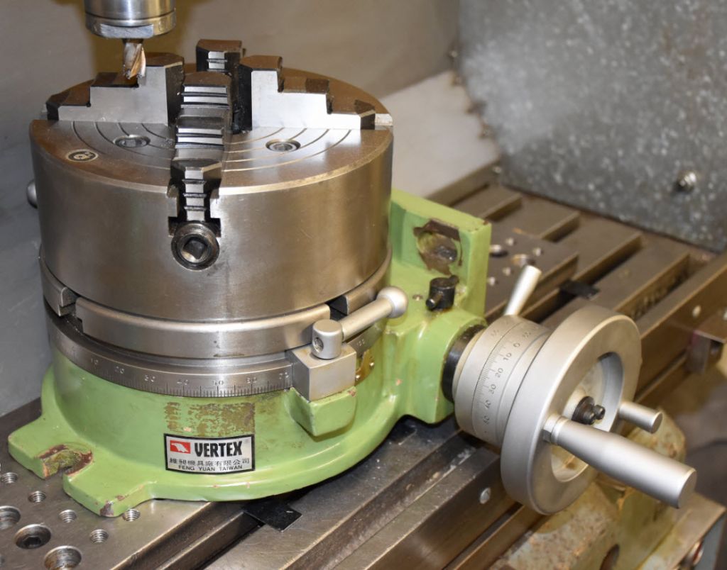

                        #376149
                        John McNamara
                          @johnmcnamara74883
                          Hi All
                          Below are some photos of my 8 inch Vertex rotary table, as you can see it has 4 slots, the cover plate at the bottom is attached with 3 set screws. I cannot see a bearing however I have not removed the setting collar with set screw. I can see an inserted steel outer part in addition to the collar there is grease in the joint Judging by the small hollow centre shaft I suspect there may be a ball or roller bearing?.
                          The table has a Morse taper centre hole.
                          I purchased this table between 1980 and 1984 I know it was used in my first workshop hence the date range.
                          The label is not pinned on just a stick on that fell off a while back. I keep it in a drawer.
                          I will pull it apart when I have the time.
                          Regards
                          #376152
                            I would expect hat the 'eight screw' base insert is similar to that on my Vertex 'Rapid Indexing' table:
                            Four screws adjust the clearance, the other four lock it in place.
                            … Plain bearing surfaces throughout.
