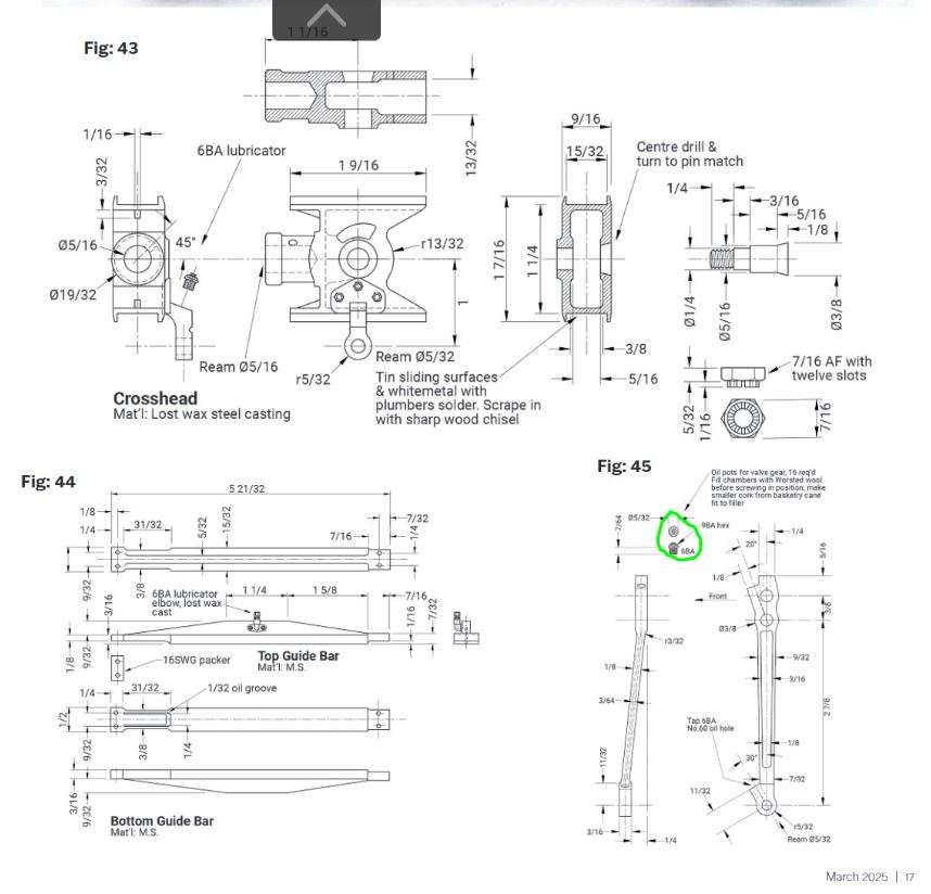

                      If several “figs” are to be placed next to each other it may make things clearer if they each had a box around them as they did in the past. These three all blend into one.
                      scale 1
                      Also someone with an idea of what scale items need to be shown at should really check the drawings. With the number of those lubricators needed they warrant a decent size drawing of their own, I can’t even make out the detail blowing them up to max size on the digital version.
                      At least 3 articles have missing dimensions on the drawings, a glance over by someone who could say if they could make the part from them or not would not go amiss.

                        #784533
                          Sprung Parting tool Fig2 is missing overall sizes which means you can’t locate parts from the edges. Also slot width for tool missing.
                          Fig 44 Above missing Hole diameters
                          Fig 45 Diameters of the two larger holes
                          Fig 46 Hole dia of the three on the PCD
                          Fig 47 Die block pin lined up with 5/32″ hohe not with teh Die block so cannot be assumed it should be 1/8″ dia to fit the block
                          Mill Belt conversion no hole diameters again for the three holes.

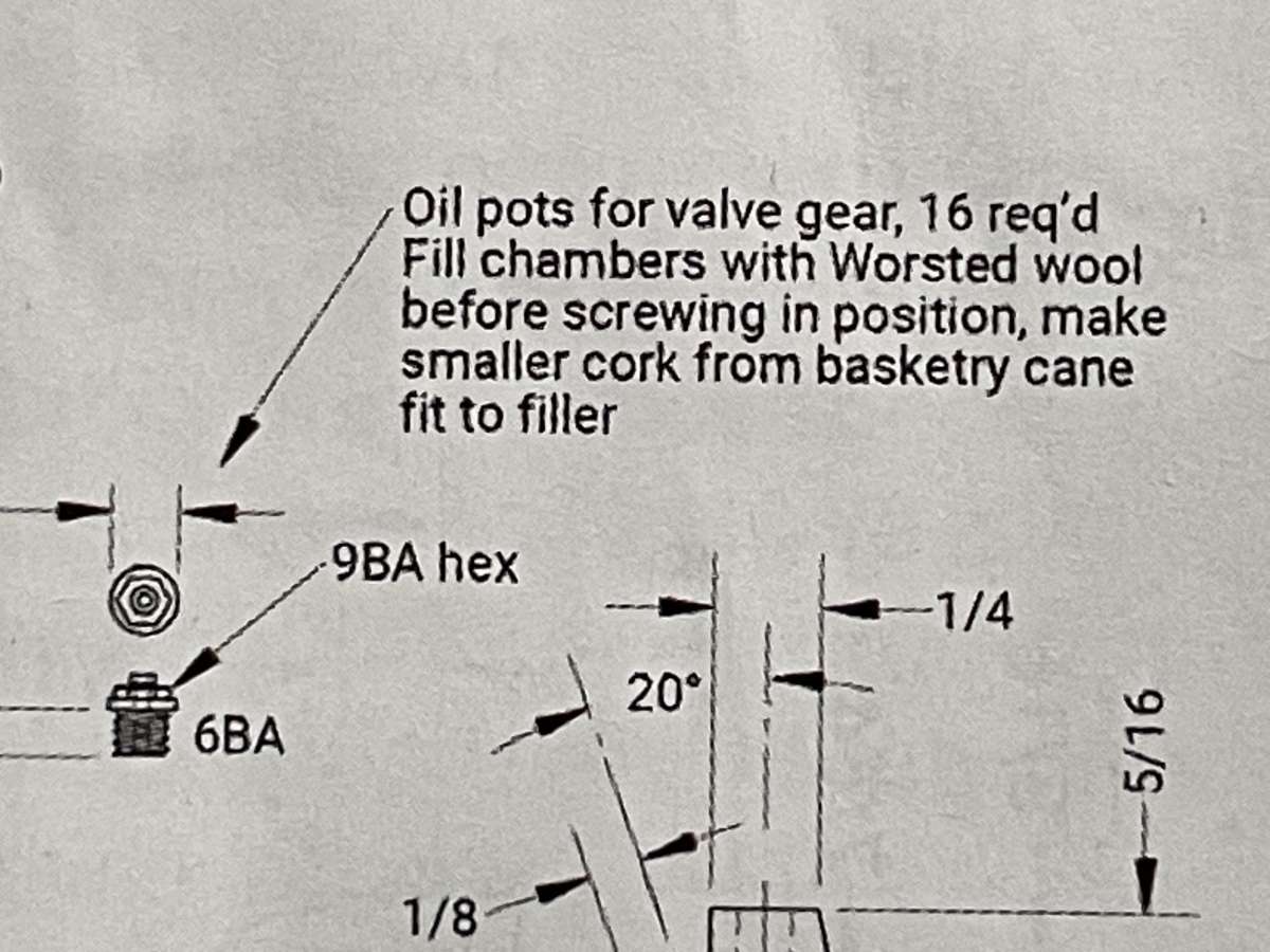

                          #784543
                          Nicholas Farr
                            @nicholasfarr14254
                            Hi, with respect to the oil pot details in the drawing above, although they are small, I don’t have any trouble reading the details with my prescription glasses, in the printed mag, I’m guessing the scan must be low resolution, as it scans at 300 DPI okay. But of course that makes it a bigger size file.
                            Regards Nick.

                            Grahame Chambers 1
                              @grahamechambers1
                              Thanks for pointing those out, the missing dimensions weren’t on the author’s original drawings.
                              #784596
                              Grahame Chambers 1
                                @grahamechambers1
                                Regards Nick.
                                Thanks Nick
                                #784607
                                  Still waiting for my paper copy to compare with the digital
                                  Yep you can only work with what you get. But surely as you draw them you must notice that there is no size given. It would be nice if the system allowed for obtaining what is missing

                                    #784713
                                      Whilst we’re waiting for Jason’s print copy to arrive … here’s a photo of mine
                                      Taken on the iPhone 12
                                      The detail in the printed magazine is MUCH better than I can see in the Digital publication … Now I am really confused !!!
                                      IMG_0242
