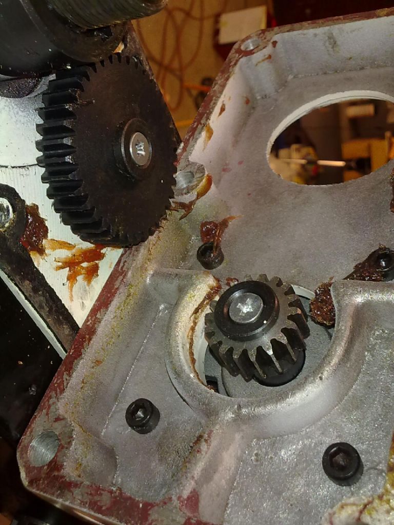

      I´ve started do strip down my Chinamill and im up for some good advice, but first the pictures :
      #16548
      MarcuSweden
        @marcusweden
        Stripping down Chinamill
        #50732
        MarcuSweden
          @marcusweden

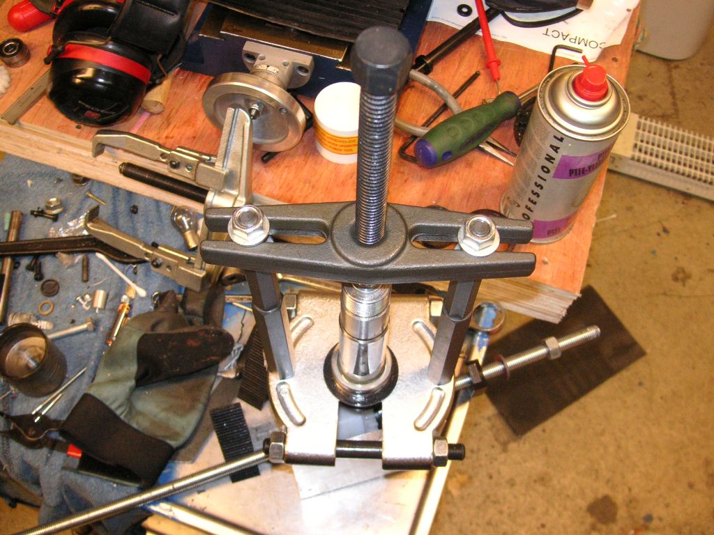

          Very easy and straightforward to strip down this little machine.

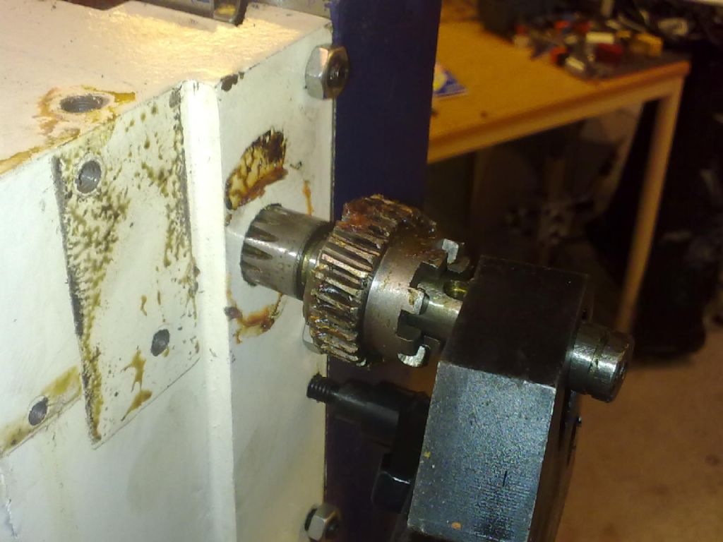

          But here on the gearwheels both on the motor ( metal ) and on the spindle it is bone dry ! Shouldn´t it be a little grease here or something ? I think so.
          I´s a little bit hard to se here on this picture but i know WHY the fine feed doesnt work , that´s becouse the gearwheel we se here on the picture doesnt have any spline or loctite or nothing that stick it to the other part. So when i turn the finefeed wheel with my hand nothing happends beside with the finefeed gearwheel. Nothing else happends so ofcourse it will not work – how did they think about this in the factory ? Did they think ?
          But this will be my second problem and some splines will probably fix it up.

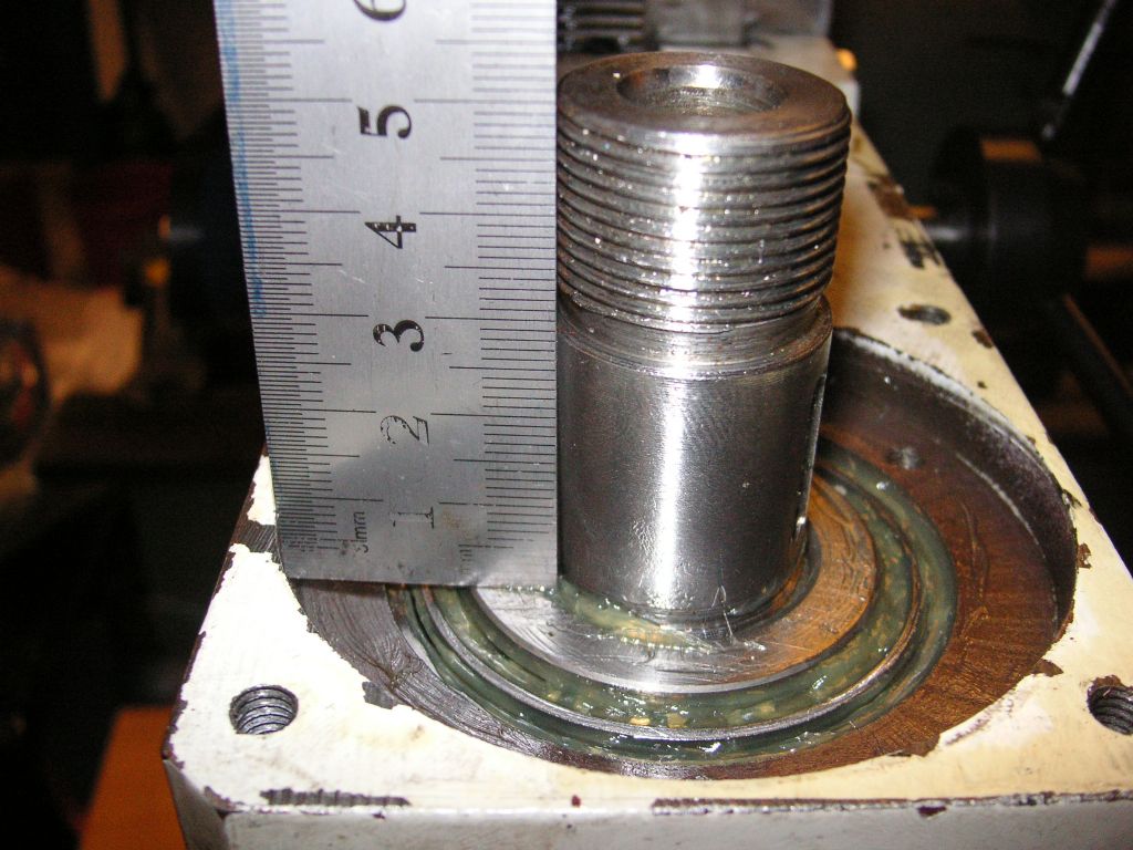

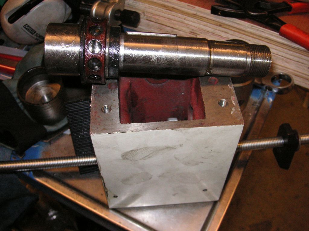

          Spindle out.
          Last ballbearing part removed.
          This is what i got for about 2 hours of work.

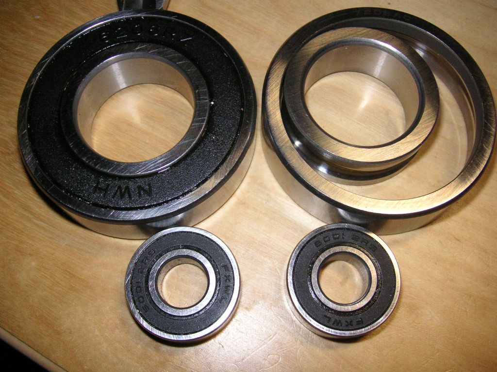

          My first reflection is that the manual say the bearings should be :
          2 pieces of 6206-RS and 2 smaller 6001-z
          But what i got was :
          6206RZ upper left on picture.
          7206AC upper right on picture.
          2 smaller 6001 2RS.
          This was what Peter G. Shaw told us in my other thread about the Minimill / X2-clone , so my question is what should i exchange this with ? I think some sort of taper roller bearing should be quite good.
          Someone else here who has already changed to taper rolling bearings and think it was good ?
          The 6001 2RS I will change to the same but of better quality, probably SKF and with one or more ceramic balls if they are not to expensive.
          For you who has not striped down minimill and think it would be a lot of work i can only say it went faster than i thought and it is easy.
          Edited By MarcuSweden on 15/04/2010 22:11:12
          #50775
          Peter G. Shaw
            @peterg-shaw75338
            Hi Marcus,
            Not necessarily in the same order that you put…
            My machine had exactly the same bearings as yours, not as in the manual.
            I haven’t looked into it, but I have a suspicion that headstock bearings for the C3 lathe may be the same – see Arc Euro Trade website. If I am correct, then I seem to recall Dave Fenner changing them (on the C3 that is) and describing it in MEW somewhere.
            Now, I notice from your photos that the bottom bearing (7206AC) has come apart during the disassembly. Mine did not, ie the complete bearing came out with the shaft. However, a friend of mine has the same mill, Warco MiniMill, and only last week had to replace his gears. Just like you, his bottom bearing came apart. Now, I am not an expert, but it doesn’t seem right to me that these bearings should come apart like this. They are, after all ball bearings and I thought that once assembled they should stay assembled. I am aware though, that on bicycles that various ball bearings do in fact dismantle quite easily, but I think these of ours are meant to be sealed. Anyway, if you do succeed in changing to taper rollers then please let us, especially me, know because when my gears next break, I will wish to change them.
            You comment on a lack of grease. This is exactly what my friend found, but I do not remember on mine.
            Stripping the machine down is reasonably easy, even without the gear puller as you have. We changed my friends gears for metal ones that I had in stock ready, and reassembled in less than one day. It’s just a case of being logical.
            Now onto the fine feed mechanism.
            Your message above leads me to suspect that you do not know how it is meant to work. Please forgive me if this is wrong.
            The finefeed knob via the long shaft turns the worm wheel inside the support block, item 159. This in turn rotates the bevel gear, item 155. This is shown in your photograph. The drive from the bevel gear is via the dog teeth onto the triple hand lever, item 154 which slides backwards and forwards along the pinion shaft item 157. The hand lever item 154 remains in either of two positions by means of a ball bearing item 149 (held by spring 150 and screw 151), there being two indentations in the end of the pinion shaft 157. Drive between the hand lever and the pinion shaft is by means of the keyway item 156.
            So, to engage fine feed, the triple hand lever is pushed in towards the headstock to engage the dogteeth. The fine feed knob thus turns the triple lever slowly. To disengage finefeed, the triple hand lever is pulled out.
            On both my mill, and my friends mill, the fine feed did not work. The manual did not even mention it, and it wasn’t until I downloaded a document from the Little Machine Shop in America that I found out how to make it work. What my friend and I discovered is that there is a gross misalignment between the the support block and the bracket adjacent to the fine feed knob such that the support block requires shimming out along its front edge (as you look at it from the front). Furthermore, the support block housing is too short for the actual worm itself, causing binding of the worm inside the block. This is cured by, in my case, adding washers between the end cover plate and the support block thus giving clearance for the worm to rotate. In addition, my friend discovered that his was seized up due to gunge.
            Regards,
            Peter
            #50868
            MarcuSweden
              @marcusweden
              Hi Peter !
              “Now, I notice from your photos that the bottom bearing (7206AC) has come apart during the disassembly.”
              The 7206AC is a angular contact ball bearing , they are “open” , a little bit like taper rolling bearing.
              “Anyway, if you do succeed in changing to taper rollers then please let us, especially me, know because when my gears next break, I will wish to change them.”
              I have ordered the following bearings which i hope will work fine :
              2x 30206 J2/Q SKF
              2x 32206 BJ/QCL7 SKF
              2x 6001 2RS SKF
              The 30206 will probably work ,  the 32206 with BJ/QCL7 surface might be a little bit to large but it is a bearing often used in small machine spindles and takes more load and is better suited so i took two of theese to to evaluate what works the best.
              Maybe the 32206 will fit as lower bearing , i think i must try and evalute becouse no one ansvered this thread telling what bearing is most suited and known to fit.
              Ofcourse I will show photos and tell how this works out, as long as anyone is intrested
              ” We changed my friends gears for metal ones that I had in stock ready, and reassembled in less than one day.”
              The smartest thing for me now when the mill is dissassembled would be to change the gears to metal ? Where can i buy them in metal ?
              “Now onto the fine feed mechanism.Your message above leads me to suspect that you do not know how it is meant to work. Please forgive me if this is wrong.”
              After reading your text and looking on the schematic of the mill i think You are right, I have not understood how it was meant to be working.
              I will continue with this issue later on when the bearing change is done and the time come for  reassembling.
              Is there a link to the file on Little Machine Shop ?
              One other thing i think of when dissassemblinbg the head gear house is that after reassembling of the head the whole mill must be set up again so that the column is 100% in line against the milling table .
              Best regards and thanks for all help.

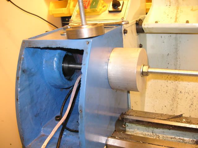

                Changing to roller bearings on the C3 type mini lathe is straightforward if you take it step by step. I wrote it up for ME a few years ago and the article has pics of my improvised pullers in it.
                Changing them in the mill should be no harder. Arc should be able to advise on the right rollers.
                The effect on the lathe was remarkable -I was able to duplicate feats of turning and parting that have been held up as examples of a well set up Myford in the past – parting tool at 2″ diameter, cuts 1/8″ or more deep. I don’t know if the mill will improve so much – I think it’s main problem is rigidity. You can greatly improve this by scraping the joint between the base and the pillar bracket. On mine it was very roughly flycut
                Edited By Stub Mandrel on 18/04/2010 21:50:33

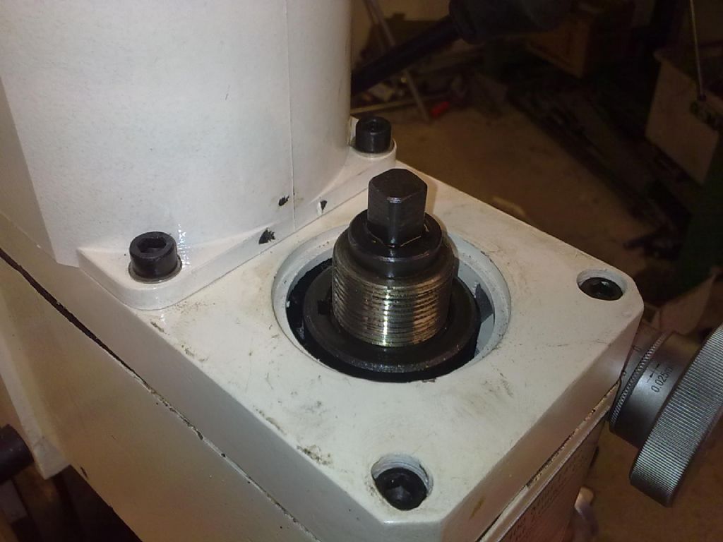

                              Today I mounted the new bearigns the postie got me some days ago , i mounted the SKF 30206 Q taper rolling bearings , they fit perfect.
                              It is possible to use the little higher 32206 Q , but then the spindle comes a few millimeters lower and the uper bearing dont get more than 70% contact with the spindle on the upside.
                              The 32206 can handle more load than 30206 but 30206 is way better than thoose bearings the mill came with from the factory.
                              It is very easy to mount 30206 bearings on the minimill / X2 clones , 30206 has the same inner and outer diameter as the factory mounted bearings.

                                This is how much is left of the spindle with the SKF 30206Q Taper roller bearings mounted.
