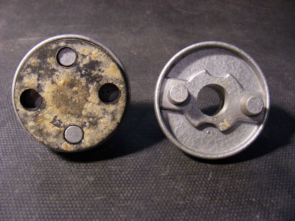

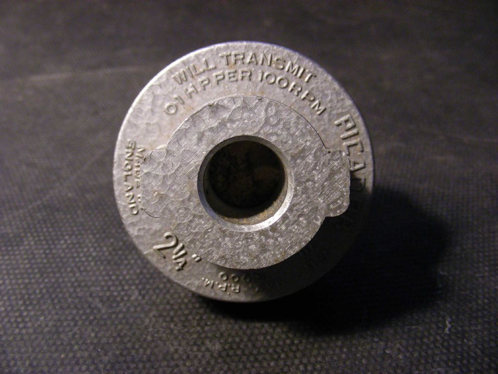

                #524528
                ega
                  @ega
                  I something like this of use?
                  It's like a dog clutch but with rubber element to take the drive and allow for minor misalignment. This one has been in stock for some time!
