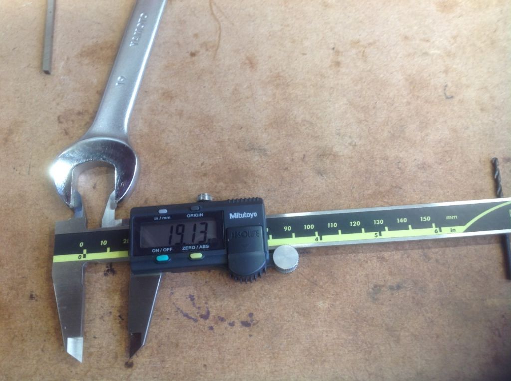

      I recently bought a new HAZET 600LG-19 combination spanner.
      The open end is a very sloppy fit on M12 19mm hex nuts. I measured it with calipers and it is 19.35mm AF. All the other 19mm spanners I own are around 0.15mm narrower than this, and a much better fit on the nuts I've used them on.
      I don't fancy using an extra long spanner, which is what this is, with this much slop on a 19mm fastener, and I plan to return the spanner to the seller.
      Before I do so, can anyone tell me what the DIN standard stipulates as the maximum permitted jaw opening on a 19mm combination spanner?
      I already have a 10mm and a 13mm in the same Hazet range, and there is no problem of the present kind with either of those.

          Seems to be pretty much nothing useful freely available on the internet.
          Best I could find was a sales catalogue from Gedore which on page 120-121 implies that the DIN 3110 tolerance on a 19 mm spanner is up to 0.3 mm oversize.
          **LINK**
          https://us.gedore.com/fileadmin/Kataloge/EN/116_151_05_Spanners_2017_EN.pdf
          Which seems a lot and almost as much oversize as your spanner.
          Interpreting a graph that is more pretty presentation than scientific Geodore claim to make theirs to no more than a touch over 0.1 mm oversize.
          I actually have a Gedore 19 mm open ended spanner and that measures 19.11 mm using a micrometer so the claim may be well founded.
          Digging deeper into my motley collection Elora and CK come out a bit under 19.2 mm whilst the various no name and lower end (Kamsa) ones are a bit over.

            Sounds wrong. Could the supplier have accidentally sent a ¾" spanner? Similar to 19mm, but slightly larger.
            #601754
            Bill Phinn
              @billphinn90025
              Thanks for the replies, Clive and Dave.
              That's useful information, Clive. It looks like the Hazet is very top-side at best.
              Dave, the spanner is from Amazon [where the others were bought from], and it is clearly marked 19 [see picture with the Draper].
              I've attached some pictures, showing four different 19mm spanners [first the Hazet, then Draper, Yamoto, Kamasa] and, for further comparison's sake, two 3/4 spanners. The Hazet, at 19.35/19.36mm, seems to be a radical outlier.

                Seems they are made by broaching so should all be constant, why not contact them and ask what the size should be, this chap seemed happy with the measurement

                  No doubt there is a tolerance on nuts so a small nut and big spanner are going to be sloppy. Where possible I prefer to use the ring end on a combination spanner for initial loosening and final tightening. A spanner that is a tight fit can be a pain to use as I have discovered when my 7/16” is hiding and I have used an 11mm. A brand new Facom measures 19.15mm and an old Kamasa 19.3mm.

                    Accoding to ISO 691, the tolerance on the jaw opening is from 19.06mm to 19.36mm. So all the spanners are actually correct but as said earlier I wouldn't be happy with the 19.36 for a brand new spanner.

                        Hi Bill, just had a measure of the open end of a few metric ones, Britool Std. combo 19.42, but this has had over 30 years of daily use plus another 15 years of not so daily use. Halfords Professional combo 19.25, about six years on and off home use. Draper Stubby combo 19.23 infrequent home use. Rolson Stubby combo with ratchet 19.26, infrequent home use. Toolzone Flexy-head combo 19.41, nearly new very infrequent home use and a Britool Long reach 19.34, 30 plus years of low moderate use. I've also measured three 3/4" ones in mm's. A Taiwan combo 19.44, unknown usage. 3/4" Torq combo 19.36, about six years old but very little usage. A Gordon Tools double open ended 19.36, moderate home use many years ago but not so much now. Personally, I wouldn't worry about using yours myself, but I would only ever put a very heavy loading on an open ended spanner of any make with a good degree of caution and like Mike Poole has suggested, I've used nuts that are smaller than others although they are designated to be of the same size. It's a pain on the other hand, when you have to fight to get a spanner on of off a nut.

                          I emailed Hazet on 14th asking what their own target range of jaw opening is for a 19mm spanner. I've not yet received any response. I'll wait till next week and if they don't reply I'll just initiate a return.

                              Thanks for your reply, Neil. Because I don't work in the Australian outback among the red dirt, or anywhere similar, I returned the Hazet. Hazet themselves haven't replied to my inquiry.
                              In place of the 19mm I bought a whole set of long spanners by Toptul, a Taiwanese manufacturer.
                              I've attached a photo showing the jaw opening of the Toptul 19mm and one of the whole set alongside the Hazet.
                              The Toptul 19mm is 347mm long, which is a shade longer than the Hazet.
