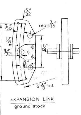

      I found the fraction / decimal option and tried re-drawing this thing – about the hardest I’ve tried in Alibre.
      I had to re-start it completely at least once, and had to make innumerable re-calculations, deletions and corrections, different attempts at single details, etc.
      Whether the ends are meant to be parallel with the slot ends or radial would not matter in practice but drawing either form, to the specified thickness, was extremely difficult.

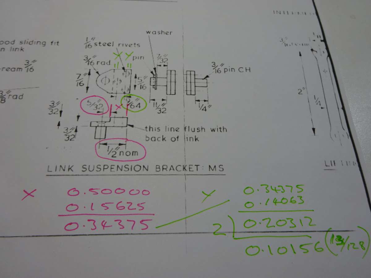

      I plotted the axis of the suspension pin then located that straight back edge 0.500″ from there.
      Eventually I had a 2D outline of the basic plate. I did not bother about rounded corners or those weeny holes of unknown size in the corners of the slot. Turning it into a 3D model meant several iterations to find and delete odd scraps of trimmed lines, and careful study of the drawing sheet to find the thickness, which is camouflaged by being on the drawing of the die-block.
      Finally I tried to put those three rivet holes in it. I wanted to work these out myself, but where do I start?
      Harris’ drawing omits to tell us, and I could not work them out. So I re-plotted the pin centre and put a circle on it, so I could plot that little step in the bracket to create a bounding rectangle for the rivets to live in by what looked about right.
      It struck me that having to draw each of the bracket and the plate as separate Parts risks them not fitting together thanks to dimension errors in drawing their shared details, twice.
      Only the pin was now visibly in the wrong place and I have no idea what I did wrong where.
      Oh for Heaven’s sake! Start yet again…..
      …… I closed the thing down instead.
      It had taken me well over an hour to produce a faulty version of what anyone else would probably knock off all-correct in ten minutes.

        Three rivit holes
        Picture shows how I worked out their spacing. Take the 5/32″ notch away from the 1/2″. Take the 9/64″away from that result and then divide that answer by 2 to get equal material either side of the group of 3. Harris may not put it on a plate and give that exact dimension but with a bit of common sense there is enough info to work it out.
        Same maths can be done in your head if you start with 32/64 – 10/64 = 22/64.  Then 22/64-9/64 = 13/63. Then 13/64 divided by 2 = 13/128 or 0.10156

          Because so much of the part relates to the centre line of that slot, I’d be tempted to produce an initial sketch which has perhaps just that, as a reference (dashed / construction) arc.  I would then close that sketch.
          You can ‘project to sketch’ this existing sketch into any new sketch within the part , and if you select ‘maintain association to source’ the copy will update if you alter the original.   This allows you to easily re-use the centre line arc in as many new sketches as you need to.  You could extend this idea to also include other key construction lines in a ‘master sketch’.
          There are many different ways to produce the needed profile.  In addition to Jason’s comments you could also
          • set end line of slot perpendicular to the reference arc centre line.
          • use ‘offset’ from the centreline arc to produce curved edges of slot.
          I’d also suggest – don’t do corner rounds inside sketches, instead use the Fillet tool.  This leaves your sketches easier to edit if you need to go back and make changes, it’s also much easier to ‘try’ different fillet sizes to see what ‘looks right’, if the size is not specified.
          Generally keep sketches simple – it isn’t necessary to put the entire profile into a single sketch (in fact that’s often far more difficult).  Four or five very simple sketch/feature pairs is preferred to a single complex sketch with single feature.  If you do make a mistake, simple sketches are much easier to repair, and of less consequence if you do decide to delete a sketch and start again.
          Responsiveness of the software will also be better if sketches are simple.
          Think of these as guidance rather than rules, you will come across exceptions.

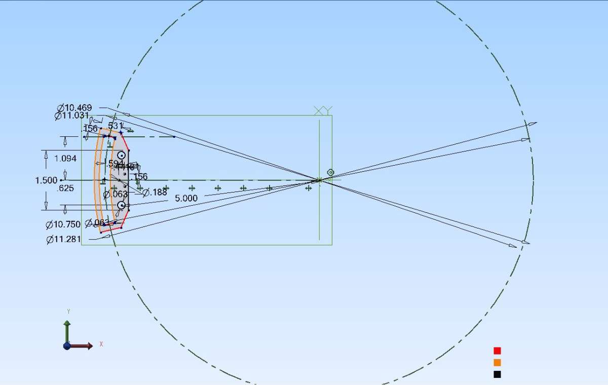

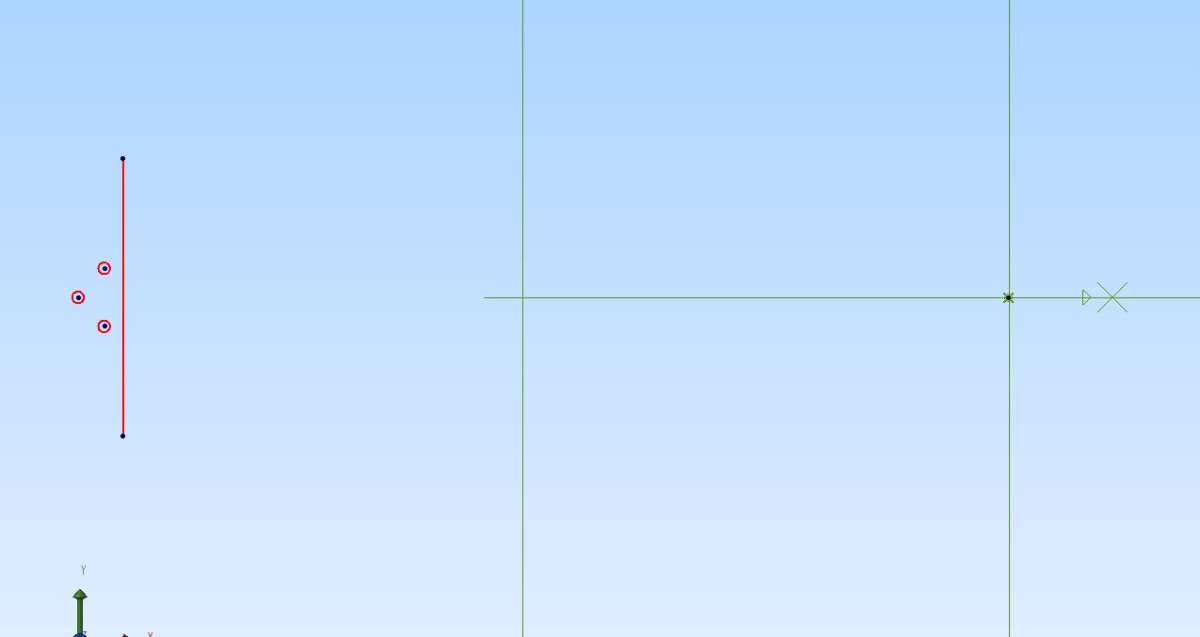

              As David says the first part of constructing that link that I did was place a ref circle to represent the ctr line of the slot and that also gives the springing point of all the other radii and the radial edges even if it is outside the part (Sorry Martin)
              I do usually add holes as a separtate sketch particularly as Pro has some different ways of dealing with holes but put them all on the one sketch to save having to post multiple screen shots. Fillets are separate at the end.
              guide circle
              This is how I started my sketch for the block, I picked up the three rivit holes and the back edge of the link and copied them. Opened up a new part and pasted them onto the sketch plane. Not only are they already positioned but I still have that springing point as the intersection of my axis.
              block start
              From there I added the pin hole, one of the lines at 7/32 and mirrored that to get the edges, 3/8″ circle to then have tangental lines added before trimming leaving the 3/16″ radius end.
              Sketch then extruded 3/16 about mid plane. Then select another plane and draw a rectangle for the notch snaped to ctr line an ddimensioned 5/32 from pin (other lengths not critical) and cut extrude that to form teh notch
              Lastly chamfer inner edge of pin hole for peining over the pin’s spigot.

                    Just as a small aside: I have [to satisfy my own curiosity] been ‘constructing’ that plate in 2D from the given dimensions, and noticed that the 5/32” dimension is not adequately defined … it matters ‘not a jot’ in reality but this may be sufficient to upset Alibre … is the 5/32” a linear offset, or the arc-length ?
                    [technically, it cannot be both!]

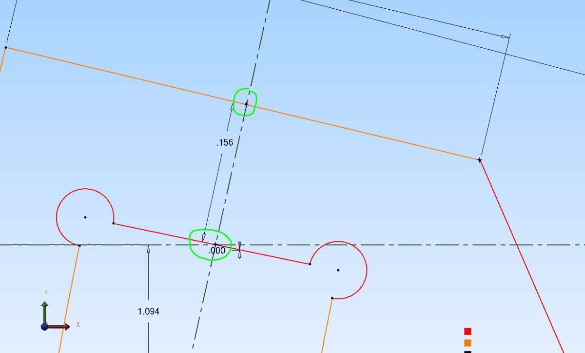

                      I actually placed the slot ends and the 5/32″ thickness by adding a couple of Nodes on the slot ctr line and the appropriate distance along it. The radial lines can then be drawn from datum to node and then extended out to the required arc. Many ways to skin a cat, you just have to get to know the cat.

                        Michael,  the 5/32″ will be a linear offset.  Mainly because there isn’t a dimension option to directly set an arc length.
                        It is possible to set an arc length (though not obvious) by using some basic maths in the inbuilt equation editor.

                            It is hard to tell if the shorter arrow next to the 5/32″ dimension is straight which would indicate an offset or if it is a curve which is more likely to represent an ARC length. My dimension is a straight line between the two points.
                            For those with a curious mind the arc length between my two nodes which are spaced at 0.15625″ is 0.157328″ a difference of 0.001078″ I’d be happy if I could file to that given the thickness of a scribed line.

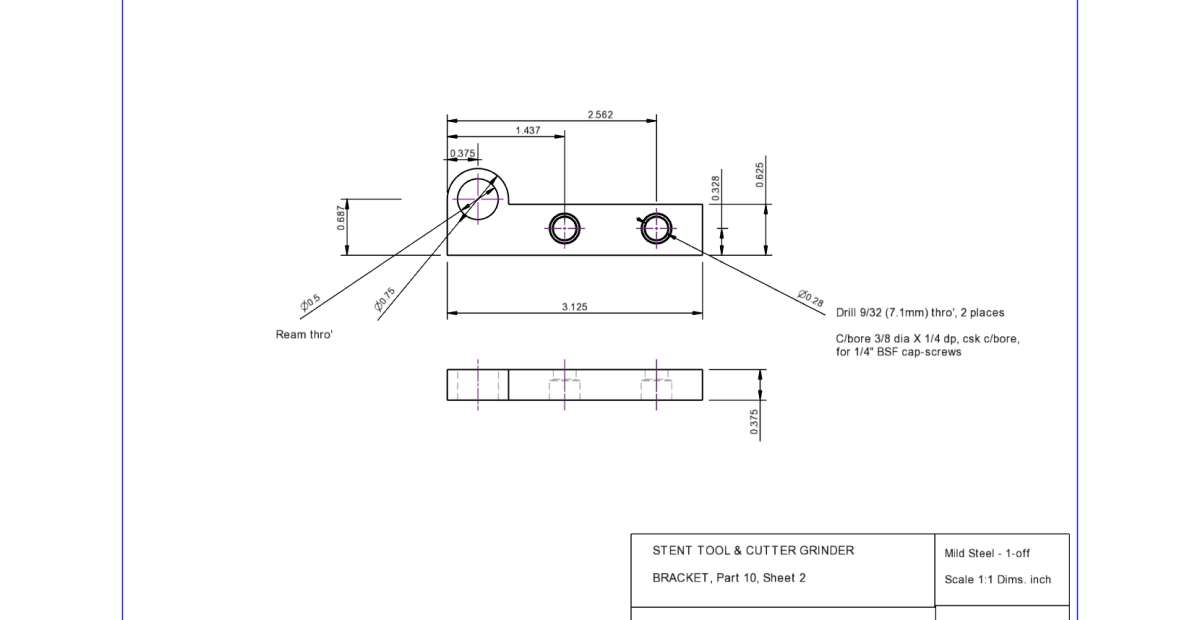

                                      It certainly wasn’t at all obvious. I couldn’t make it work even by just drawing a short line not joined to anything.
                                      It does not matter from a purely mechanical point of view, so if it needs a rotary-table to make much of the rest, the ends can be radial too.
                                      They’d hardly be noticeable. What matters more is why I could not make a particular CAD move work, rather than what it is for, since some other application might need lines to be parallel.
                                      I take it that the order does matter then. In many of my attempts the wrong line would move.
                                      To regain some sanity I copied a far simpler drawing, part of the Stent T&C Grinder. The peculiar thing here was that it was drawn upside-down originally, making the two countersinks (I changed them to counterbores) hidden details. I had think hard which way round it goes, to draw it the right way up, helped by the part-assembled project standing next to the computer. It was of course also chain-dimensioned, and in vulgar fractions.

                                        Yes – selection order does matter for applying sketch constraints.
                                        If neither line is fully fixed, the second one selected will move to be parallel with the first one selected.
                                        If one line is fully fixed, it will be the other one that moves.
                                        So the first selected figure becomes the ‘driving’ one, unless pre-existing constraints or dimensions prevent it.
