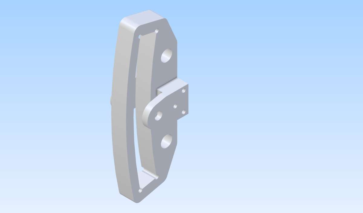

                        I have just closed Alibre from trying to re-draw it afresh – I found incorrigible mistakes in my original.
                        Gave up.
                        I am trying to adapt a published design so it might seem easy (ish) to create a copy in decimals rather than thirty-twoths and sixty-fourths.
                        How does anyone make successful engines from drawings so poorly dimensioned? Perhaps when it comes to valve-gear near enough is good enough!
                        This is a launch-type link for Stephenson’s Link Motion, so suspended from a pair of trunnions whose pins have to be centred at a definite distance from the link centre-line, and exactly in line with each other.
                        Each trunnion is a pins in a plate rivetted to the link and its companion via three holes dimensioned only unto themselves, not to the plate edges.
                        Are the rivet holes shown by dimensioned locations in the link itself? No. The drawing shows the full assembly.
                        The critical pin location is 3/32″ from fresh air –  the centre of a slot in a separate piece of steel – and by ” 1/2″ nom. ” from the back of the trunnion . What???
                        Where is the back edge of the trunnion? It is marked, ” … flush with back of link”.
                        Where is the back of the link? That 3/32″ + nominal half-inch from the link centre-line.
                        So three pieces of steel until assembled, but dimensioned from each other.
                        The inner face of the trunnion plate has a step in it. Dimensioned from? The pin centre.
                        I thought this is meant to be a precision machine.
                        So I need re-calculate a lot of back-and-forth dimensions in vulgar-fractions across two components to work out just where everything really is. Then calculate completely where to drill the three rivet holes in each of the three pieces of steel.
                        In theory one can make all five parts of the complete link individually, to better than 0.005″ of the given dimensions where those matter, assemble without having to spot through holes or drill them over-size or such like antics, and so they will work properly in the engine.
                        That needs using the machine-tools to their potentially most accurate but also most efficient advantage.
                        Hence needing a new drawing dimensioned properly, but I think that’s too hard for me in CAD.
                        I will have to photocopy or trace the drawing and use a calculator and pencil to re-dimension that.

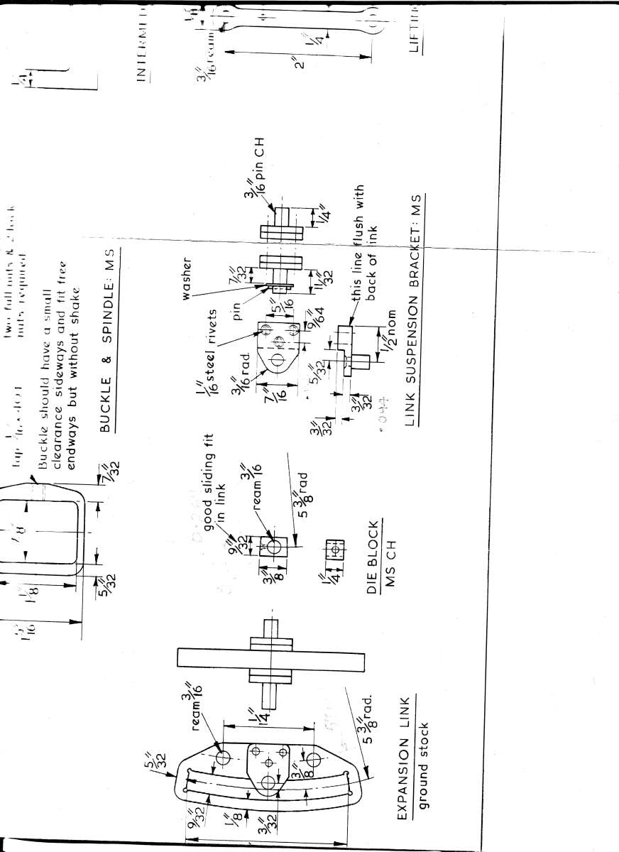

                                  Thank you – I didn’t know you can enter fractional dimensions – it’s decimals I need for machining.
                                  (I am surprised so many model designs stick to specifying fractions even for turned components.)
                                  The problem with this link assembly is not that the original drawing is dimensioned in fractions. I can just look them up on a Tracy Tools poster-size conversion-chart kept near the computer (with another in the workshop).
                                  The confusion is from the way the parts are dimensioned, needing a lot of awkward arithmetic to work them out. Using words like “nom” on components that have to be placed accurately does not help. Nor does the holes for their fasteners being dimensioned from each other, not a datum edge.
                                  It is possible to work out the more obscure dimensions
                                  To me, the only way to dimension this thing is from the radii centre, the distance from that centre to the back edge, and a secondary datum given by the intersection of the back edge and horizontal centre-line. The two trunnions then follow that second datum but are dimensioned fully from that, so although you make the three parts separately they should still all fit together, assuming sufficiently close tolerances you’d need determine for yourself.
                                  (You could work out polar co-ordinates for the rivet holes in the link itself too, but this does complicate matters.)
                                  The copy is here. The dimension that has fallen off the edge is 2-3/16″. It is over a fold in an oddly-folded sheet I did not want to risk damaging by creasing it even further!
                                  Examining the rough GA I have for the steam-wagon engine, suggests a true Launch link – as on a traction-engine – would fit and be a lot simpler to make but would need other parts re-designing.
                                  Orig Expansion Link Drg

                                    The only critical dimension is that the pins on the small side plates end up 3/32″ from the centre line of the expansion link’s curved slot so the back edge and position of the rivits is not critical hence the “nominal” edge distance and no actual positioning sizes for the three rivit holes.

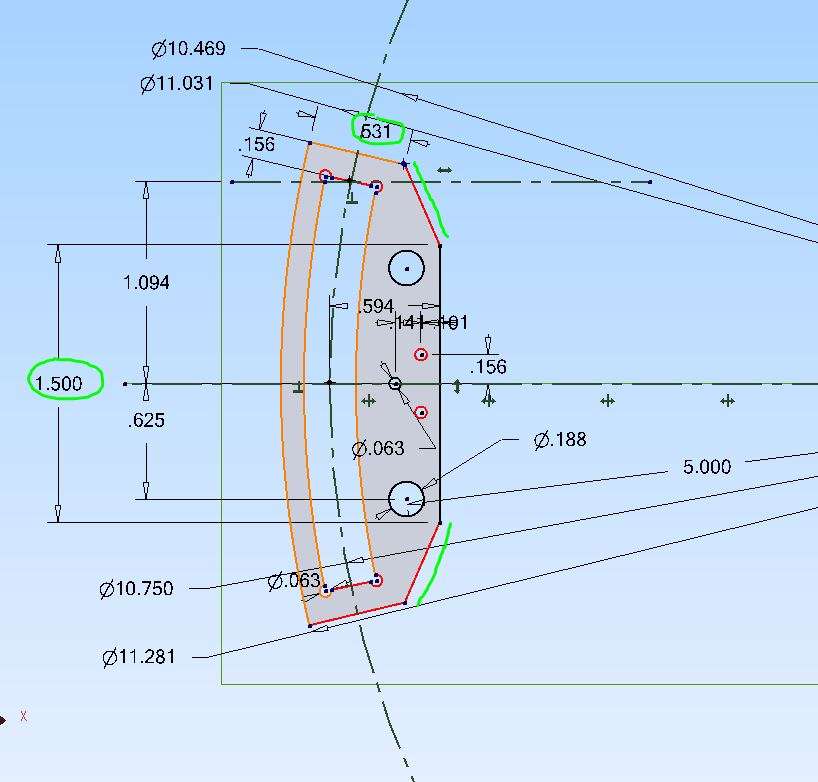

                                        What David says, enter the dimensions as fractions, you can also add offsets, etc. Here the slot’s central dia has had the slot width added to diameter which gives the correct offset
                                        dim1
                                        Then when you click the green tick it shows as a decimal on your sketch
                                        dim2
                                        All seems doable from the given drawing, only exception are the two angled edges from the vertical inner edge of the link to the ends and the radii of the corner rounding neither are critical. 3 rivit hole sand the vertical back edge were copied and used to construct the small blocks.
                                        n link original
                                        sketch dims

                                              I had no problem tying down the “Floaters” As I said the only exceptions were the non critical edges marked in green on my last image for which I put in the two ringed dimensions.
                                              The three rivit holes are not particularly critical but still easy enough to place even if it says 1/2″ nominal rather than 0.500″. You can work out their positions from what is given with a bit of common sense thrown in and end up with 13/128″ as what is needed. The use of “Nominal” is only there as the back edge of the link is not critical, it is the position of the pin and it’s hole in the side brackets that matters.

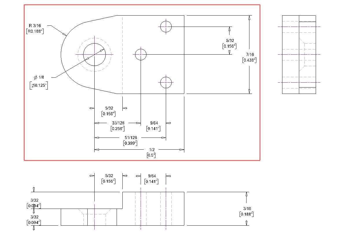

                                                  You can dimension the brackets taking the pin as the datum as that is the critical part not the back edge.
                                                  Here I have set it up to display duel dimensions with fractions as primary to 128ths and secondary as decimal to 3 places.
                                                  bracket dims

                                                    Nicely done, Jason
                                                    #724749
                                                      Thanks, It is not a feature I personally like as it can make a drawing look rather cluttered but worth it to show Nigel what can be done and it can have the odd use. I would rather do the drawing with fractions and then save a copy with a new name and just alter what is displayed to decimal and send out or print one of each.
