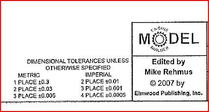

                                        If you want teh same sort of thing for Imperial then this is whats printed on all the drawings that come with Model Engine Builder mag.
                                        They also note on the drawings what holes should be reamed.
                                        I do have some ME drawings that Show H & h tolerances and also the surface finish by a series of VVV marks, most of which are of German orgin.
