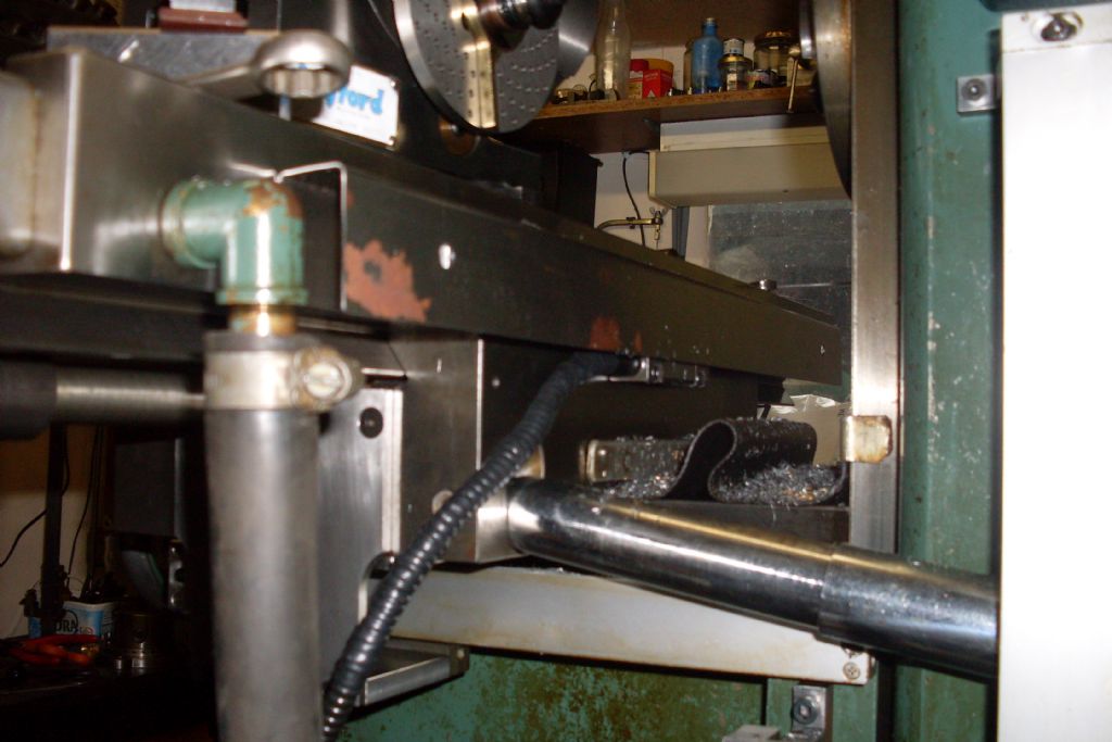

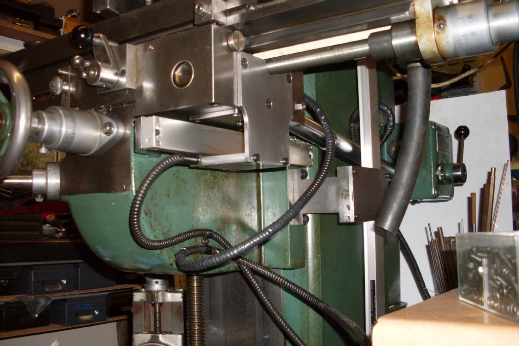

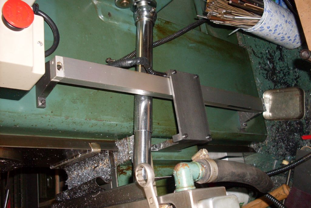

              I have retrofitted a digital readout to my senior mill and have included photo’s showing what i have done.  The Z and Y are obvious but the X isn’t.  The scale is attached to the table and the sensor attached to the saddle with a steel cover over them to protect them from oil/swarf etc.  The scale required packing out slightly as the saddle sticks out under the table.  It works very well and i only lost 1/2″ of travel in the Y.  Everything is nice and beefy.  Hope this helps.
