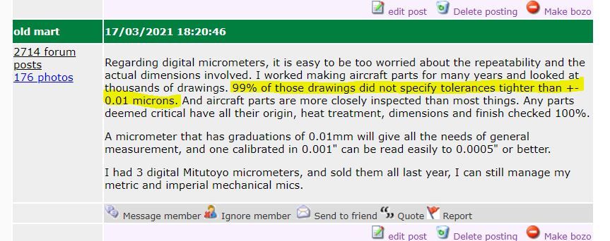

          Posted by old mart on 17/03/2021 18:20:46:
          99% of those drawings did not specify tolerances tighter than +- 0.01 microns. […]
          I would confidently presume that 100% of them did not specify tolerances tighter than +- 0.01 microns.
          I work [O.K. I play] a lot with microscopes, and 0.01 microns is very small indeed !
          Would it be reasonable to guess that you meant +/- 0.01 mm [i.e. +/- 10 microns] ?
          I thought I had produced another of my typo's, but looking at my post, it says 0.01mm.  Now I see that the size was down twice, of course I meant 0.01mm both times.
          Mitutoyo make a digital micrometer that measures down to 0.0001mm, seems rather difficult to ever get the same reading twice with one of those.
          Edited By old mart on 17/03/2021 20:45:35

            Michael quoted what you typed, suggest a trip to Specsavers is in orderwink 2
            Edited By JasonB on 17/03/2021 20:46:07
