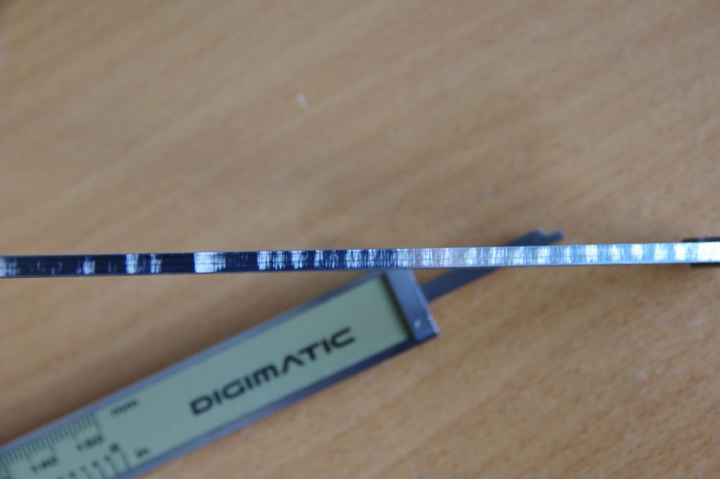

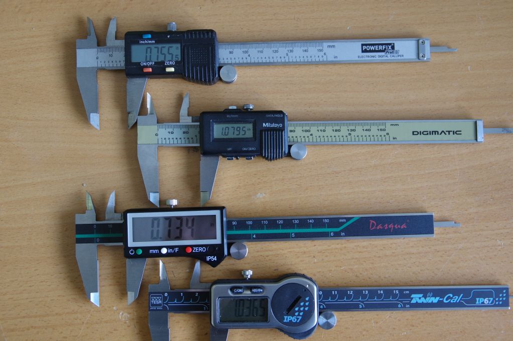

        imgp1070.jpgTrying to span two threads at once, the Lidl Powerfix and the earlier Dasqua one, I have some photos of the last Powerfix that I bought in the last 2 years, the Tesa, the Mitutoyo, and the brand new Dasqua. The Mitutoyo is 33 years old and has recently developed electrical problems making it somewhat unreliable. I have dismantled the board and gently lubricated every contact with Servisol switch cleaning lubricant, there are about 40 very delicate spring contacts, plus the switches, but have not entirely fixed the unreliability. This resulted in my buying the Tesa which is of comparable quality, but not a cheap instrument. The earlier Powerfix digital calipers were much better mechanically, smoother running than the most recent. I have swapped the reading heads between the recent one and the oldest to get the absolute reading option. One of the pictures shows the poor finish on the slideways on my latest Powerfix.
        The Dasqua cost £31, but is much better finished and smoother than the Powerfix, comparable to the high end calipers, it came with a test certificate, serialised and two 2032 button cells, is IP54 protected and the box is excellent, and what will be of interest to older people is the very large display, including fractions, and the digits are 14mm high. I think it is worth the money.

          That Dasqua looks a very good buy yes

            I read the Dasqua thread before deciding to get one from RDG. I am very pleased with the calipers, 1/3 of the price I paid for the Tesa. They will be my best calipers at the museum. The Mitotoyo's would get a replacement reading head if I could find one to fit. The head would probably have a smaller cell, the current 2032 size heads will not interchange.
             I looked at the link in your post, Michael,  and the ones that RDG are selling are not quite the same model.
