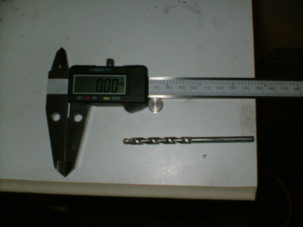

      Got my 12incher and it's a solid lump, I don't fancy drilling those stainless jaws…
      The scale was a bit jumpy though, not as good as the smaller ones so I took it to bits, yanked out the depth gauge and put it back together
      Fine and steady now for 0.01 repeatability which is at least 20-50 times better than I could ever manage with the dials and backlash trubbles
      If you dismantle a cheapo for the first time a bent copper strip will drop out
      To reassemble find the hole at the end of the strip and fit that onto the tiny pin inside the vernier casing with the bulge part facing towards the moving slide, then re-insert the slide

                    That's the jaws drilled
                    Sharpened up an old 6mm carbide tipped masonry drill and put it into my collet chuck and it went through that stainless like butter (use intermittent stops to stop the tip overheating)
                    Moral of this story is the same as with milling, use a collet chuck and tough jobs are a doddle
