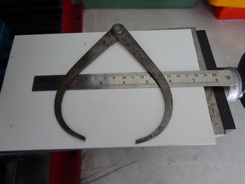

        That's not a proper caliper, you want one of thesewink 2
        Yes I do prefer my depth mic to the digital one, comes down to feel in use also helped that I got a nice Lufkin one 0-3" in exchange for a bit of 5mm steel plate from Jo, fiver well spent.
        Also sounds like I will have to give up making these glow, diesel and flame licker engines with their close fitting pistons as I only have a Far Eastern machine, should not have sold the Emco to make way for itdevil

            Jason Yes that is what I mean by a caliper. Roy

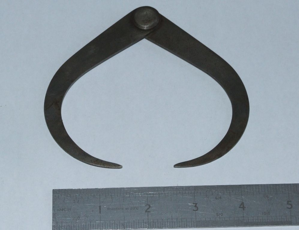

                  Any questions?

                    Just one… have you had them calibrated?

                      How did our predecessors manage with those, a pair of oddlegs, pair of dividers and not a lot more?
                      I can't remember the last time I used mine on metal, probably when I was making a Stuart 10V in my teens, I do still use them for wood turning though. The oddlegs and dividers do still see use on metal.

                              No. There's no manufacturer identification on them. So I suspect they were probably made by my father as part of his apprenticeship. So they will have been assessed.

                                As has been said they tended to work to much looser tolerances. If accuracy was required then much work with files and emery cloth ensued, which is time consuming. Not to say I haven't resorted to same embarrassed but it's not something I want to do on a regular basis.

                                  That was an attempt a humour… how would you calibrate a plain caliper?

                                    well you could tighten the nut….🧐

                                      Lock it within a couple of thousandths, then carefully stone the ends to fit the sample you wish to duplicate.
