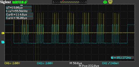

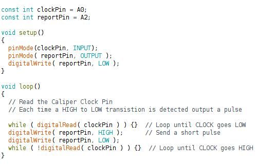

                    Another progress report. Yesterday was another baffling waste of time. Despite careful checks of the program and wiring, and trying different ideas, I finished the day still getting incomprehensible readings off the caliper. I went to bed thinking 'very strange' and decided to start again this morning from first principles. Alas, if only I'd done that first! Or taken any notice of the clues!
                    I wrote a simple program this morning to prove that the Arduino was catching the pulses sent by the caliper. It looks like this:

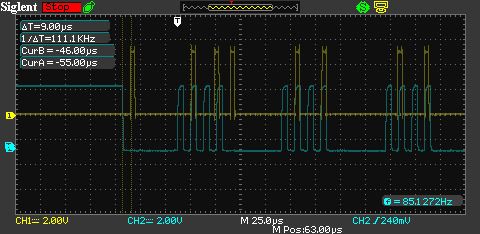

                    The oscilloscope output from the program reveals a big problem:
                    There should be a yellow pulse each time the blue line drops. It can be seen that I got 1,3,2 and 2 yellow pulses rather than 1,4,4,4. Also it can be seen that the first yellow pulse doesn't appear until 9μS after the blue drop that triggered it. The root cause of this failure lies in the speed my particular caliper sends data. Roughly 3 times a second, it sends a frame containing 7 bursts of 4 bits. The whole frame is sent in 780μS and the all important blue pulses are only 6μS long.
                    The problem is that the Arduino digitalRead() function takes about 5μS to do its stuff. As the pulse it's trying to read is only 6μS long, there's a good chance that pulses will be missed. And they are!

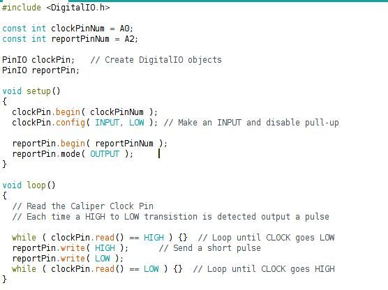

                    The good news is that the problem can be circumvented I hope. Turns out that digitalRead() is slow because it hides a lot of complexity from the programmer. 5μS is fast enough for most purposes and the function keeps life simple. However, there are faster alternatives, which is what I need.
                    In general the alternatives to digitalRead are much harder to understand. Assembler, Macros, Bit Twiddling and other advanced under the bonnet stuff. However I've found a library called DigitalIO that looks like a good compromise. Provided the programmer guarantees not to change pin numbers at compile time, PinIO is much faster than digitalRead().
                    The revised program looks like this:
                    Running the PinIO version shows that it's fast enough to keep up with the caliper:
                    The moral of the story is not to make assumptions. As Bob's caliper is somewhat similar to mine, I assumed that tweaking his logic would work. I also assumed that the Arduino would easily be fast enough to keep up with my caliper. There's nothing wrong with Bob's logic, but using digitalRead() makes it too slow for the protocol used by my Powerfix caliper. No wonder I couldn't understand why nothing I tried worked! Arghh!
                    I've high hopes that my next report will be success. Don't bet the farm on it though, I keep underestimating this problem. It ain't over until the fat lady sings.

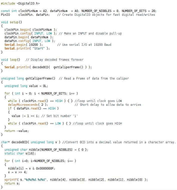

                        I made much better progress today and can now display caliper values correctly! That fat lady isn't singing though. My sketch loses the most significant digit on readings above 99.99 and can't detect negatives. Sounds like a small bug but I fear it's a nasty one. As the sketch goes wrong reading bits late in the frame I infer the timing is drifting off so that data reads half way through the frame are mistimed. Close but no coconut.
                        This is what the code looks like now:
                        Just as well I'm busy this weekend. I need to sleep on it.
                        #311973
                          Just to finish this one off, in case anyone needs such a thing I've put two working Arduino sketches for decoding a BCD7 caliper in this Dropbox folder.
                          caliper_int.ino captures data from the caliper with interrupts generated by the caliper's clock signal. This code is can easily be extended to read more than one axis. (An Arduino Uno has two external interrupt pins, enough for X and Y. If Z (or more) measurements are needed, the easiest solution is to change to an Arduino Mega because it supports 6 external interrupts. )
                          caliper_bob_mcN.ino captures data from the caliper by waiting in a loop until the clock changes. It's based on Bob's program, altered to decode BCD7 protocol.
                          I made a mistake about why 'My sketch loses the most significant digit on readings above 99.99 and can't detect negatives.' Not a timing error as I thought. C programmers will enjoy my discomfort. It was due to writing:
                          value |= 1 << i;
                          when, because value is a long integer, I should have said:
                          value |= 1L << i;
                          Subtle eh. Most C/C++ compilers issue a Warning, the Arduino IDE doesn't. Not sure why not!

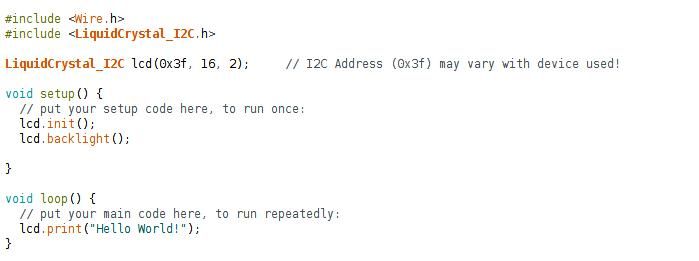

                              Hi Ian,
                              Generalising a bit the main difference between a Nano and a Uno is the size of the board and the way the pins are organised.
                              Here's a pin-out diagram for the Nano. A bit intimidating but the most useful information is the lettering running vertically on the board itself D12 to TX1 on the left, D13 to Vin on the right. They're what you connect to.
                              The Nano uses pins A4 and A5 for I2C. A4 is SDA, A5 is SCL. To connect an I2C device, you link GND to GND, 5V to 5V, SDA to SDA and SCL to SCL.
                              Once the Nano and I2C are connected, plug the Nano into a computer with a USB cable. The computer will power the Nano and display.
                              To program the Arduino, download the IDE from here. Fire it up and use the Tools tab to set the Board type to Arduino Nano. Then use the Tools Tab to confirm that the Port is set correctly. (May not get the port right automatically.)
                              Assuming you have a new sketch rather than are modifying an existing one, use the Sketch Tab to select Include Library. Include Library should give you a list with 'Wire' in it. Select it. #include should appear in your source file.
                              Under the File Tab find and open the Examples list. In the 'Examples from Libraries' section you should see a few example sketches showing how to use I2C in the raw. These may be useful later.
                              But if all you want to do with I2C is drive an LCD display, then there's a contributed library called LiquidCrystalI2C. It too can be found and loaded from the Sketch tab.
                              Next is an example of a minimalist 'hello world' program.
                              In the IDE, type it in, then Verify and Upload using the tick and right arrow buttons. There will be several Warning Messages, but no Errors.
                              If the display doesn't work, and the wiring is OK, the declaration 'LiquidCrystal_I2C lcd( 0x3f, 16, 2 ) is chief suspect. The 16 and 2 must match the number of columns and rows your display has. 16×2 is the most common but you may have bought bigger.
                              The most likely culprit is the 0x3f. It's the address of the I2C hardware and it varies depending on the whim of the supplier, who doesn't always provide documentation. 0x27 and 0x3f are common but other addresses pop up from time to time. If neither work, I provided a link earlier in this thread to a sketch that scans an I2C device and tells you whatever address is being used.
                              Have fun!
