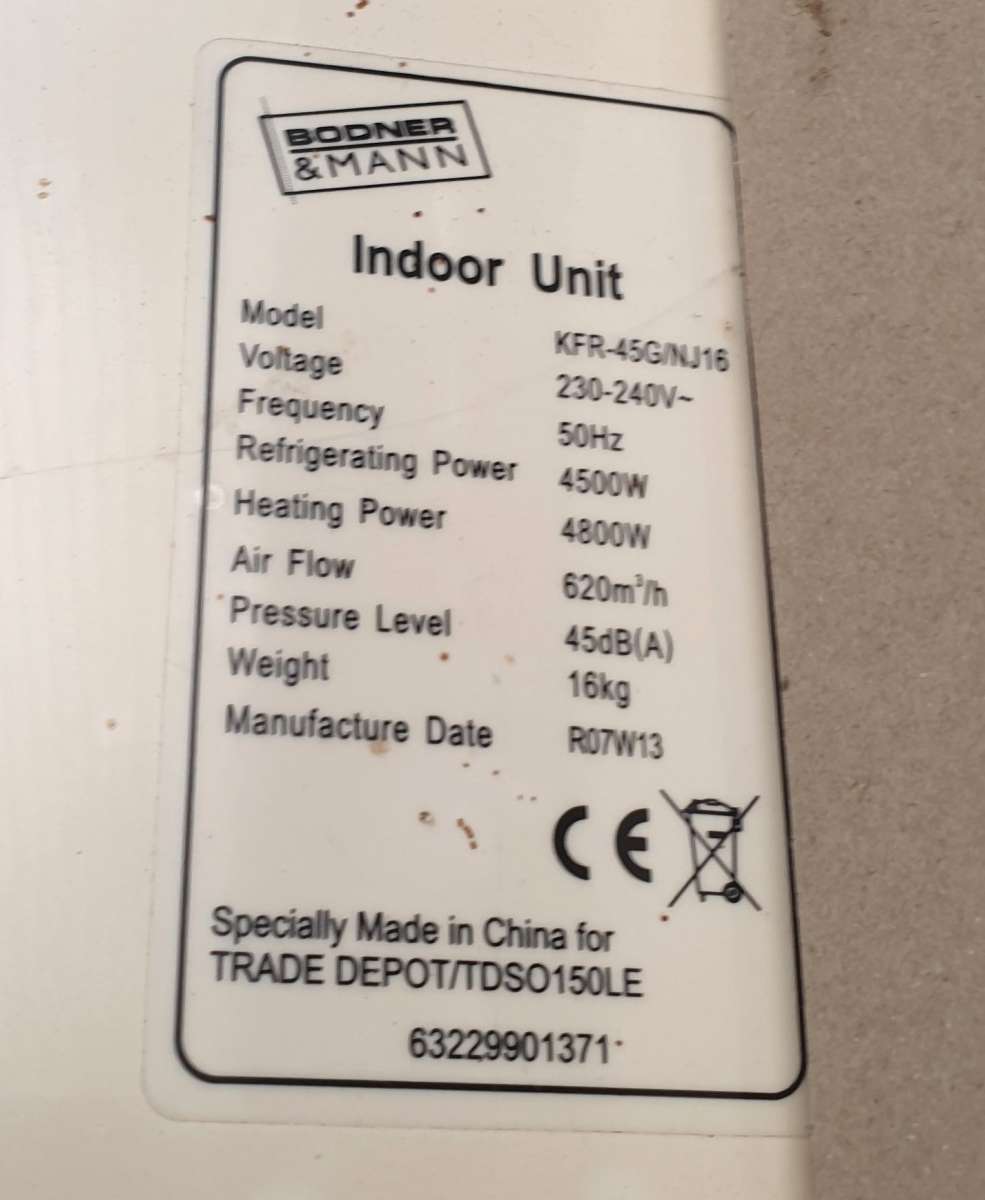

        mark smith 20
          @marksmith20
          Heres the spec label on the indoor wall unit .
          20241121_101621

                Bazyle what do you mean by small self contained? Single indoor unit types like a large dehumidifier or split like what imtalking about with a large fan unit outside ?
                Just switched mine back on to test and still working perfectly after over a decade ,despite being made in China.
                How does the dehumidifier part work on split con? Does the water go out through the indoor unit and down the pipe that goes to the drain. Im not any sort of expert on these ,just bought one and have been impressed  with it.
                For instance just put mine on set at 20 c and within a couple of minutes its gone from near freezing to comfortable to work in.
                Heres a couple of photos of the remote and the indoor unit which is around 5 ft above my southbend lathe. The remote is easy to use as well. Mine just plugs straight into a normal indoor 13A extension lead . Hardest part of installing it was cutting through the conservatory dwarf walls with the hole saw and getting the rather stiffflexible copper pipe (around 4metres long  as neat as possible and through the wall to the outside unit.The grey plastic pipe goesto the drain so iassumethats for condensate.
                20241121_114050
                20241121_113743
                20241121_113753
