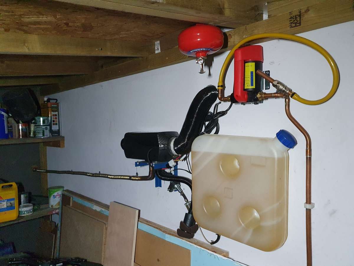

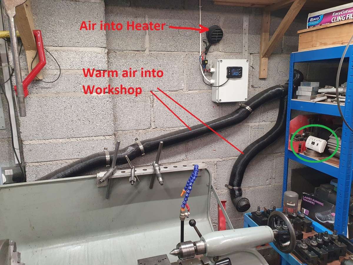

                              I thought I’d let you know what I have and why.
                              I suffered terribly with corrosion in the workshop for a few reasons. I live on a peninsula surrounded on 3 sides by the sea, very close by. We get some pretty horrendous weather from the southwest and the render on the south and west walls of my workshop had cracked terribly (dried out too quick when building I reckon) although it was bonded soundly to the wall the inside of the walls (single leaf blockwork) it was physically wet to the touch. It also had an uninsulated pitch roof although the main garage door was an insulated sectional door.
                              I harshly jet washed off the 2 walls, tanked them with an SBR slurry mix then painted them with Bedec paint (the elastic stuff), it’s dam good! I got hold of a load of 50mm celotex and insulated the roof leaving a decent air gap to the membrane making sure there were no gaps, sticking it in with a little expanding foam and tape bonding all the joints.
                              Once all that ‘orribleness had been sorted the walls began to dry out (funnily enough!) and I bought a Chinese diesel heaters for £79.95 + about 15 quid’s worth of ducting. I believe it was listed as a 5 – 8kw. 5 is a stretch, and I don’t even think the maths of fuel used etc even remotely add up for it to possibly be an 8kw.
                              I’ve got a lean to shed on the north side of my workshop so the heater is installed on the external side of the workshop wall but in the shed. It draws air in from the upper area of the workshop and puts it back in lower down. Combustion air is drawn in from where it is in the shed and exhaust out through a long stainless ‘flexi’ through a stainless gland in the shed wall. The added bonus of that is the exhaust keeps all the stuff (gardening etc) in the shed nice and dry!
                              It runs off a small 12v power supply on the wall in the workshop, I have a CO monitor near by just in case.
                              I run it on domestic heating oil as that’s what we have for the house which comes in at around 70 odd pence a litre. I’ve run a line from the tank into the lean to shed to a small pump to fill the tank.
                              Workshop_Heater_1
                              Workshop_Heater_2
                              I know the fire extinguisher is probably woefully inadequate but it’s better than nowt!
                              When it’s reasonably cold I just run it over night for around 12 hours but when it gets proper cold outside I leave it on 24/7 on lowest setting. That uses around 2.7L in 24 hours. last winter I left it on for over 3 months and the temp in the workshop was really comfortable, didn’t measure it properly but the controller said it was around 16 deg even when 0 or below outside.
                              Not the cheapest to run but for what it does it’s more than worth it and so far it’s been faultless although the main fan motor is starting to get a little noisier than it was (barely noticeable but it’s a slightly different noise) but a replacement is about £12- £14 delivered.
                              One of the best things I’ve bought for the workshop and I haven’t had to treat any of my tooling or equipment for corrosion since, normal use and handling is enough. No condensation on any of the kit etc.

                                        You need a guard over that exhaust in the shed. If something is lent against it or falls onto it there will be a fire. If the wall surface is not fireproof there should be a metallc heat shield between it and the exhaust as well.

                                          Robert has a very good point ! The exhaust does get VERY hot, will melt plastic and char wood. Noel.

                                              Robert, yes, head down and tail between legs. A mesh guard is on the to do list (I was supposed to do it in the summer). I did lag it but the lagging I had was a waste of time. It will get done as soon as I can get hold of some reasonable mesh.
