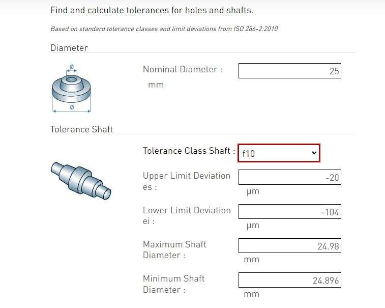

            The f10 for precision dies works out as this which is under nominal
            f10
            Regarding not expanding dies, page 271 of Dormer threading pdf applies. Also note that the do more unspilt dies than split ones so you can’t adjust them anyway.

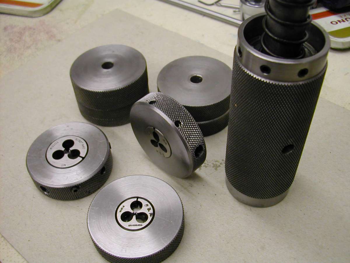

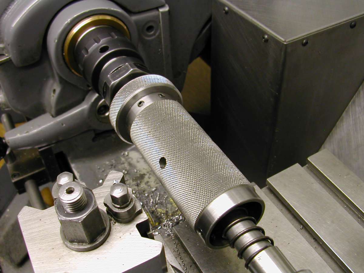

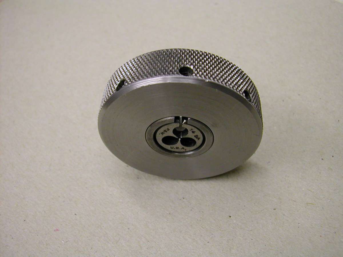

                    I wrote about this many years ago when I first experienced the same issue. I had made a carefully turned tailstock die holder that the dies fitted in to prevent the exact issue that Jason raises. I very quickly realised that A, the tolerance on the die to allow expansion was too tight but on relieving the bores to alleviate that soon realised that B the die was now off centre. I have been somewhat perplexed ever since how a tailstock die holder can actually indeed be used with expanding dies 🙄
                    My solution at the time and one I still use to this day was to make several die holders of circular shape of around 60mm-21/2 diameter and about 5/8 thick with a knurled outside. These were bored to fit the various die diameters with sufficient tolerance to allow expansion. The conventional tailstock die holder as intended was made redundant at an instant but was pressed into further service by fitting a spring behind it and using it to apply pressure to the die holders which by that nature can now float. I have no idea how many threads I have cut using this over the years but must be in the high hundreds if not more. For most BA sizes the die holders are held by hand but it gets a bit of a strain up toward 1/4 diameter so there are tommy bar holes drilled in the periphery to help at this stage. The only factor that is critical is to ensure the back face of the holder is in the same plane as the back face of the die holder bore – I did mine by holding them on a mandrel
                    I’ve never seen it described other than my original text which is so long ago now I have no idea where that was.
                    I don’t think I have any images of this but if the above’s not sufficient or clear enough I can soon take some
                    Best – Tug

                          Here you are – just found these two pics in the Waller Engine file so must have described them on Home Model Engine Machinist.
                          DSCN4153
                          DSCN4118
                          DSCN4121
                          That should explain it better. I should perhaps add that apart from the very first attempt to use that die holder as intended it has never ever been used as a die holder just purely as a back support.
