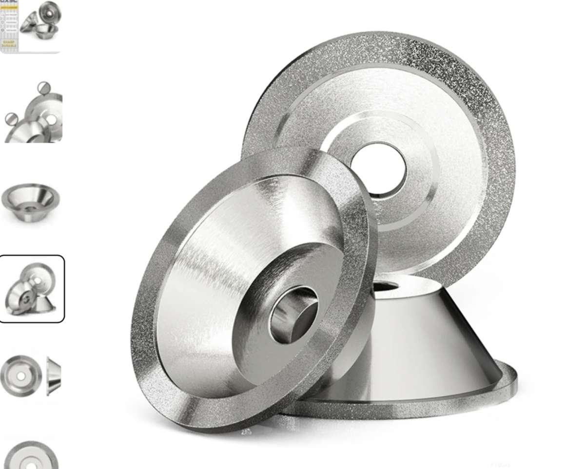

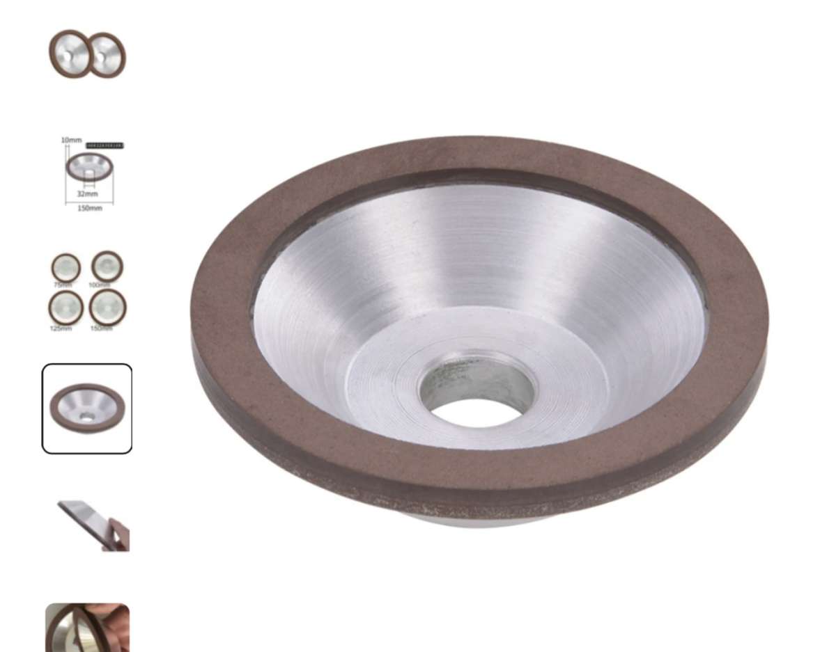

      Do any of you have any experience of the difference between Diamond plated grinding wheels, normally silver in appearance, and the often brown Diamond Resin Bonded wheels?
      #731549
      Vic
        @vic
        These are the two types. I’ve seen both types used on DIY tool grinders.

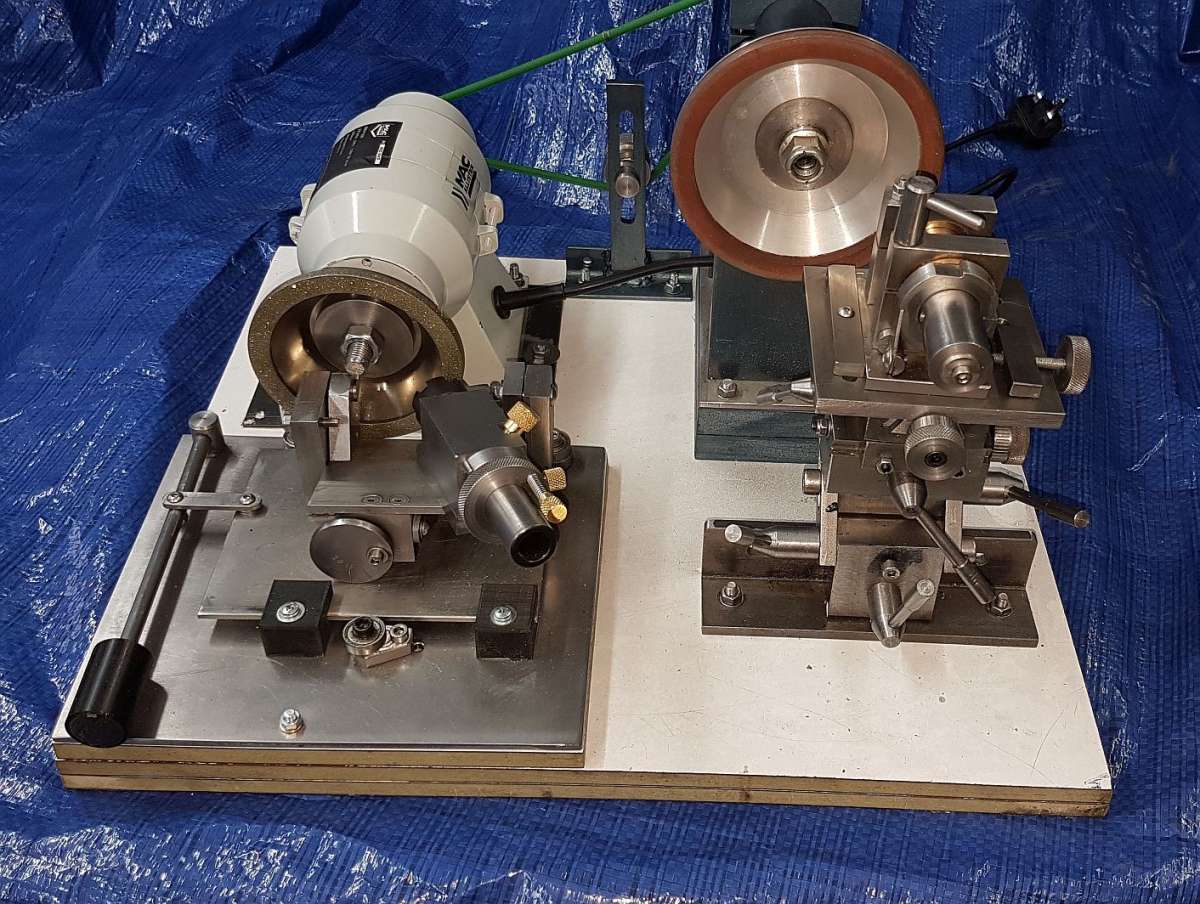

                    IMG_0403
                    #731690
                    noel shelley
                      @noelshelley55608
                      That’s neat !10/10
                      I have a resin bonded job on a Clarkson and it worked well on tungsten carbide. came from ARC. Noel

                        The silver ones are electro-plated diamond wheels. As the name suggests they feature a dense layer of diamonds fixed to a metal substrate by electroplating process. They are very hardy and hold their shape exceedingly well but have only a thin layer of diamond which depleted in efficiency as the edges of the diamonds are eroded.
                        The brown ones are diamonds mixed in resin and cast into a thick layer fixed to a carrier, which wears down in use  exposing fresh diamonds to maintain cutting action.

                          I bought some NOS electroplated wheels on ebay very cheaply, they are much safer than ordinary grinding wheels, explosion proof, made for grinding glass, but work well on carbide and occasionally on HSS. The resin bonded can be dressed, but as there is not much there,only light dressing, and care with contact as you can break off a section easily if ham fisted.
                          Diamond is not recommended for constant steelgrinding as the diamond is carbon and when hot will dissolve into the iron easily chemically, the hardness does not help it.
