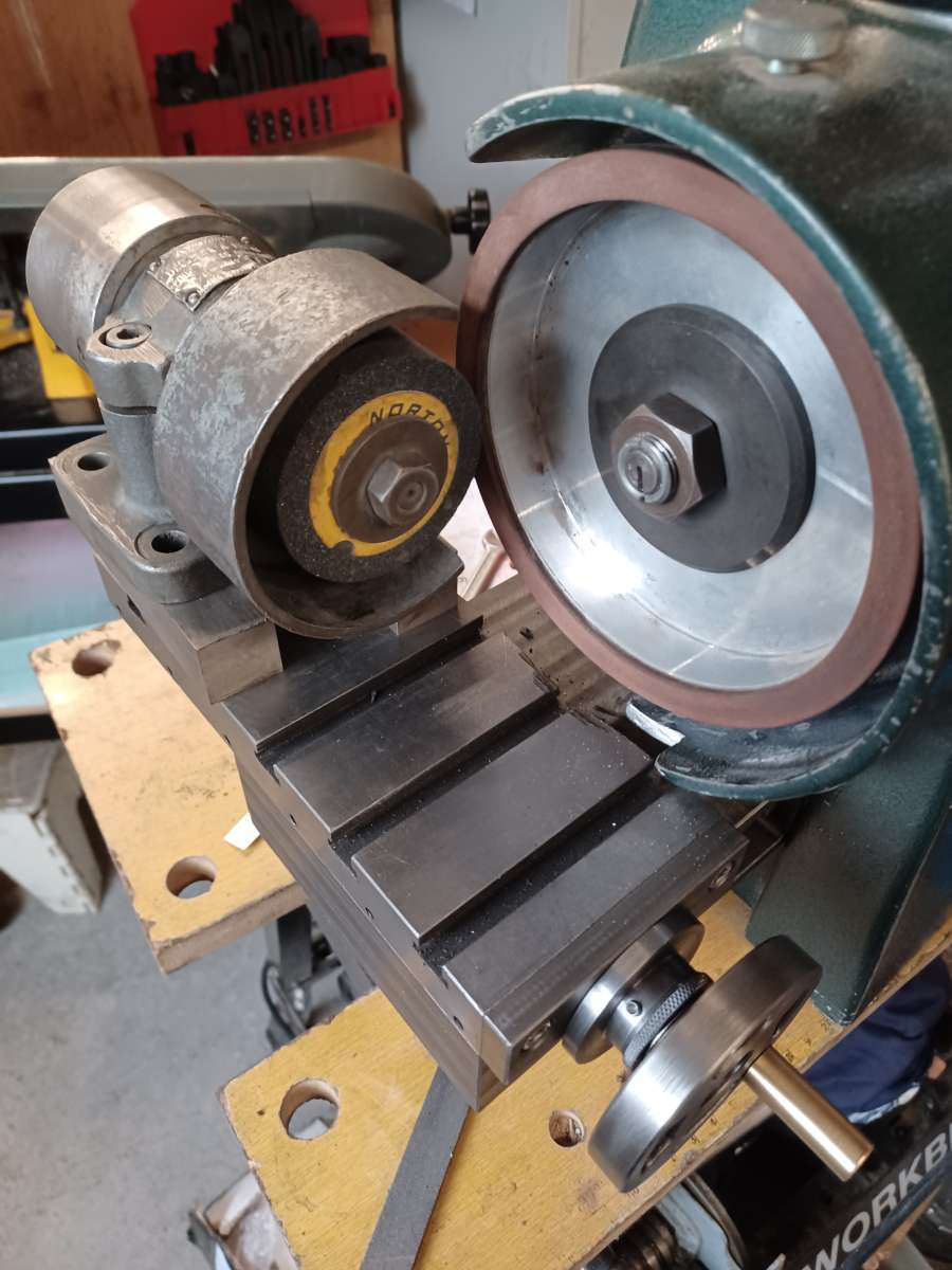

      When at work we had a dressing attachment which consisted of a smaller grinding wheel on a base with a spindle which had a friction brake which when moved up to the diamond grinding wheel would true up the wheel for grinding. when done the wheel would stay true for quite a long time only needing slight dressing with a white abrasive stick occasionally to assist grinding. I would like to get hold of one of these, borrow would be acceptable, as I have a need to dress a wheel on a cutter grinder to sharpen some Carbide milling cutters. Any help in this area would be gratefully received.

        Search for ‘brake dresser’. Commercial ones seem to be priced at a point that would encourage those of us that could use them to make our own (already on the projects list!)

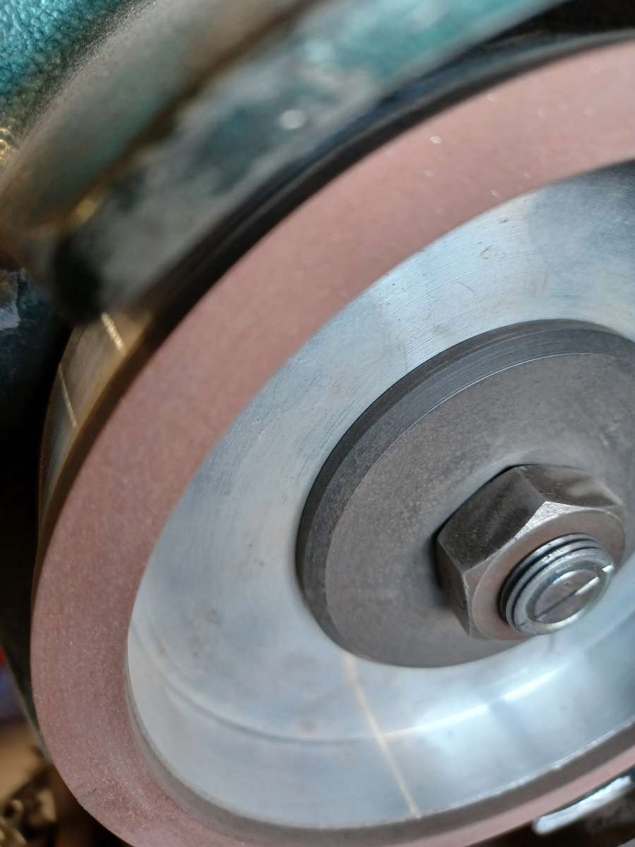

              The problem with my diamond wheel is its a cup wheel and it is the face that needs dressing. The diamiters are very good and run true and flat within a thou on the aluminium diamiters and bores. The face has been used to sharpen carbide turning tools and carbide tips also my wife used it to grind glass for stained glass work occasionally as well. I would like to get the face flat for sharpening the bottom of carbide cutters on my new tool and cutter grinder that I am making. I have fitted a white aloxite grit standard grinding wheel and sharpened a few bits with no problems so far.

                    If you have suitable adjustment on the grinder slides, pivots, whatever, a brake wheel dresser will work just as well on the face of a cup wheel as on the periphery of a disc wheel.
                    if there is only a thou or two to remove, it’s a resin bonded diamond wheel and you are reasonably patient, then you can use a bar of molybdenum as a dressing stick. This works because molybdenum is a right bugger to grind and tears the diamonds and resin from the wheel rather than getting ground down like any reasonable material. I’ve got a bit of moly rod that I’ve used on one of my diamond wheels and it does do the job, but it isn’t quite as aggressive as you might expect from dressing an AlOx wheel. Bars of molybdenum are quite cheap on fleabay!

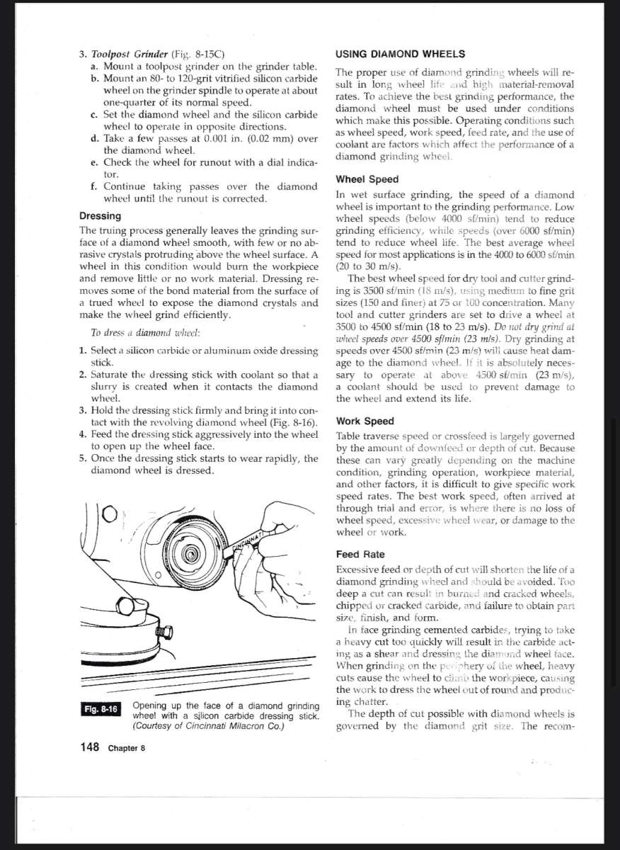

                              <p style=”text-align: left;”>I just posted some screenshots from a PDF by Graff Diamond products which includes multiple ways to dress a diamond wheel, including using a mild steel block (not seen it done, successfully even by Solid Rock on YouTube).</p>
                              Link is also here.
                              The other option they show which I’ve never seen demonstrated is using a tool post grinder on a mag chuck.

                              Braked dressers can definitely be used to face up a cup wheel, with the dresser wheel oriented perpendicular to the face of the cup wheel (same edge of braked dresser wheel used for surface grinder is what trues the face of the cup wheel).

                                I have just put in a bid for a scond hand one for £150.00. I will have to see if it is accepted. I have used these when at work as a toolmaker making inspection jigs for turbines blades. the contact pieces for the castings were made from carbide which needed grinding on surface and cylindrical grinders.

                                      The bid I put in for dressing attachment has been accepted and should arrive Wednesday or Thursday this week. I will make a video of how it works after it has arrived and checked out all is ok.

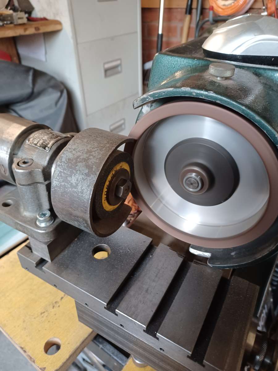

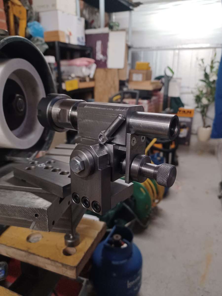

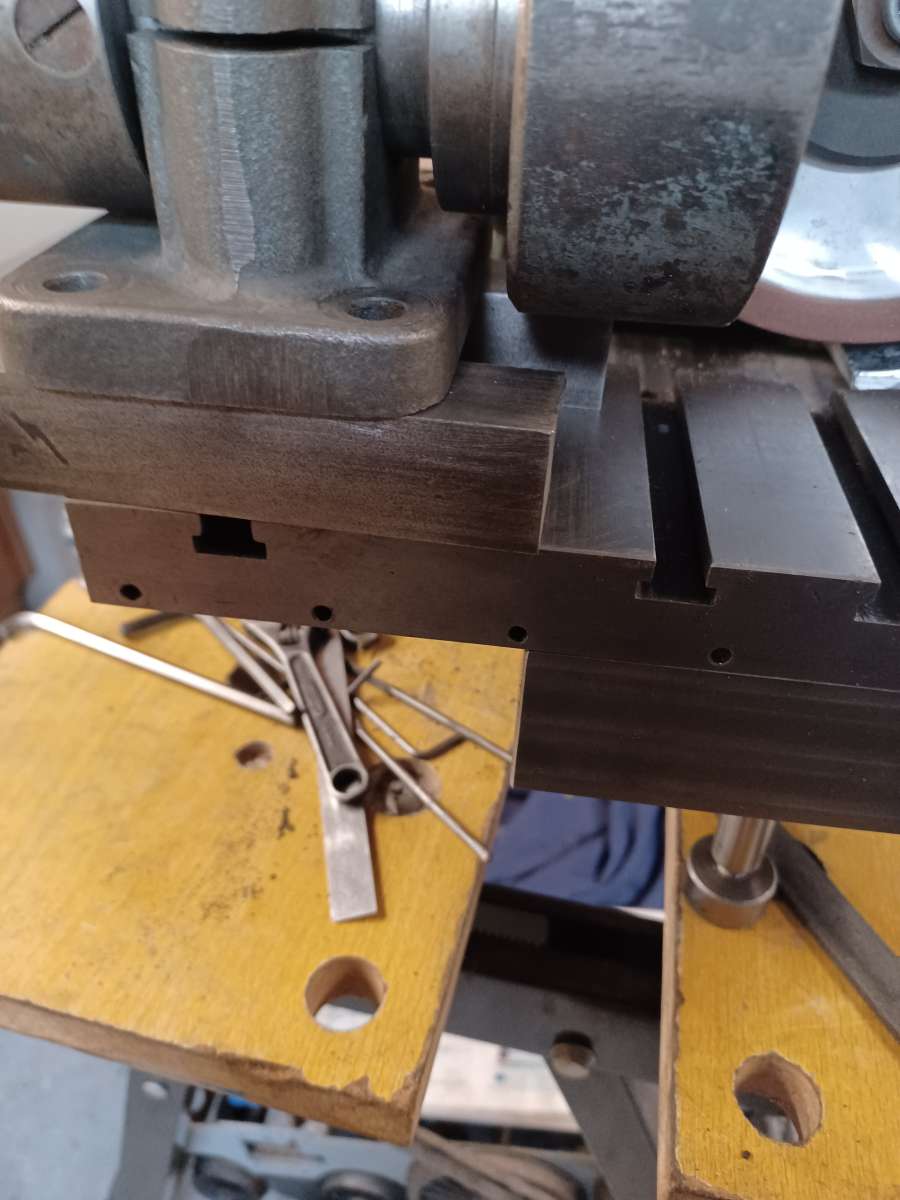

                                          The dressing tool has arrived and it looks ok. the only probem is that the center height is one inch below center of diamond wheel center so i have to make some spacers to bolt it down to.
                                          20250220_154229
                                          20250220_154242
                                          When I have drilled and taped some holes for the base screws and T slot nuts I should be able to try it out.
                                          David
                                          #784938
                                          David George 1
                                            @davidgeorge1

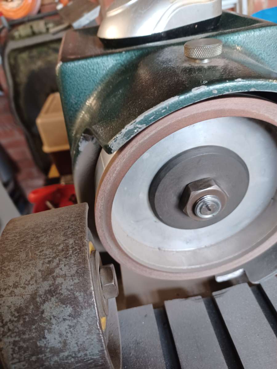

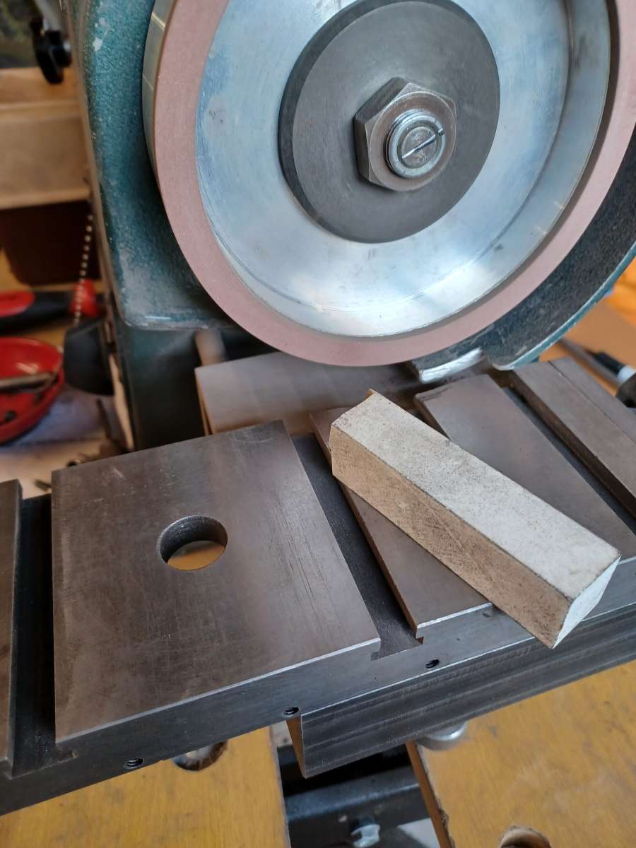

                                            Job done! the dressing wheel was OK and with a bit of setting up the Diamond whell is now flat and you can see the diamonds sparkling in the matrix. It took a few passes to get the wheel to clean up and all I need to do id finnish the Cutter grinder jig and sharpen some cutters and drills.
                                            20250222_111409
                                            20250220_154242
                                            20250222_112210
                                            You can see the face is partialy trued up.
                                            20250222_114556
                                            Nicely cleaned up
                                            20250222_114748
                                            After dressing with dressing stone you can see the diamonds sparkling.
