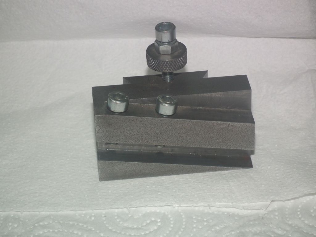

        The Wimberley tool-holder arrived a few days ago,
        I've now had a chance to have a good look at the toolholder and read through the booklet, which is commendably comprehensive. I haven't used it yet as my lathe won't take a 1/2" shank tool, so I either have to modify one of my QCTP holders or make a new one. As I plan a batch of toolholders in the near future, I will probably make one especially for it, as a wider, as well as deeper, groove will help minimise overhang.
        I am struck with the feel and look of quality; it's a beautiful, well finished casting machined to an excellent finish. I'll probably bring it to MEX in my pocket…

            Sorry Vic,
            I thought I had posted a link to the Wimberley website. Below is a picture of a well-used example from the site.
