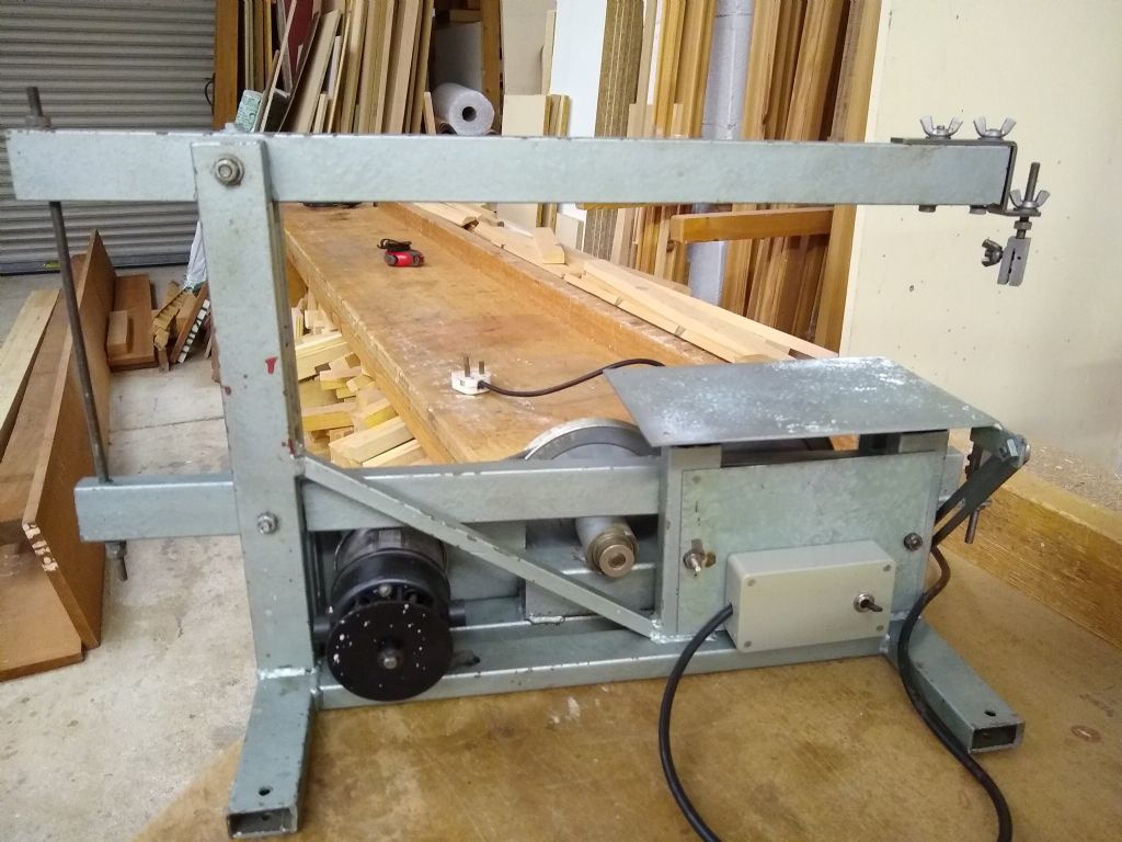

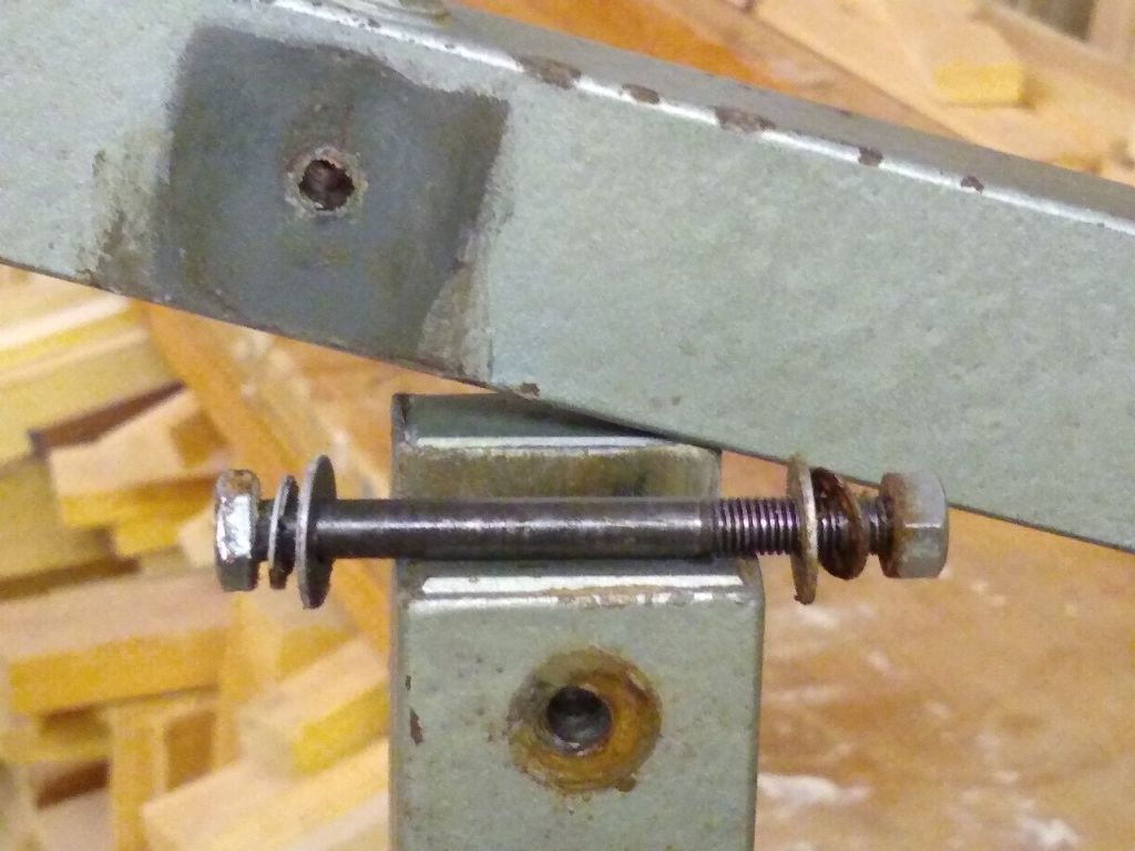

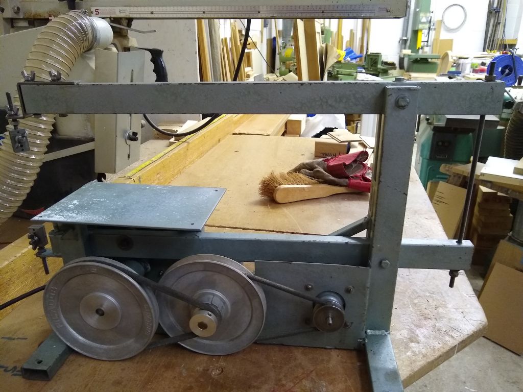

            Hi again,
            here are pictures of mine, including with pivot bolt removed. It is a plain shank bolt, running in round steel tube bushes within the box section arms, so nothing special.
            My saw may not be the same as yours, I think they were improved over time, mine has no guarding to the pulleys etc, although they are well covered by the 18 inch table, when fitted.
            Regards,
            Mark.

              Excellent, thanks for that! Mine is maybe a bit later as has covers, but much the same.
