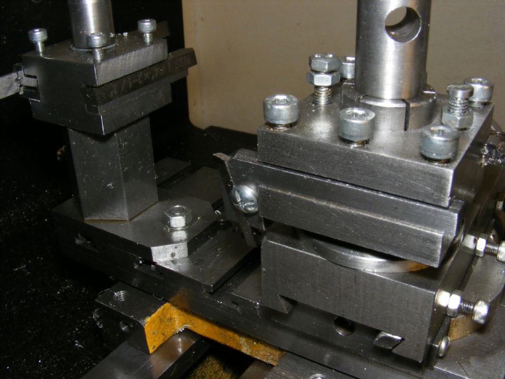

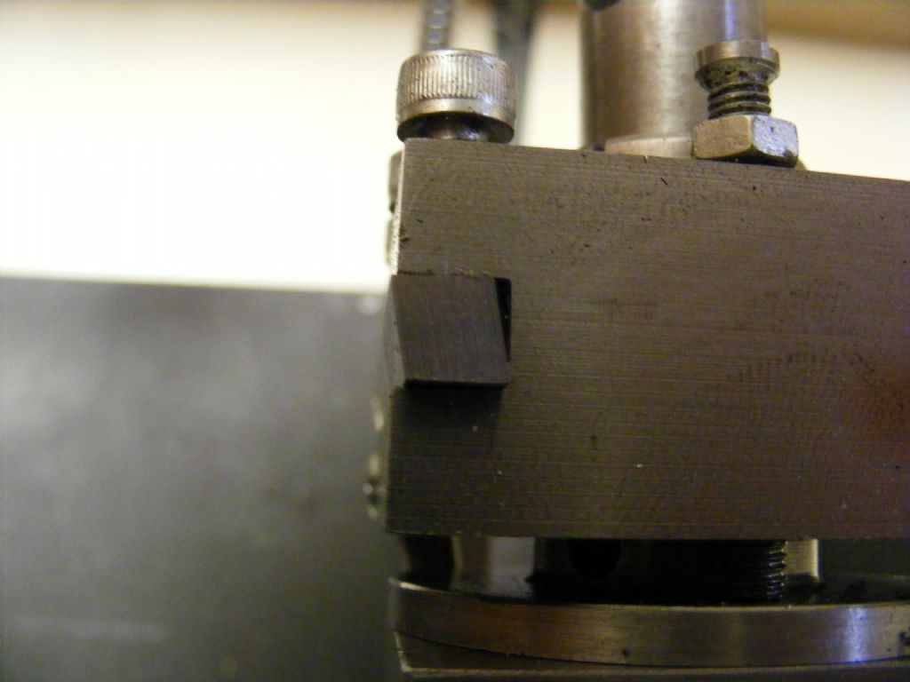

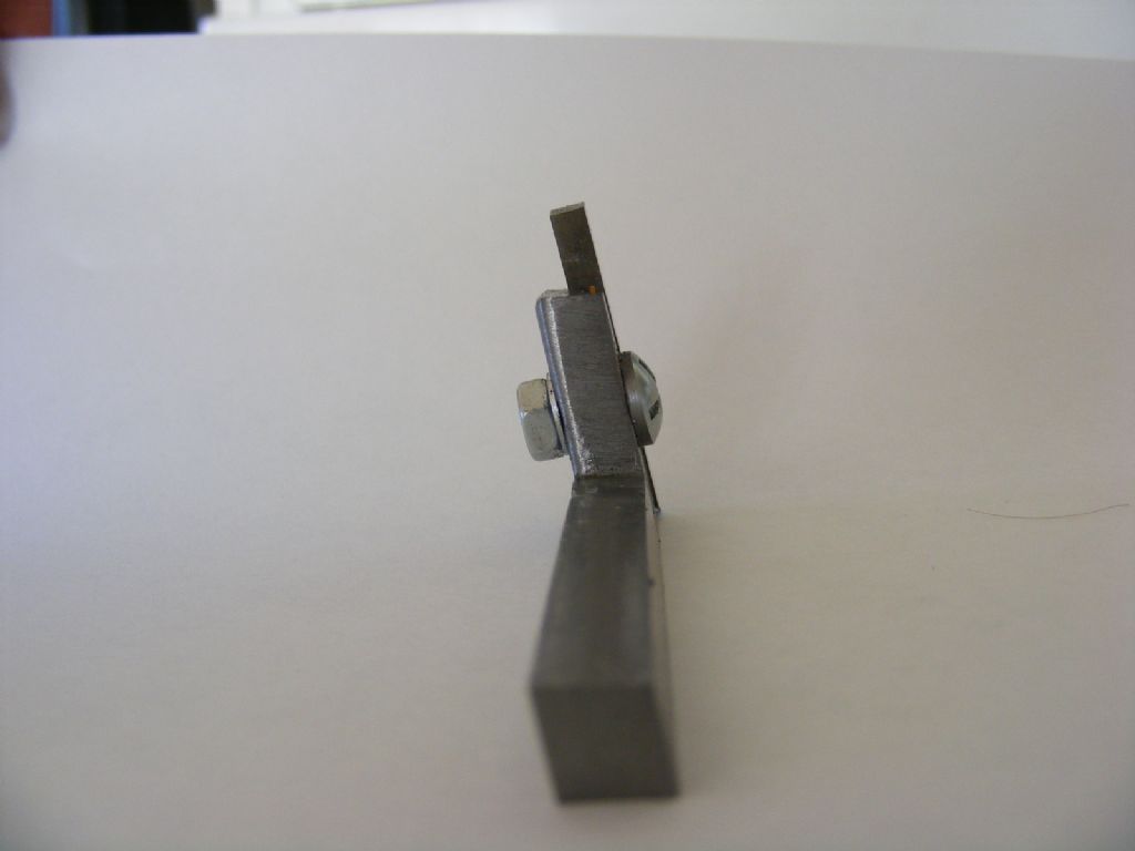

                                  Michael Cox 1
                                    @michaelcox1
                                    In view of current interest in this subject and also the article in issue 156 MEW I thought others might be interested in yet another design of tangential toolholder.
                                    This photo shows the completed toolholder mounted in the lathe:
                                    It is easy to see the 12 degree inclination of the tool in the forward direction in this photo.
                                    The next photo shows the end of the toolholder shank:
                                    This shows that the shank is trapezoidal and this inclines the tool 12 degrees from the vertical towards the head stock. The next photo also illustrates this point somewhat more clearly:
                                    The advantage of this mode of construction is that the whole tool is made from a piece of 1/4″ plate. It is only necessary to mill the slot for the tool at 12 degrees and then file or mill the shank to have the 12 degree trapezium angle. These are very straightforward operations and the whole tool can be made in 3 hours.
                                    I hope this is of interest.
                                    Mike
