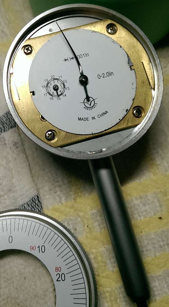

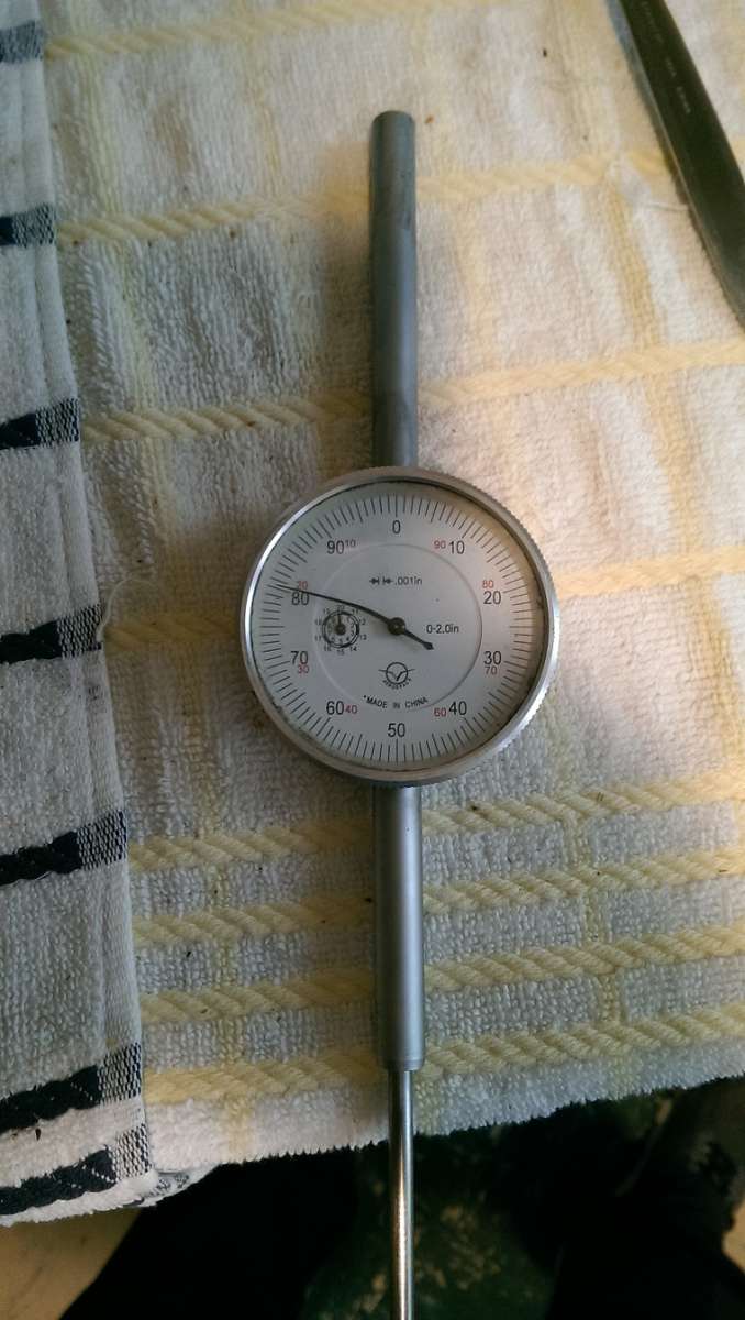

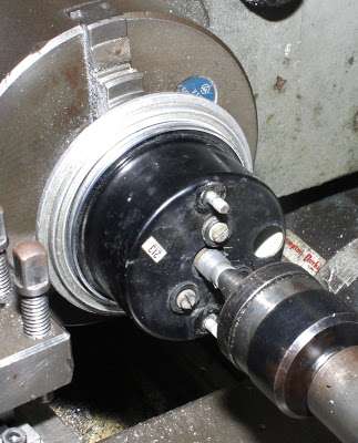

      I got this used 2″ indicator recently. Some jabroni bent the needle, which scrapes against the crystal and makes an awful noise. I’ve seen several YT videos on repair, but I still can’t get the front bezel off. There’s no gasket like some of my other indicators, so I don’t think I can pry the crystal out. And I’ve tried pulling the bezel off, but it doesn’t want to budge even though it rotates smoothly.
      Any ideas on getting this apart?  Does it actually come off the front and I just need more muscle?
      Mike
      IMAG1854IMAG1855

        On some, there is a hole on the side of the bezel which you can line up with three (usually) hidden grubscrews in turn around the periphery of the dial, and remove each one. This will release the workings from the body. I think Baty and John Bull are like that.
        Not always the case though, I have a Moore & Wright which does have a hole, but I can’t locate any screws anywhere. I suspect some sort of spring or circlip is used to retain the bezel, but don’t want to risk messing it up trying.
        Hope this at least gives you an idea where to look. I recall Doubleboost had a series of YouTube videos on dial indicator repair, might be worth a search.

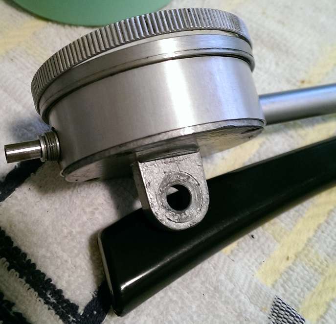

            No screws appear to hold it on.  I tried the valve grinding suction tool mentioned in the Doubleboost video to no avail.  And closer inspection shows that the crystal seats under the bezel ring.
            I put the reinstalled the back and clamped the lug in a vice.  Pried the bezel – with a huge pry bar – and the whole mechanism started coming out.
            This might be a “can’t be disassembled, just toss it” tool.

              I went to a jewellers, and he used a ventouse (Rubber sucker) to pull the glass off. You can get a rubber sucker from an auto parts shop as they are used for sticking to valve heads when grinding them in.

                The Long Island Indicator website is a great resource. They list how all the major brand bezels come off here https://longislandindicator.com/crystal-installation-instructions/
                A lot of them have a concealed spring clip or circlip.
                You should not have to use the kind of force you are talking about. Be careful not to distort the whole shebang.

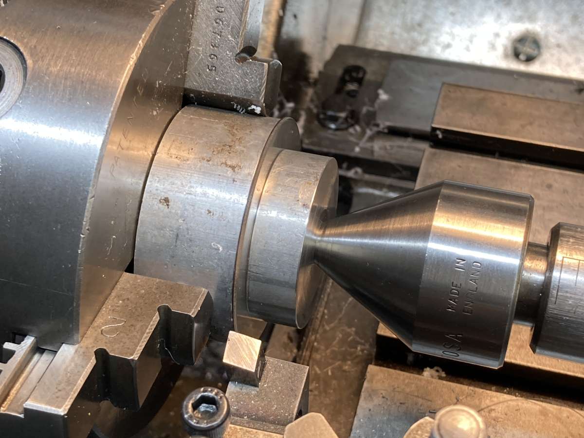

                Unless of course the Chinese cheapies use a bezel that is rolled on during production and not designed to come off again, much like the bezel on old motorbike and car speedos.
                They can be “unrolled” by making a holding fixture in the lathe from a suitable block of wood with a recess turned in it so the speedo/indicator can be sat with the face into the wood. A tool mounted in the toolpost something like a turning tool held upside down can then be used to get  in behind the rolled edge and gradually work it outwards as the chuck is rotated by hand. The Harley bodgers on YouTube do it by working round the rim with a small screw driver on the bench but that leaves a plethora of marks, bends and splits in the edge of the bezel, which they then replace. That’s cheating!

                        I did try the “rubber sucker” valve tool.  And then with a magnifier was able to see that the crystal sits under the bezel, so it’s not coming out first.
                        I don’t know how the jamoke bent the needle, but the back was missing one screw.  Not visible in the photo is that the needle is bent *and* twisted.  The unit otherwise functions well.  The movement is smooth, but because the needle scrapes the crystal it makes a horrible screeching sound and has scratched it.
                        From the site Hopper posted [thank you]: “Aerospace dial indicator: these cheap made-in-China indicators aren’t worth fixing, but you can replace the crystal, if you can get hold of one. The thin bezel pries off with a screw driver (put the whole indicator in a vise so you can get leverage) and no tools are required to put a new flat crystal in place. We do not carry these crystals.”
                        Hmm…That’s just what I did.  I’ll try this again and go for broke.  I only paid $7 (shipped) for this and was excited that it actually worked.  But sometimes the little kid inside says “Burn it!”

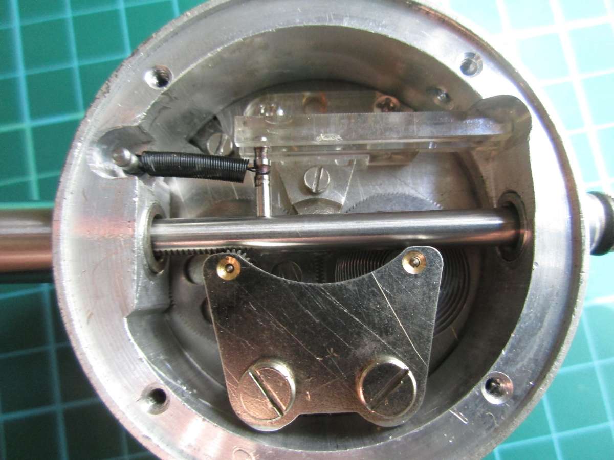

                            Hi, I have a couple of 2″ DTI’s made in China, and looking at it there is no obvious way of getting the bezel off, as there are no screws which you often find holding them on. So I took the back off one, and found a small screw nipping down a piece of steel with a slot in it, which can be seen just above the spring in the photos below, loosening the screw allows the piece of steel to slide inwards, and then that side of the bezel will lift up above the body. I didn’t take the bezel completely off, but I guess once the bezel is lifted above the body, it can slide over the body to enable the body to be lifted clear, but of course you would have to juggle the attached indicator past the needle.
                            Screw and Plate
                            DTI
                            I can’t see anything like it on Mike’s one though.

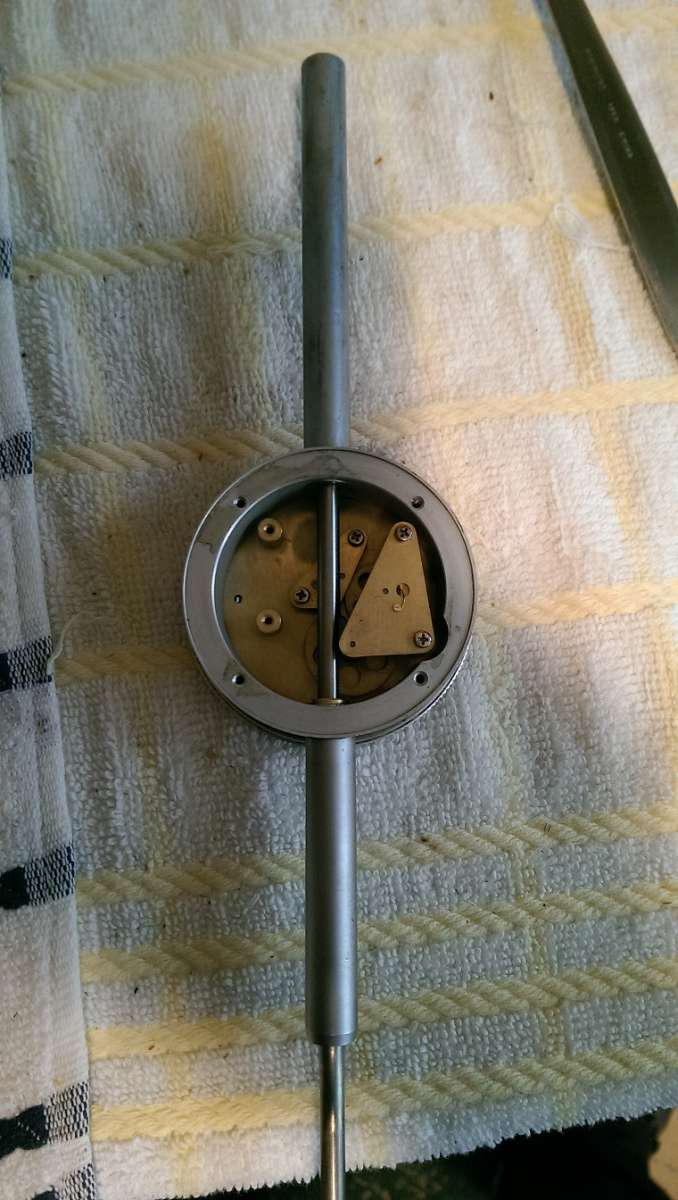

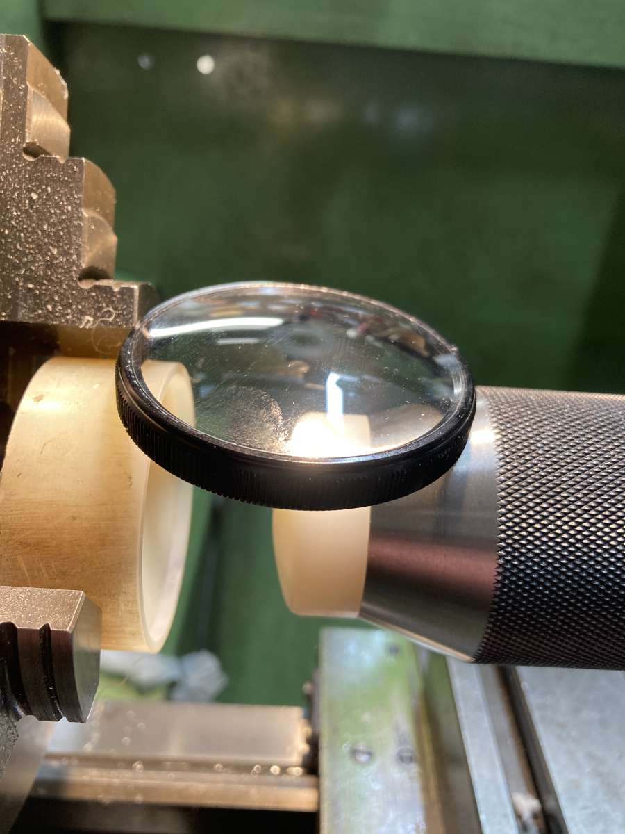

                                  Being encouraged by the information in Hopper’s link I gave it another shot today.  With success!  I had not realized that the bezel was in two pieces and had been prying under the larger part that is attached to the clock mechanism.  Once I pried under just the knurled ring it came off with almost no effort.  (Now to see what damage I’ve done while prying the wrong part.)
                                  Mike

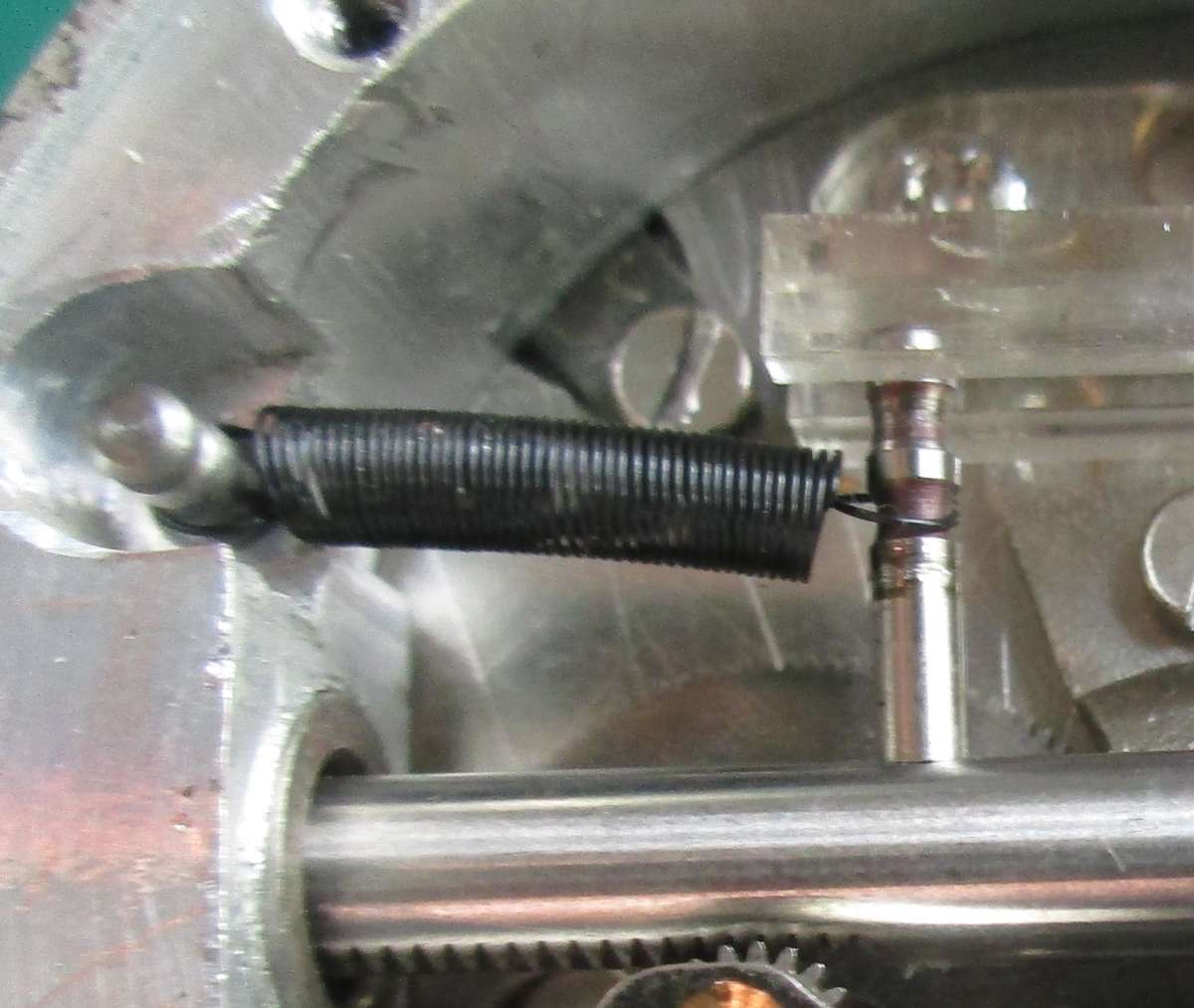

                                    This appears to be the extent of the damage I caused.  The brass tab on the right side is bent, which is where I pried the first time.  That brass plate being what holds the other bezel part to the clock body.  Should be an easy fix.
                                    I swear, I’ll do some real machining today to make up for this.

                                      You should be able to get a new crystal from any clock materials supplier

                                        I recently fixed a couple of indicators, a Baty & A Mitutoyo, during the fix both needed new crystals which I made from flat acrylic sheet ex Ebay.  Sawn to close size then turned clamped between centres held by pressure.
                                        A couple pics may help,  one was flat & the other curved so had to make a tool to insert it.

                                              That replacement crystal looks great, John.  As the circular scratch from the needle on mine doesn’t affect viewing the tick marks I’ll probably live with it, but I’m encouraged to know that they can be easily made.  And mine is flat, so even more so if it does end up bothering me.  A shame I can’t take pride in having resurrected a quality brand.
