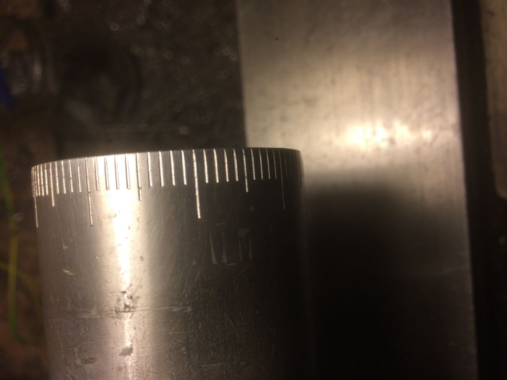

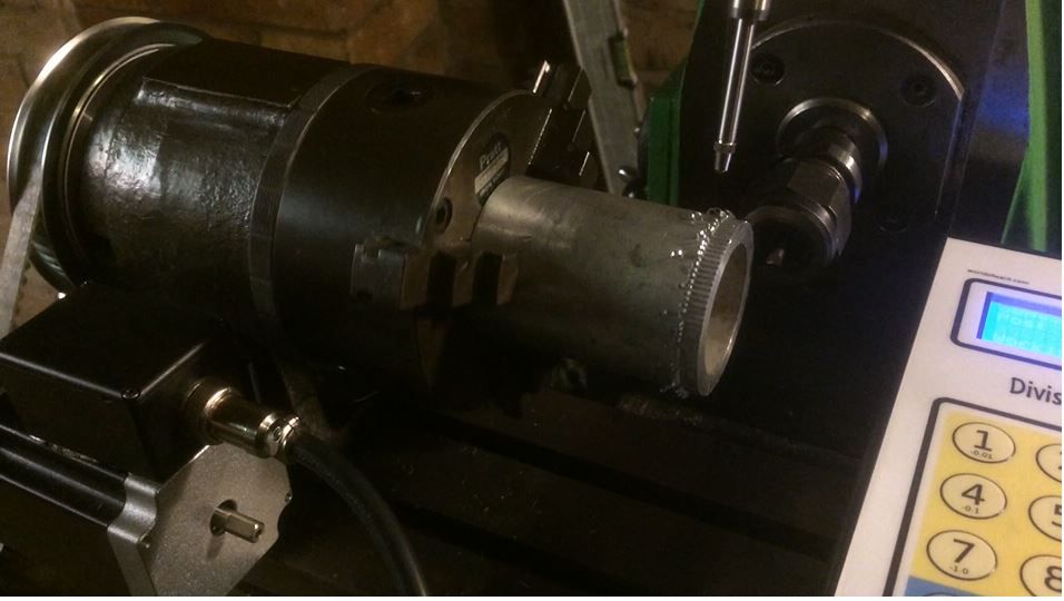

      Having not long ago completed my stepper driven indexing device care of WoW, I was keen to give it a try. My ML10 dials are somewhat faded and dated and non 'zeroable' so with that in mind I decided to have a practice at doing some graduations on a bit of scrap. No point in going further until I know both the device and myself know what we're doing.
      I decided to do it on the Centec as there's more room and the indexer can be bolted to the bed. The arbor removed and a collet chuck in the MT2 with a carbide boring tool I set about making some marks.
      First time round round was x10 long ones, second was middling ones and then the shorties. I jumped each existing digit as I came to it. To my surprise it all happened as it should have and with a bit of tidying up looks pretty good for a first attempt. Just got to sort out the numbers now.img_5562.jpg

        Nigel Graham 2
          @nigelgraham2
          That looks good! I'm interested here as this is a task I will be faced with ere long, for the hand-wheels on two T&C grinders..
          " carbide boring tool… " Were you using the mill basically as a planing-machine, moving the work past a fixed tool, then? That could be the easiest approach for me to use, though I wondered about using a fine-pointed carbide burr.

            Yes, that's how I approached it. I have a box of carbide boring bits which I bought off fleabay donkeys years ago when you could get stuff real cheap. The boring tool is around 4mm in dia and sits in a DA collet in the mill spindle, setting up is the longest part with the actual 'work' taking maybe 10mins tops. The depth of cut was around 8 thou and length was set by using the table stops for each grouping.
            Hopefully the picture explains it better, like most people I used YT to see how others do it and went from there. dial.jpg

              Certainly did a very neat job. Your carbide bit must be good and sharp.
              Certainly a step up from those awful Myford cast Mazak atrocities.

                    I did get the box of tricks from World of Ward, the stepper, controller and other stuff from fleabay, I also used Andrew Whale's YT build as a good guide with a few changes. All in all once I got the courage to start it wasn't that difficult. Probably the hardest part was getting a box big enough for the power supply and stepper driver to be together. That now resides fitted to the wall of the man cave out of the way.
                    I also found Steve Ward extremely helpful and quick to come back with answers to questions.
