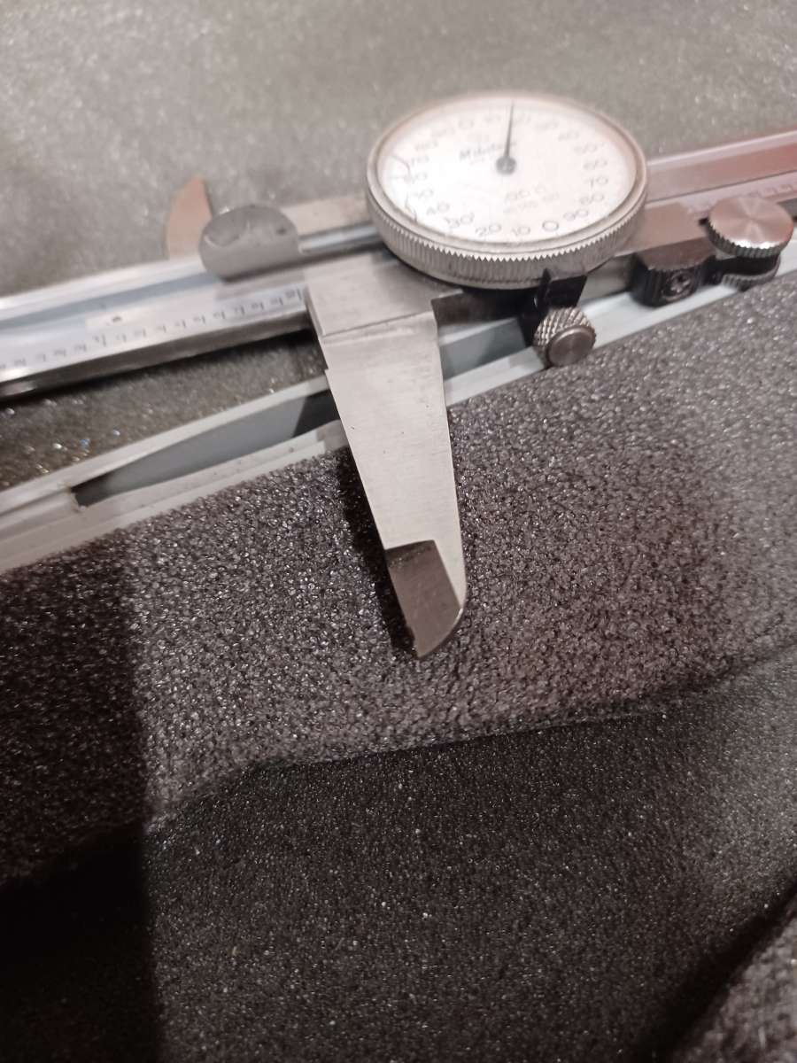

      I recently bought a used Mitutoyo dial calliper gauge from a well known online auction site. It appears to be very accurate but the needle does not come to rest in the vertical position when it is fully closed. This may be the normal state of things, but having never owned this type of calliper before I don’t know. Obviously the bezel can be set at 0 to match the needle so it does not affect the operation in any way but I was wondering if it is possible to make an adjustment so that the 0 starts from the vertical position. There is no obvious way to adjust it, so is this possible or would it be better to leave well alone?

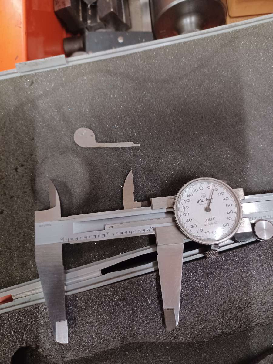

                        I have ane of these mechanical Dial calipers and at time a small piece of material gets into the rack and the gear jumps a tooth and you get a false reading. I like the pointer to point to the 90 deg top of the dial so after cleaning  the rack i put the bronze strip into the gap and slide the caliper till it doesn’t rotate the dial. then remove the strip by sliding it out of the rack the gear rotates the pointer and when closed it may point to zero. if it doesn’t repeat the adjustment till I get a correct result. It’s a knack which comes with useage.
                        20240103_17502620240103_175053
                        David

                          The needle spindle on Mitutoyo dial calipers is sprung against the rack and if you know how it is easy to adjust the needle position without removing the dial face. As I recall, they used to come from new with a little probe that you inserted at the back alongside the rack to tip the needle shaft out of mesh while moving the caliper head slightly along. It is some time since I did this for anybody at work who had dropped their dial caliper. In the fitting shop we often replaced cracked dial glasses and reset bore mics. All except Tesa bore mics, none of us managed to fathom out one of those.
                          Making a tool like Davids one would be easy.
