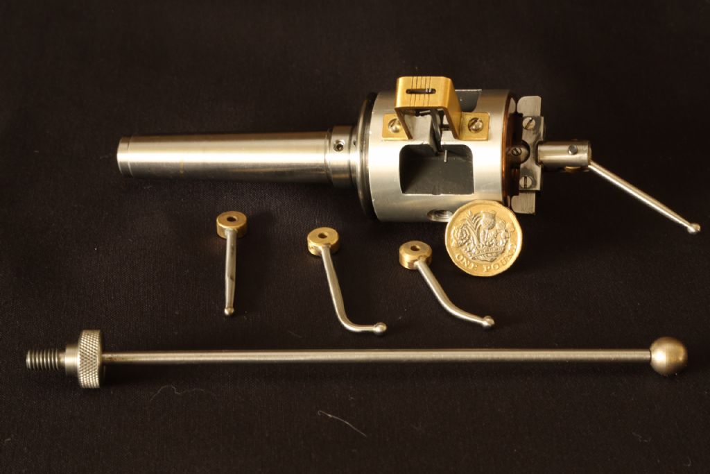

      Does anybody here owns or used a Diacator made by Dietest for centering a hole below your mill spindle, similar function to the coaxial centering indicators-?
      #11558
      Chris Mate
        @chrismate31303
        For centering your mill

          Surely it’s a coaxial indicator by another name?

                  The lever below the DTI translates sideways movement of the probe into vertical and pointer deflection.
                  The clever bit is allowing the dial to remain stationary.

                        A potential advantage of the co-ax indicator types used in a hole compared to a standard edge finder is that they will work at zero rpm. You can turn the spindle gently using one hand and see how the needle moves (even rotating it in discrete 90 degree increments if necessary). With an edge finder, it needs some powered rpm to see the wobble disappear and then observe the 'kick'.
                        With a co-ax indicator, finding centre is quite a smooth single operation. Poke in the hole and adjust until the needle does not move and zero everything. With an edge finder, there are four (maybe six) distinct actions that have to be coordinated with DRO button pressing.
                        Where a co-ax indicator might score is adjusting the height of a dividing head tailstock especially if you are setting it up to cut a taper.
                        Could we come up with something a co-ax can do that a standard indicator and a mirror cannot do?

                          One of the big problems with a lot of commercial coax indicators is the amount of headroom required so if you have a small mill they can be impossible to use which is why I when the route of making my own. A nice satisfying project which gets used again and again.6dbf7fcb-cf00-40ff-a368-f4334e879ac6.jpeg

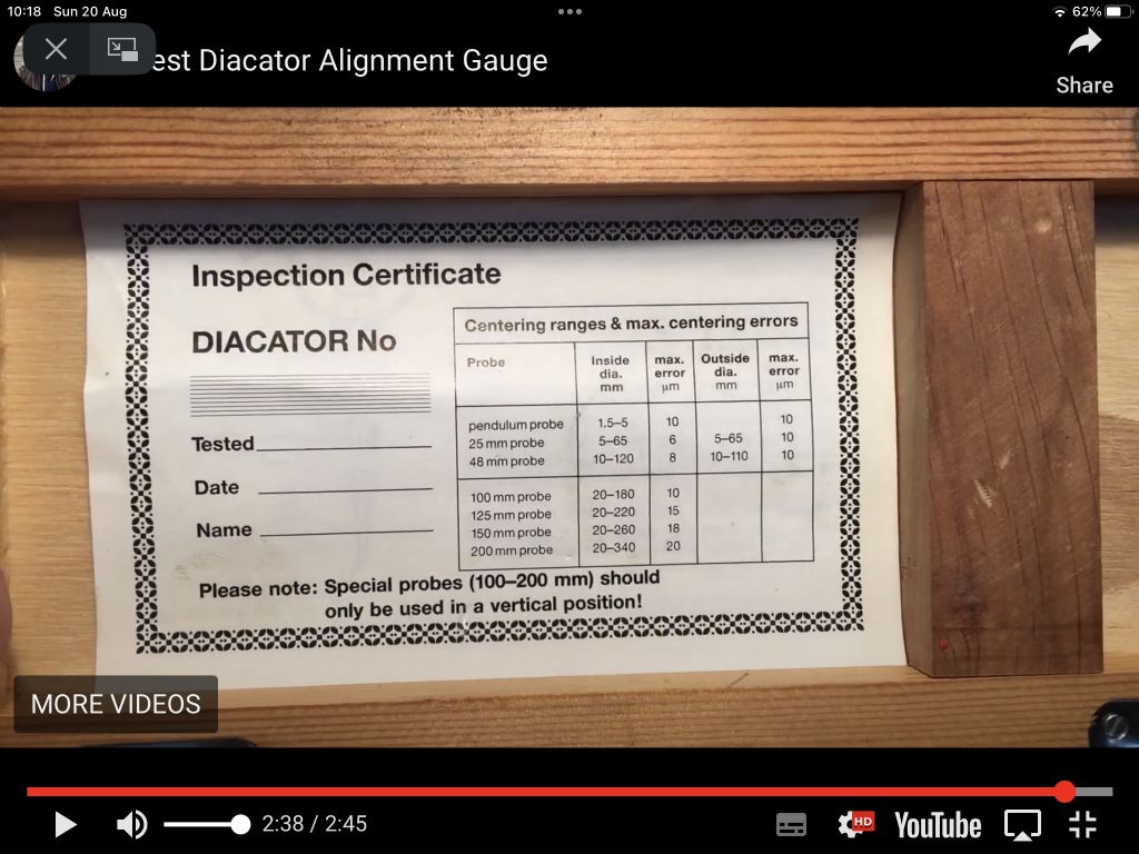

                            I assume there must be something special to justify a price three times that of a Blake indicator and nearly twenty times that of generic ones? As it is used in the same way I cannot see it speeding up the operation enough to save much cost.

                              I assume there must be something special to justify a price three times that of a Blake indicator […]
                              Presumably a combination of ‘country of origin’ and claimed accuracy
                              ’though I note that the certificate is unsigned !

                                I have a Haimer Centro:
                                Claimed accuracy is 2 microns not that I have any way of confirming that. The only problem is that (as Bernard says) it does need a fair amount of headroom.
