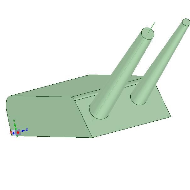

                  #173065
                  Ady1
                    @ady1
                    It's very intuitive.
                    I've yet to look at any help files and can create and manipulate 3D widgets with ease

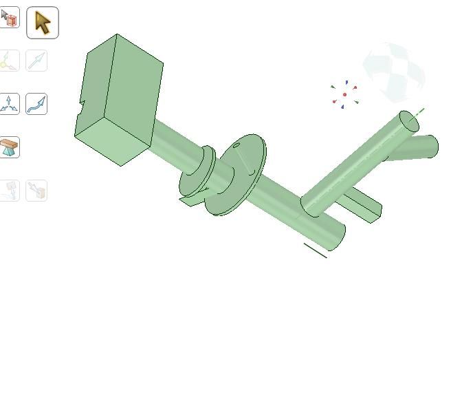

                    #173067
                    Ady1
                      @ady1

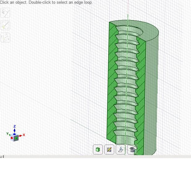

                      #173101
                      Ady1
                        @ady1
                        Helix threading within 24 hours of my first look
                        Apparently the files can be saved in that 3D printing format, STL
                        #173105
                          Posted by Ady1 on 20/12/2014 12:52:15:
                          Now that is very impressive, Ady

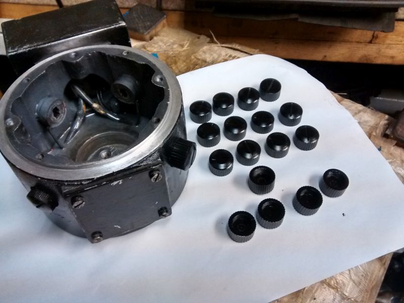

                          #173110
                          John Stevenson 1
                            @johnstevenson1
                            Could have done with that last week when i had to make 16 brush caps for some obsolete servo motors.
                            Made these out of Corian as it takes a thread better than Tufnol. Need to learn this 3D CAD.
                            I was booked on a Turbocad course at the start of December with Paul [ the CAD ] Tracy but he got taken ill and had to postpone it.
                            #173111
                            Grizzly bear
                              @grizzlybear
                              Nice, Ady1
                              Question for J.S.
                              John, How did you get the knurls/finger grips on those brush caps. Nice work.
                              If the answer is a knurling tool, my apologies for a silly question.
                              I'm not familiar with Corian.
                              Regards, Bear..

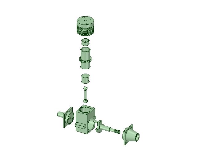

                              #173112
                              Roger Woollett
                                @rogerwoollett53105
                                I agree DSM is easy to use.
                                I have used it for 3D prints very happily. For this design I create 2D dimensioned views and take them to the workshop. They would not satisfy the purists but they work for me. It is still work in progress as you may be able to spot.

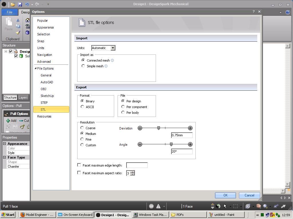

                                              Can someone please list the file formats Designspark 2 is able to load and save to.
                                              Thanks.
                                              Martin.
                                              #173161
                                              Roger Woollett
                                                @rogerwoollett53105
                                                Peter – there seems to have been problems with registration. If you have managed to register a user name/password I suggest you lo in to the DSM website and edit your profile. I have my job title as Hobbyist.
                                                Save the profile, wait a couple of minutes and then try again to start DSM.
                                                If you have not managed to register at all then do so through the website and then try to start DSM
                                                blowlamp – The open menu shows ECAD, OBJ, SKP, STEP and STL. So pretty limited.
                                                Save as offers AMF DXF OBJ PDF SKP STL XAML JPG and PNG
                                                Roger Woollett
                                                #173162
                                                Ady1
                                                  @ady1
                                                  The PCB helpfile is here but I couldnt find a mechanical helpfile
                                                  However, there is an STL import/export option in DSpark mechanical 1
                                                  So if your own package can do STL I presume you can transfer stuff over in DSpark 1 and 2
