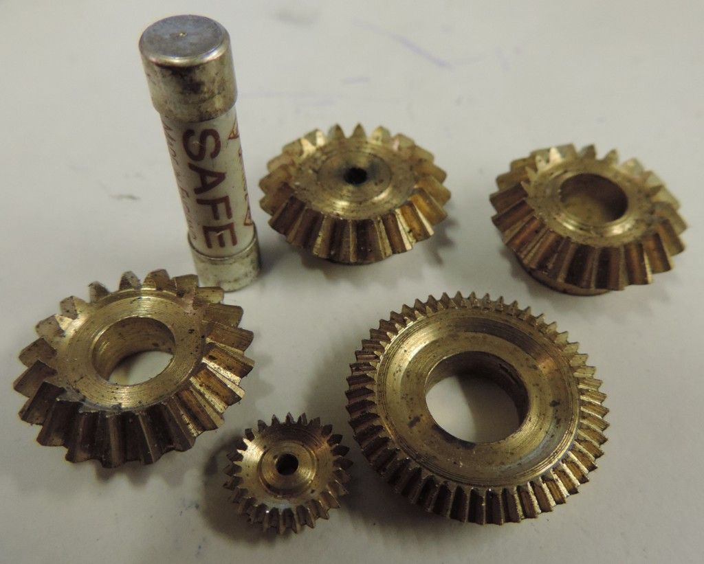

          Hello Emgee,
          It can be done. All the gears including the pair at the front of the picture below were designed and made using Ivan's method.
          The starting point are two cones whose points meet and whose circular bases are the starting point for designing the gears. Assume the teeth take up 1/4 of the face of the cone.
          If your big gear is 40mm at the outside, the inner part will be 30mm diameter. The smaller gear will be 13.3mm OD, and 10mm at the inner end.
          Calculations of the gear size all base on the small end so say we have 30mm with 60 teeth and 10mm with 20 teeth you are looking at 0.5MOD, which is pretty small.
          You can use fewer teeth, but…

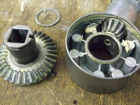

                Thanks Neil and Bob for info, I now have more info on the gear having stripped the box down, pictures in my album.
                Bevel gear 2.75:1 output:input. Pinion No of teeth =12
                Large gear Diameter 57.80mm, No of teeth=33 1.5 MOD at centre of 9.5mm wide gear tooth.
                Tooth Angle is approx 17 degrees (107 deg from vertical axis)
                This box is from a wind out awning that skips teeth when winding in. Bought a new box but there is so much free play in the spindle, and 30 degrees of backlash between gear teeth, I'm concerned it will need replacing again very soon if I fit it.
                Any more help very much welcome.
