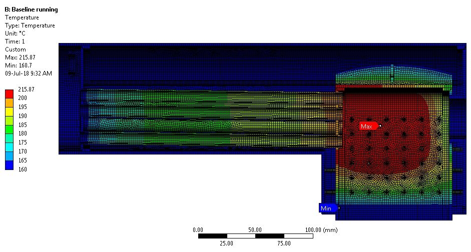

I’ve been following this thread with great interest. Thanks for the mention Nigel but I don’t consider myself an engineer… still have a ways to go.
My two cents worth… Thermal radiation depends on the assumptions, with most of my simulations based on grey body radiation, the formulation for the emissivity is adjusted using first principles to account for specific conditions like dust, and build up on the thermal pickup surface. I’ve found with the boiler simulations that using straight black or grey body assumptions results in the heat transfer to the water being over-predicted. The view factor is calculated in the FEA, a little computationally intensive but you only need to do it once for a specific model. This is relatively new, a few years back this was a hand calculation typically using a solver in excel (not difficult just takes a while to setup).
There are many experiments for onset on nucleate boiling with some of these results shown in textbooks; worthwhile to have a look at. The non-dimensional analysis used in HE design is based on these early experiments with the calculations and formulations really just curve fitting. Perfect for water/steam which is what most of the experiments were done on.
I agree with Noel, just build it and try not to overthink! For the boilers and locos I design I do the initial calculation and simulations to decrease the build time and to make sure I’ll be happy with track performance, but I make sure it doesn’t keep me out of the workshop for too long! I have built a Martin Evans loco with the boiler doing the job on the track, but the designs were I’ve put a little effort in heat transfer and flow dynamics is orders of magnitude better (I can’t take credit for this, the computer did the work!).
The attached picture is from a slide show I used in a presentation, I wanted to upload the whole slide show but I’ll spare you all the HT FEA jargon.

The computer does not know how to analyse the physics of a miniature locomotive boiler – you need tell it how. You still need know the sums and how to tell the computer to do them for you.
