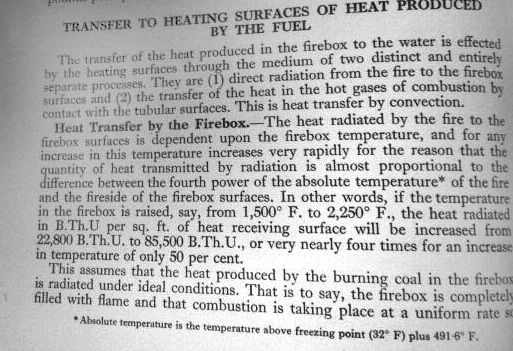

                      Sorry, but that T Deg to the fourth power is THE most important change that takes place inside the locomotive firebox to increase steam raising when it is needed most..
                      #521725
                        Posted by J Hancock on 22/01/2021 11:29:22:
                        Yes of course, but perhaps this extract explains better what I was trying to say. First the 4th power rule, but at the end 'This assumes that the heat produced by the burning coal in the firebox is radiated under ideal conditions.'
                        I'm only suggesting the firebox of a scale locomotive isn't 'ideal conditions' and no-one understands the differences sufficient to model them mathematically. Could be wrong!
