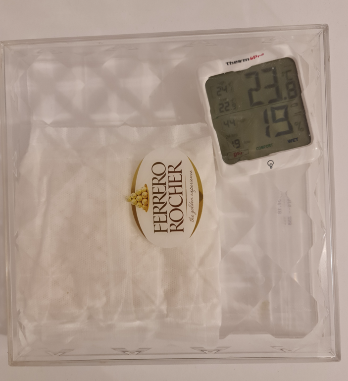

      I noticed that my precision vise has a few rust spots. It is only one year old and it was nice and shiny. I have also a lot of of greasy milling cutters that I want to clean and I’m afraid they will start to rust after. I’m thinking on a simple way to prevent rusting for the tools that I’m not using very often. And I don’t like to cover them with oil.
      To make a test I put a 500g calcium chloride bag in a box. After 5h the humidity dropped from 49% to 19%. Is this dry enough to prevent rusting? Calcium chloride is relatively cheap since it is sold as replacement for room dehumidifiers. But it is bad for lungs. And I think it creates some hydrochloric acid when absorbs water.
      I’m thinking also on silica gel. It is suppose to be less effective but is chemically inert. You can buy it in large bags for cat litter.
      I can store the tools in large zip bags with some desiccant. Or maybe custom build a tool cabinet and put a few kg of calcium chloride on the bottom? The cabinet will be hermetically sealed of course, to don’t slowly dry the planet.
