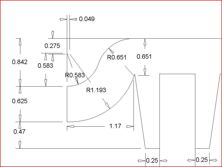

                    Could someone tell me the center coordinates for the r0.583 radius that is drawn hanging in space on the back of the main frames please. That or the vertical distance of the top of the buffer beam to the top of the frames.
                    Thanks in advance.
                    Martin
                    #136938
                      The extended length of the arrow does not help but I would say horizontally it is in line with the end of the frame and 0.583"above the top of the 0.625" end. You can locat ethe bottom of the 0.625 end by swinging the 1.193 radius.
                      J
                      #136940
                      Martin Kyte
                        @martinkyte99762
                        So if the centers are concentric that gives (1.193-0.583) = 0.61 rather than 0.625 for the buffer end.
                        M
                        #136941
                        Martin Kyte
                          @martinkyte99762
                          Drawing it like that puts the top of the buffer beam above the top of the axle box cut outs which are shown as 0.625 below the top of the frames. Looks wrong to me.
                          M

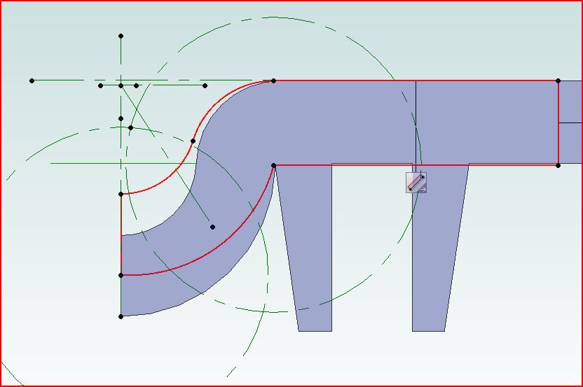

                          #136945
                            Did not say the centres are concentric, you can work out the centre position of the 1.193R with trig.
                            The base of the triangle is the 1.189" dimension, the hypotinuse the radius of the circle 1.193, the short side is the end of the frame which works out at 0.0095" above the line of the axle box cutouts.
                            This is what I come out with when using the drawing dimensions in Alibre, you should be able to see the three springing points of teh arcs highlighted and notice the one for the 0.583" is above the 1.193", click to enlarge.
                            Though my feeling is that the 1.193" radius is wrong as it pouts the front buffer lower than it looks or the illustrator has not plotted the positions correctly which is quite possible as the junction between th etwo small curves is not exactly flowingcrook
                            Edited By JasonB on 03/12/2013 18:23:55

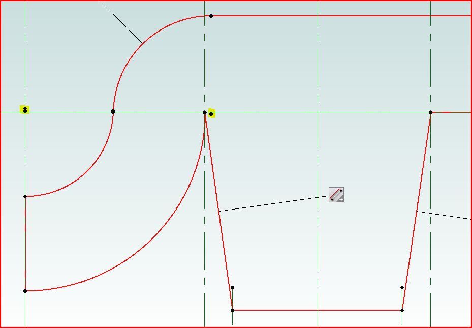

                            #136949
                              Just played about with it a bit more based on the 0.840" Diane gave for the 33deg line so the corner must be a little more than this below the top of the frame, 0.875" is the next obvious size. I have plotted it over the one above and it does look more like the printed drawing but really need the o.875" confirming as it could be plotted up or down from that.
                              The two large dotted circles are sprung from each end of the 1.193" curve, where they meet is the centre of the curve
                              Edited By JasonB on 03/12/2013 18:58:42

                                  Dick Allan
                                    @dickallan56872
                                    I am delighted to have given so much amusement to you all in worling out what the back end of Derwent's main frames should look like! Martin Kyte is right, I should have given dimensions for the buffer beam (actually the drag beam) and these are 0.842" from the top line of the frame to the top of the beam and 0.470" from the bottom of the horns to the bottom of the beam. That done the exact shape of the curves is not very critical – for my own Derwent I set them out by eye! Neverthe less I am full of admiration for the display of mathematical wizardry.
                                    While I am at it, several of you noticed the errors in positioning the water tender axle boxes (Fig 25, ME4469). Of course it is blindingly obvious the something is wrong and, no, it is not an optical illusion as one contributor wondered! This is what happened. Using Draftsight (CAD programme) when drawing in multiple objects of the same design one designs only the first and then ' copy/paste as a block/ paste as a block etc for as many as required, placing them only roughly in place. The objects are then moved into acurate positions. I did this for the pair on the righthand side of the drawing when an interruption took me away and I forgot to finish the job. Anybody building the model will find it obvious where the axle boxes have to go as they have to fit into the limited spaces in the under frame. I was surprised that the plan was redrawn for ME without this being noticed!

                                      Thanks Diane for chasing this up and Dick for comming back so quickly.
                                      Martin I have drawn it out again with Dicks info and shown the dimensions to locate the centres of the three arcs
