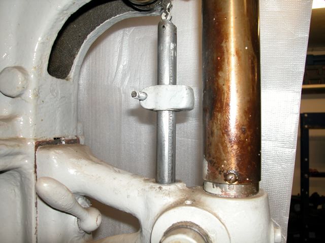

                          This is the split clamp on a rod style stop on the Fredr'ck Pollard 15 AY pillar drill. Scale not as clear as it could be. Clamp bolt currently a socket head cap screw which I've been meaning to replace with something finger friendly for best part of a decade. Don't use it much and don't have anything suitable in the box so ..

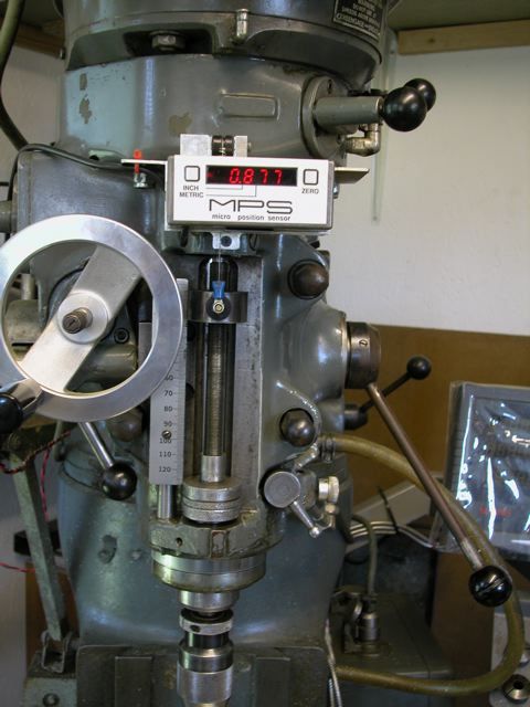

                          The modified calliper and similar vertical scale devices make nice quill depth scales but every fitment I've seen always gets in the way of things to some extent. The popular Quillstar and clone fitments on Bridgeport heads cover the stop adjustment nuts so you pretty much have to choose between a really nice depth scale and (relatively) easy depth / power feed stop setting. Not that the standard Bridgeport setting process is particularly quick and easy at the best of times.

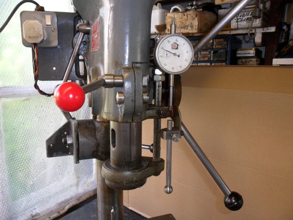

                          Way back I put a BW Electronics pull wire system on my quill. Had to run the wire over a pully 'cos it came out the wrong side but its still the neatest and least intrusive system I've seen.
                          bw on bridgeport.jpg.
                          Often wondered if there is a way to do a similar out of the way cable style operation on one of the cheap scales. Or maybe its possible to rip the electronics and thimble rotation sensor out of a digital micrometer and drive it via a spring tensioned endless cord system as used on the big old valve radios like mum & dad, or granny & granddad, used to have.

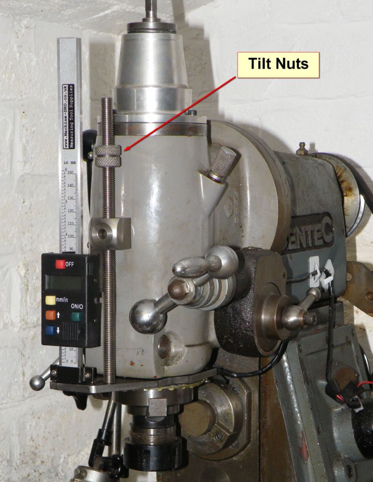

                              I faced a similar dilemma when I added a depth stop to my Centec VH. I used a threaded rod with a pair of Tilt-Nuts for the actual stop. The tilt-nuts have the useful property that, when tilted they "unlock" from the threaded rod and can be moved up and down easily; they re-engage with it when un-tilted. In use, the lower one lowered to the stop block, which orients it to engage the thread. The top one is the lowered until it meets the lower one, which orients it to engage the thread when they can be locked together.

                                Thanks for posting Gary. For anyone else who's never heard of Tilt Nuts here's some more information.

                                  I've an idea in mind which would need a clamp on the quill shaft as in the photos, using a plain vertical rod and a sliding clamp to adjust the depth. I would need to arc weld a bracket on the casting for the clamp to stop on.
                                  This will take me a long time to produce anything worth showing.
