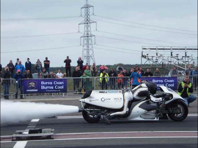

      A note for steam jet fans next weekend Graham Sykes Force of Nature steam jet motorcycle will be attempting to increase his 2022 speed at Melbourne Raceway near York
