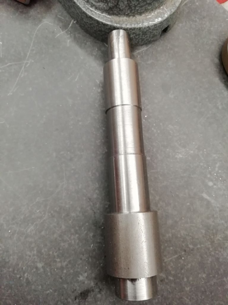

                  Roger Clark
                    @rogerclark

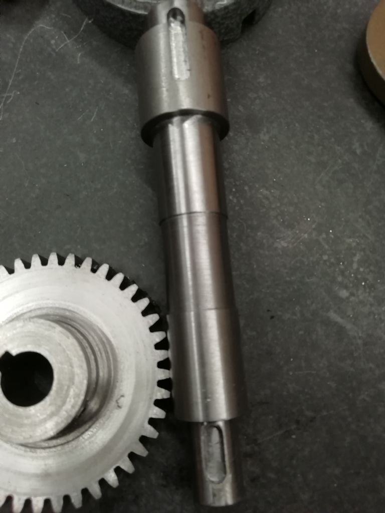

                    Will do, sahould be collecting a newly made mandril tomorrow morning. I will need to do a couple of 3/16" keyways and then it's the rebuild.
                    Roger

                      Roger Clark
                        @rogerclark

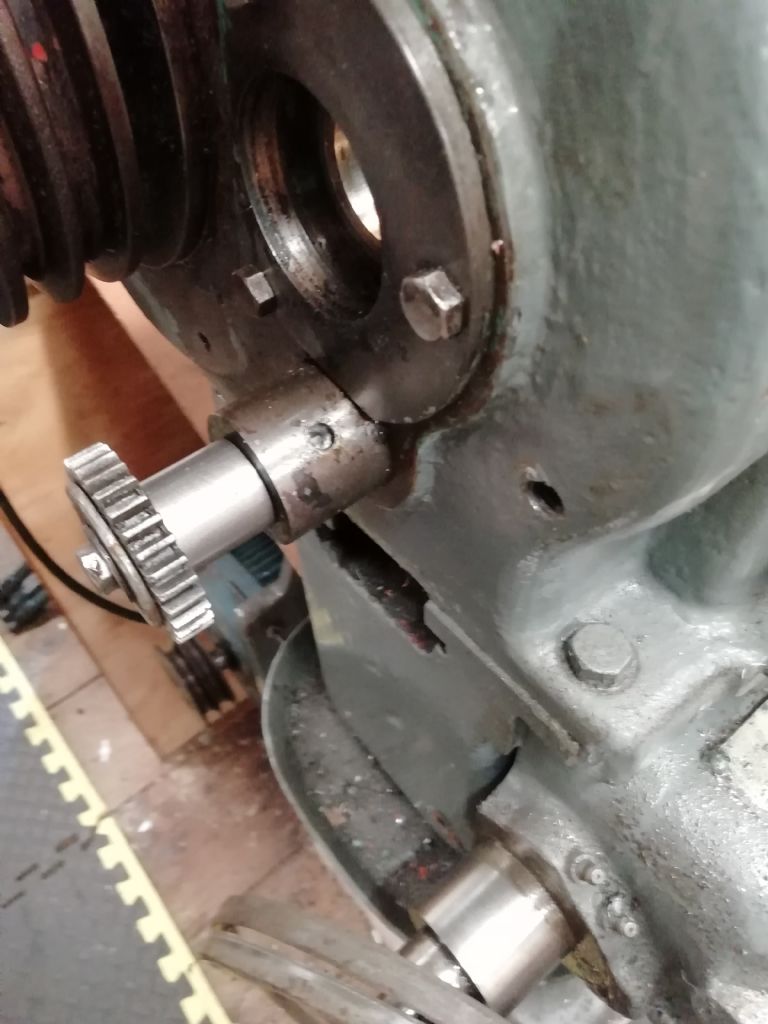

                        Collected replacement mandril from Simon
                        And milled the keyways out
                        Strangly the key on the outside of the head was quite slack in the change wheels so I'm making up a replacement key to fit.
                        Roger

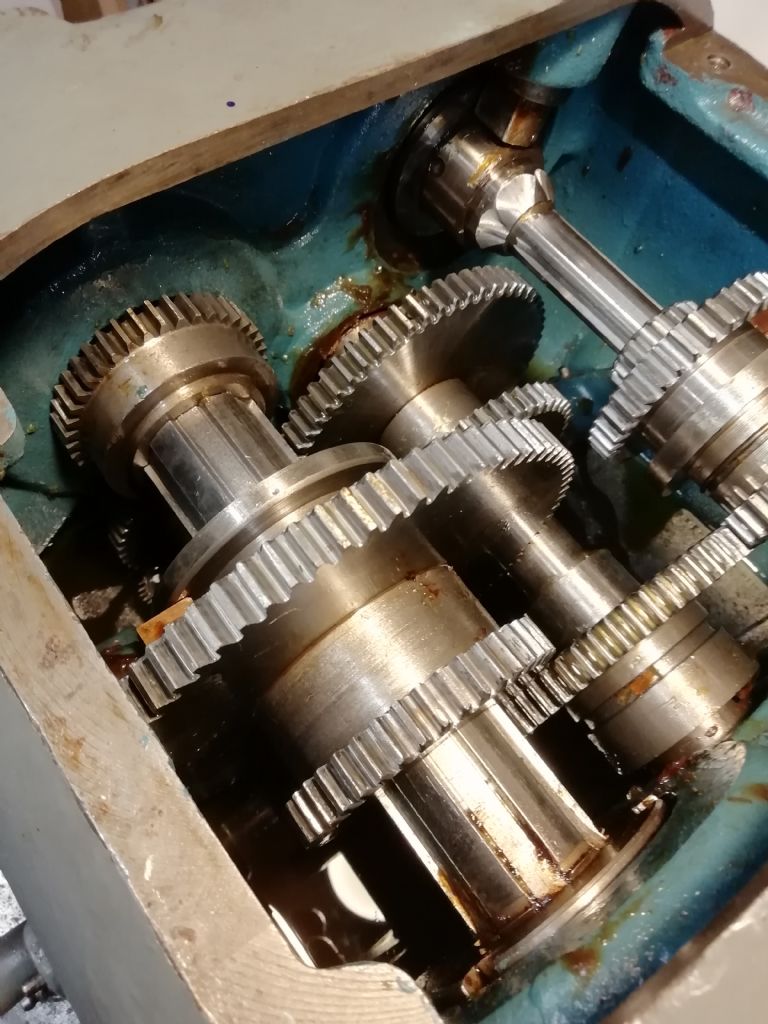

                          Roger Clark
                            @rogerclark

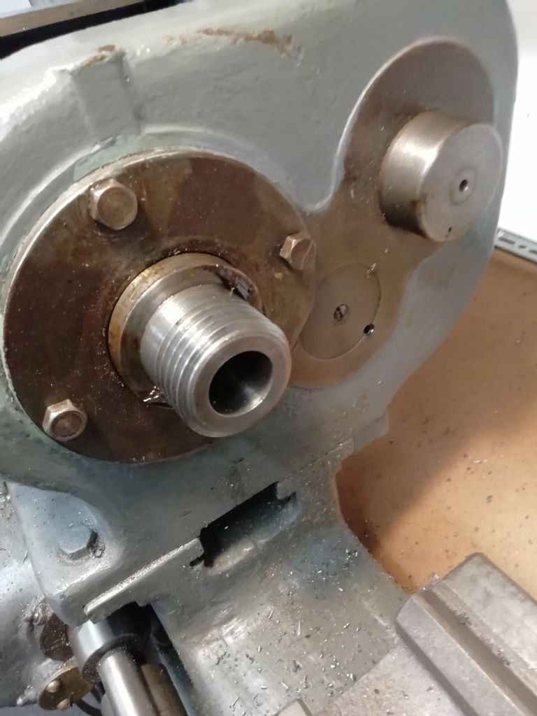

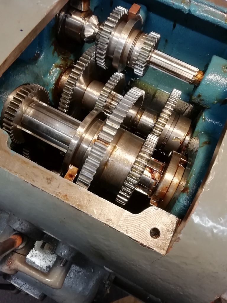

                            Ok so reassembly starts
                            Mandril inserted into orifice
                            Chuck spindle inserted feeding it through the main gears and gear on left that meshes with the Mandril
                            Chuck spindle re-inserted feeding it through the main gears and gear on left that meshes with the Mandril the right way round blush
                            Front bearing retaining cap fitted
                            cont. in next post
                            Roger
                            #655270

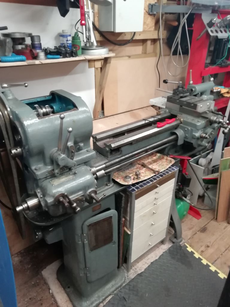

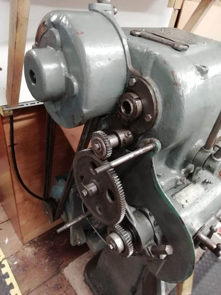

                            Roger Clark
                              @rogerclark
                              Cont. from last post

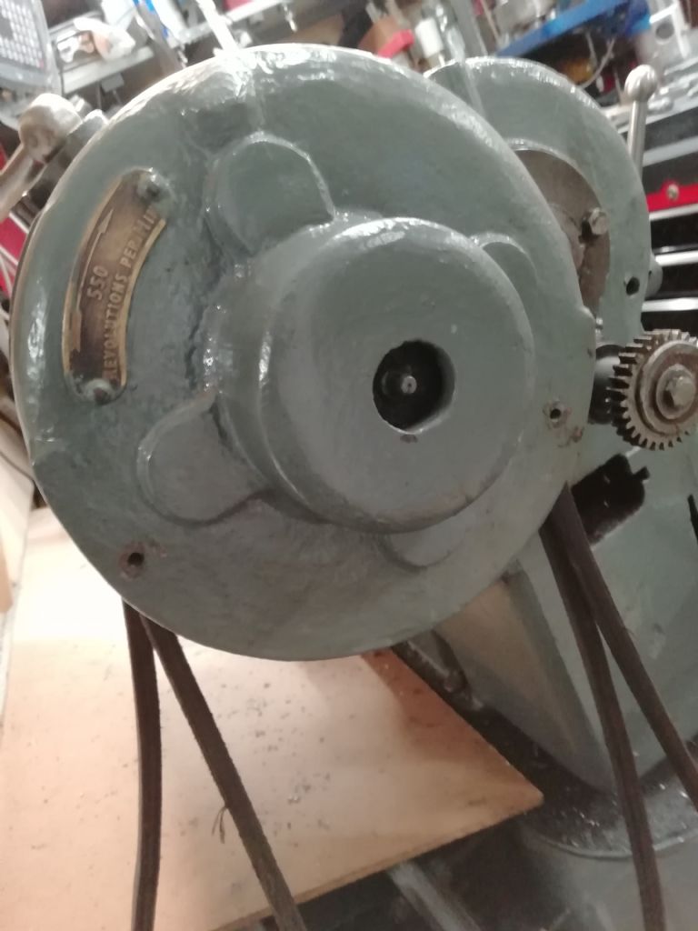

                              Top on to avoid bits falling in.
                              Fit cover for the belt pulleys and clutch spring, this is a real PITA as there is minimal room where the cover has to be held in one hand and the belts wrangled over the clutch spring and the double pulley especially as it's a heavy casting. devil

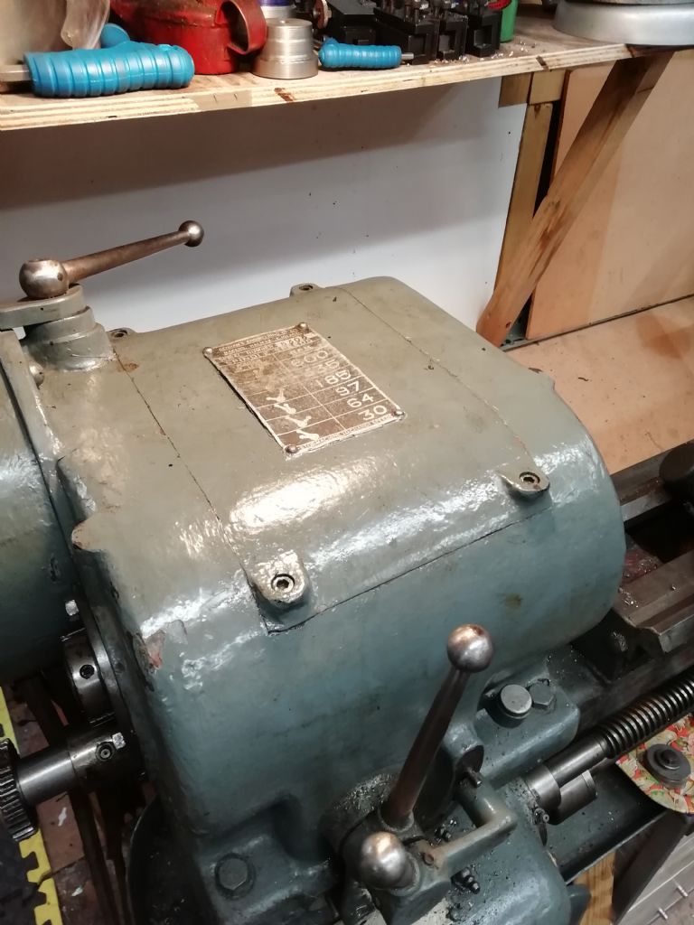

                              Then it's the change wheel train and support plates to fit and adjust, I did run the lathe berforhand to check correct meshing and change of speeds, and then run up the gearbox and check all speeds and leadscrew and feed, all works as expected.
                              Just need to fit the covers and we're back in operation smiley
