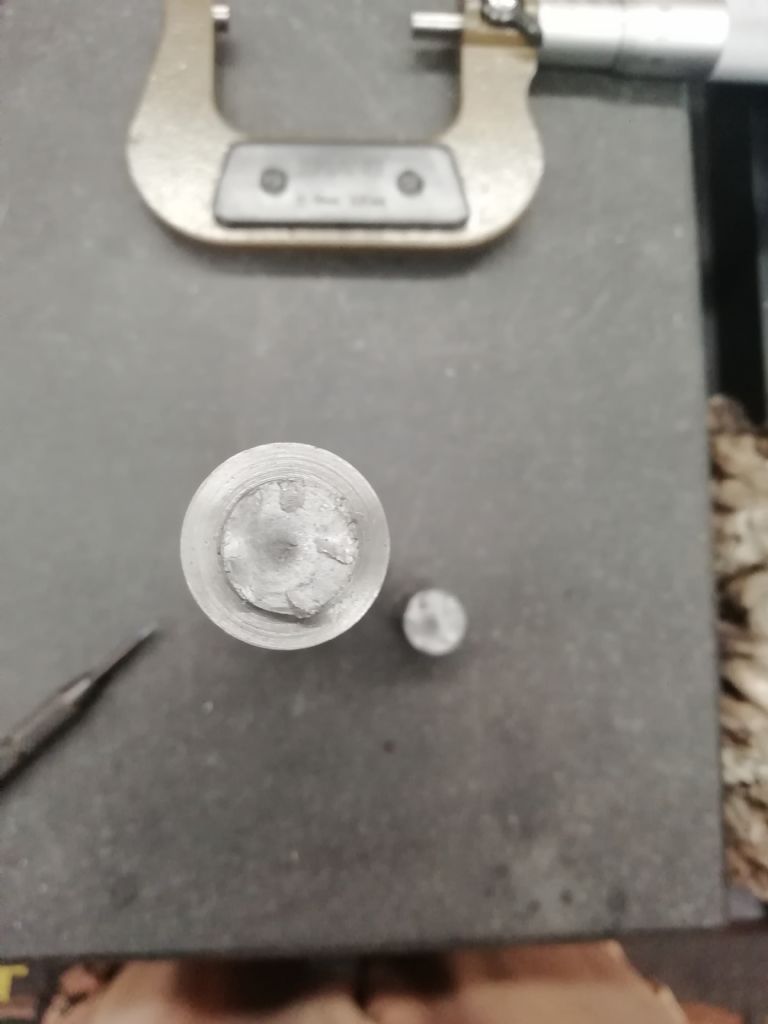

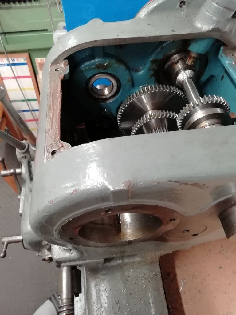

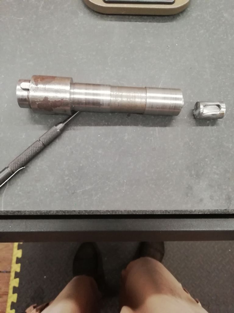

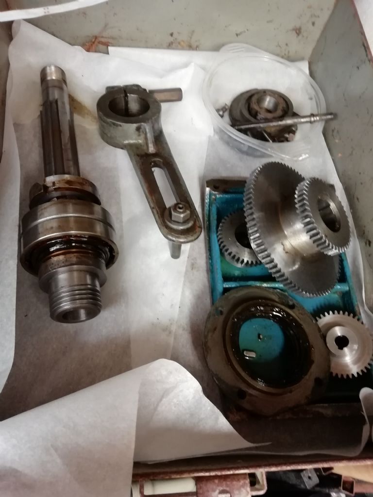

      Stupid me had an episode while setting up the lathe to do a 6tpi internal thread and crashed the toolpost into the chuck. This snapped the end off the mandril that takes a feed from the chuck spindle out of the head for running the treading spindle and the power feed.
      Is there someone who could face, drill and ream the end to take a new piece, either to press fit, silver solder or some other way of reparing it for me?
      The largest diameter of the shaft is 1", the diameter of the bearing surfaces that run in I think a Babbit bearing is 0.75" and the broken bit is 0.5" with a 3/16" keyway that I could do on my mill.
      Overall length is approx. 5"
      I live in Ross-on-Wye, Herefordshire but could mail the bits if anyone can help please?
      Thanks
      Roger

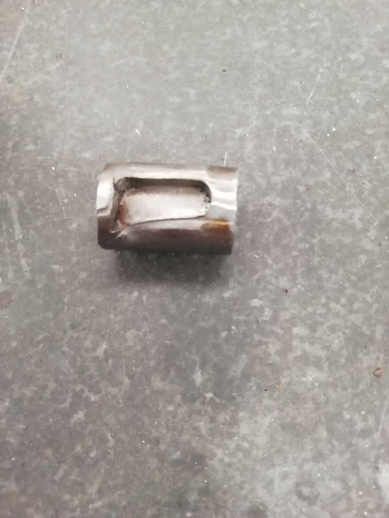

        Snapped the end off the mandril

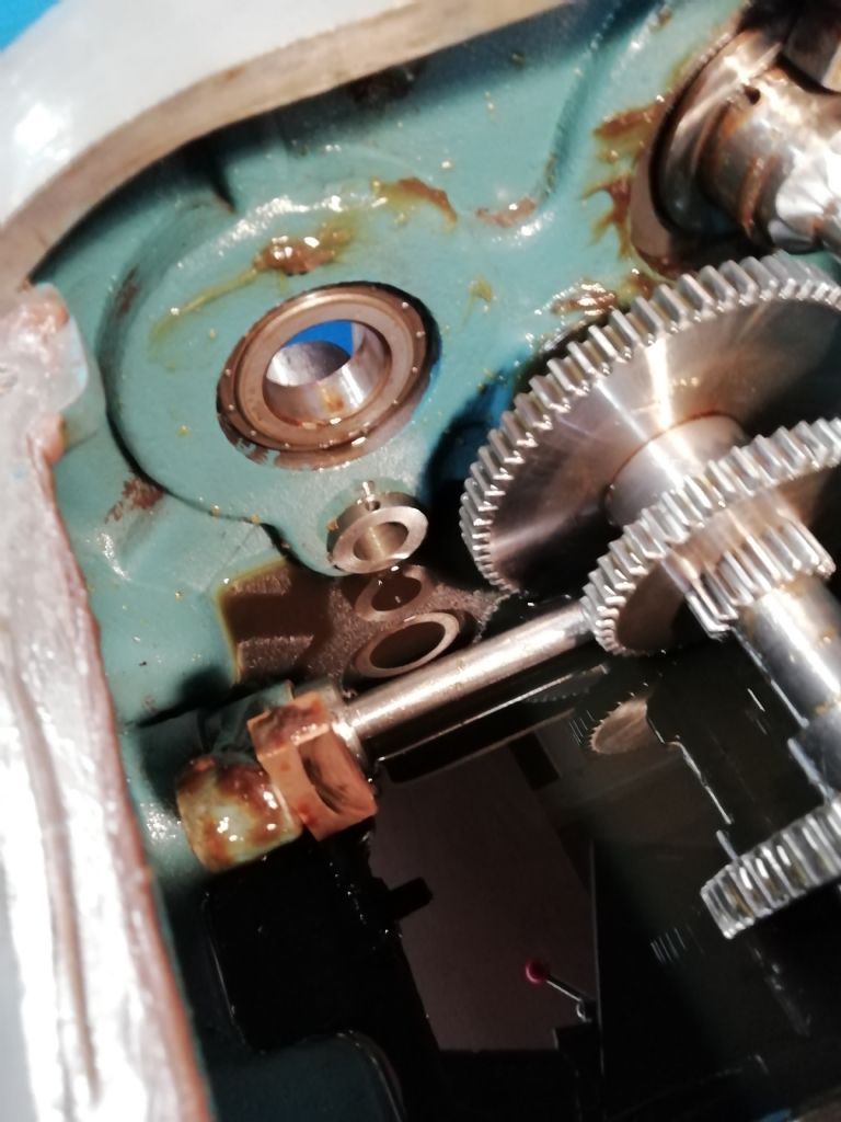

                  That's what was necessary in order to retrieve the bit of shaft with a 40 tooth gear attached to it, so no chance of machining any time soon besides my spindle bore is 3/4" and I would be machining with at least a 4" stickout with no support, not a good scenario for accurate work.

                    Nope, would need more than 30rpm and a small toolpost to damage it, didn't even mark the piece of metal it was holding.
                    Strangely the power feed has a clutch built into the spindle but the leadscrew doesn't, I suspect it might of had a shear pin in it's early life but was replaced with one that wasn't a shear pin!!!

                        Size not a problem except for maybe a watchmaker's lathe. Hold thick end in chuck with operation end in fixed steady. Perhaps best to locktite in oversize piece and turn to size to ensure concentricity.

                            If you want to send me a accurate diagram i can make you a new shaft complete and post it on?

                                  If I can offer use of a lathe to make a fresh one or whatever repair you think is appropriate let me know. I'm in Ruardean, less than 10 miles from you. I have sent you a PM with contact details.

                                    When you get the lathe repaired, you should research the possibility of a frangigle link that is common tith most lathes. Plastic gears in an accessable part of the drive train or a little drive pin like Smart & brown lathes have. It would lower the likelyhood of a major crash.
                                    You could repair the shaft using a mill if you had a rotary table.

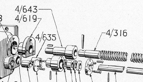

                                        4/487 is the part broken
                                        snipped out of the circa 1937 user manual cheeky
                                        Apologies can be considered laugh
                                        Roger

                                          I must investigate if this is a just a taper pin or meant to be a weak link
                                          Doesn't give the pin at the end of 4/316 a number so maybe replace it with some cheddar cheese might work? indecision
                                          Roger

                                            FWIW, When i did some unintentional metal mangling, During the strip down for repair, the roll pins came out.
                                            As soon as the lathe could be used, totally manually, I made two (For the Leadscrew, and for the Feed shaft ) brass pins, 5 mm OD 2.5 mm ID to act as replacement shear pins if I was stupid enough to do it again!
                                            On a friend's Raglan the feed s did not work, The shear pin had failed. Replacement cured that problem!
                                            Definitely worth having something, easily acessible that breaks easily, and is easiloyb replaced, rather than an expensive and complicated repair job!
                                            If the worst comes to the worst, remodel a knitting needle to act as a shear pin.

                                              I totally agree, I'll take out the taper pin and fashion up a brass replacement and see how it holds up when threading, the motor is a circa 2kw one and I thread at 30rpm so it'll be interesting to see if it holds up against that kind of torque.

                                                  Simon has kindly offered to make a new one for me and he lives only 10 miles from me but it is a more tortuous journey than you would think, back of beyond would probably describe it. smiley Certainly an interesting drive.
                                                  Thanks to all who offered help and or advice, very much appreciated.
