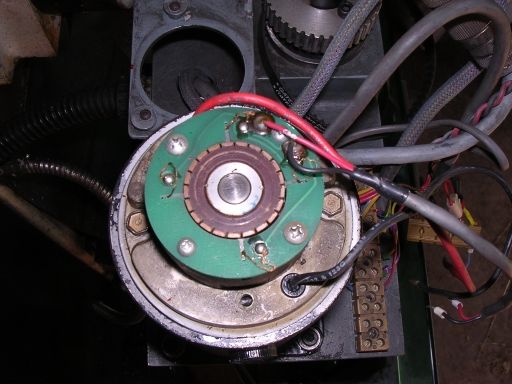

      Denford Senior 3C Mill (s/n 3C24037B, manufactured April 1987) – appreciate if anyone can provide info on the Z-drive quill servo motor.
      The quill has started “stuttering” and on inspection this is at a regular interval which corresponds to one bout of stuttering per rotation of the Z servo motor. Now traced to what I believe is a shorted commutator or failed winding on the Z servo motor (with the motor just on a non-CNC low-voltage DC supply it will turn through, say, 330 degrees and then jump the remaining 30 degrees). Am urgently trying to find a replacement or to get it rewound.
      Unfortunately there is no label or markings on the motor at all.  Denford have searched but it just predates the start of their archives; have also drawn a blank via the Denford forum.

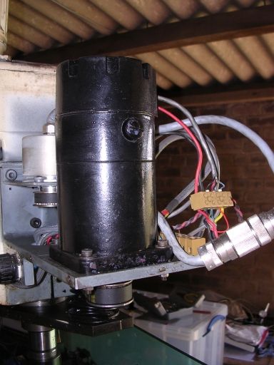

      Appreciate if anyone could advise – anyone have a parts list? or just the motor specs? or even better, a user manual? or even just recognise the maker? no label on the motor at all, castellated top may be distinctive? appears tacho is an integral fitting. Base appears to be NEMA-34 footprint. Current motor (2 brushes) delivers app 30 RPM / volt (minimum start voltage is just under 3v); free-running/no-load current (i.e. motor off machine) is app. 0.2A. Tacho (4 brushes) gives out app 6.5v / 1000 RPM.  Half-inch shaft protuding 1.5″.

                  Mark – thanks for the advice but am certain we’ve got a faulty motor. Have disconnected all of the CNC side and just run it off a lab DC supply and it still jumps (it runs OK for most of the revolution, stops momentarily, and then jumps forward). When driven via the built-in ASR Servotron DC servo amplifier/drive, but with +/- control voltage supplied from a manual pot, the jump is faster as the drive, via the tachogenerator, recognises the motor has ‘stalled’ and briefly increases the motor power to try to un-stall it and as a result it ‘leaps’ over the dead spot. With the servo amp driven as intended off the Heidenhain TNC, the situation is far worse as the encoder is then in the loop and the TNC drives it even harder and we end up with an horrendous oscillation as it transits the ‘bad spot’.
                  Unfortunately the other axis motors are much bigger, and there’s no chance of swapping-in a borrowed unit – we don’t even have an ‘ordinary’ motor rewinder here – its one of the very rare downsides of living on a rock in the middle of the Irish Sea !  I’m sure its not going to be a Denford or Senior specific servomotor, but it makes it a lot easier to replace or get it rewound properly if I could find the manufacturer’s details.

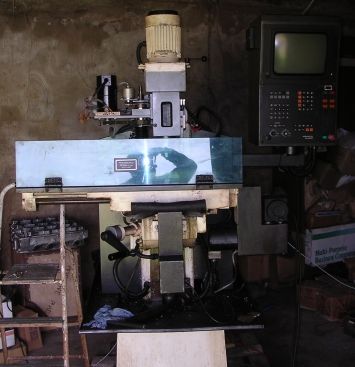

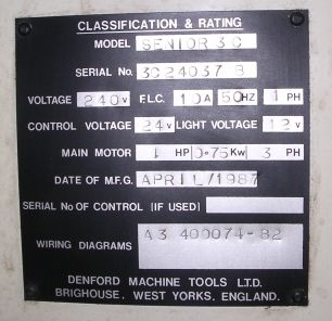

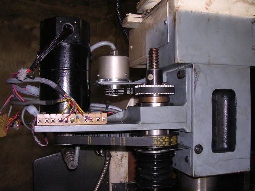

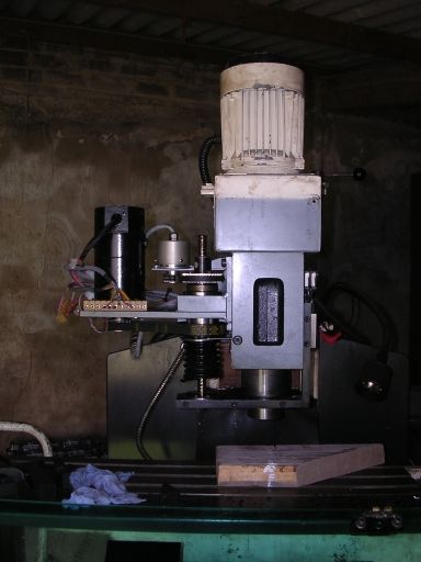

                  John (and David) thanks for the feedback. Firstly, apologies if the machine’s data plate looked like it was for the Z servo! – the offending servo is completely devoid of any labels at all. Have attached some more general photos below of the machine and the head. Ballscrew is static and the ballnut is driven 2:1 from the motor. Because of the proximity of the ballscrew to the head casting, and I guess desire to limit the overall height, the encoder is also driven off another timing belt.
                  Whilst the XY travels are great, the quill only has limited travel, so if the knee had been built with a ballscrew, I would have jumped now to use the knee as the Z – but as it only has an acme screw, I’m wary of wearing that out, and will persevere with the quill for now.

                      Well definatly sounds like a canidate for a rewind ! , i hazzard a guess that the motor is a Baldor , but as i know from experience ! , the usual fault with these is exactly what you suspected a winding fault probably shorted due to over heating , but i’d suspect more to do with age than anything else . you may pick one up off Ebay or go for a rewind if you’d still like to keep it running on servo’s .
                      you should be able to find a suitable motor as a replacement resonabely easy
                      by the size i’d recon it’s about 6 – 9 Nm
