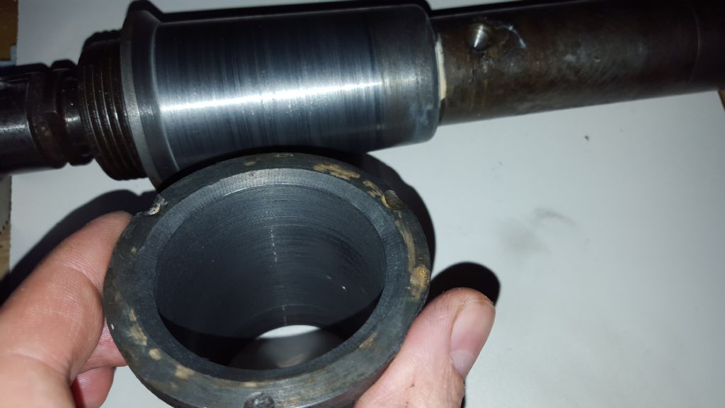

                          Hello I have just picked up a very old horizontal mill that seems to suffer from the same problem with the spindle locking up when tapped from the front, I have yet to identify the machine but it sounds very similar – the spindle having a large taper at the tool end running in a bearing sleeve (mine looks like steel on steel tho, I’m sure it shouldn’t be) have you been able to overcome this problem? Do you have any photos of your mill?

                            Jack. Yes, as pointed out by Paul I failed to recognize that the chamfer at the front of the spindle was the thrust face. My machine is Denbigh Type New B, information on http://www.lathes. Your machine may not be the same but all tapered bearings need some sort of thrust arrangement to stop the bearing locking up under end pressure, this could be located at the front or back of the spindle. I think there is a photo in my album, let me know what you need. I would be interested in pictures of yours. I wonder if your bearing is Babbit (white metal)?

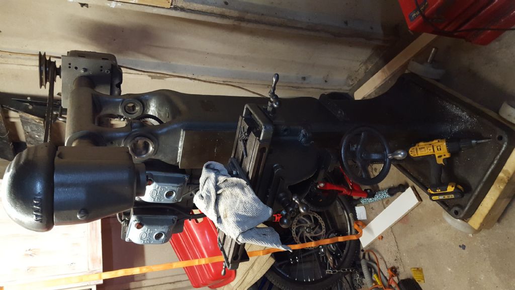

                              Thanks to your post coming up in google, and the shared locking problem i've managed to identify mine ad a Denbigh H4, but oddly it has had a vertical head fitted on the over arm as opposed to the arbor brace, I'm struggling to upload any photo's at the min – both the spindle bearing surface and sleeve are very hard ferrous, I'm wondering if they are cast iron, I seem to remember that cast on cast is self lubricating? I'll upload pics as soon as the site lets me,.

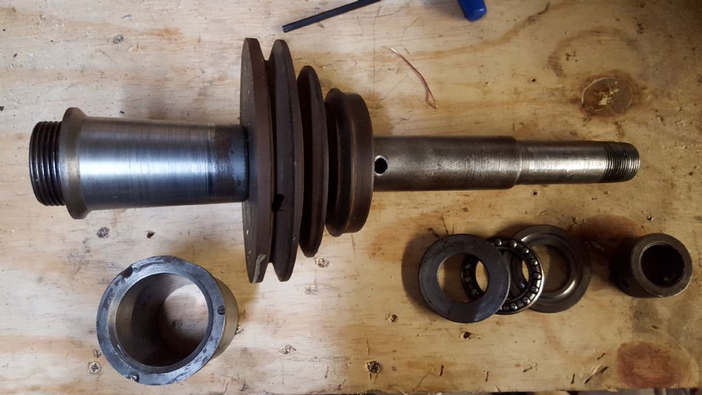

                                    #215838
                                    jack holmes 1
                                      @jackholmes1
                                      bearing in second pic- spindle removed from first one – spindle components below 20151210_201603.jpg

                                        Jack, nice photo's, the front bearing looks like cast iron, appears to be in reasonable condition. Probably worth reusing. I'm fairly sure the Denbigh spindles were all cast steel. My machine has a tapered bronze bush supporting the rear of the spindle (tapers in same direction as front bearing), this is carried in a sleeve with ring nuts at each end for adjustment. I scraped the front bearing to fit using a 1/2 round scraper and Micrometer blue, first the long taper and then the chamfer until the spindle would just fit without binding. I also replaced the original Gitts oilers with Adams type drip feed oilers. Very pleased with result. It's not unusual to have a vertical head fitted to the overarm, many horizontal machines had them fitted by the owners and manufacturers later fitted them. I recently made an adaptor to fit a Bridgeport M head to my machine, it's a bit more useful than the original vertical head and also has about 5" more daylight.

                                          Cheers Dave, I had a quick scrape at the sleeve on Saturday, the blue showed one very high spot and after gradually working away at it, the bearing now fits a whole lot better- no binding or locking up at all now! It could probably do with a bit more time, and the right tools (I only had a half round file available) but its definatly the way forward

                                            1/2 round bearing scrapers are available from the usual suppliers, not at all expensive. The bearing may compress slightly when you refit it, do a trial fit of the spindle and rescrape if necessary. Spindle and drive pulleys on my machine had never been balanced from new, it's something worth checking.
                                            #216331
                                              Don't overdo the scraping, both tapered faces of that bearing function so if you take too much off the narrow taper the broad taper will not let the spindle enter far enough.
