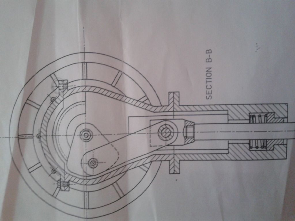

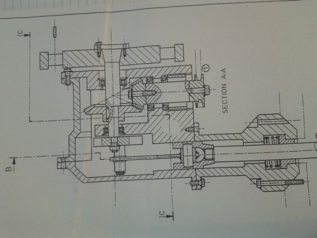

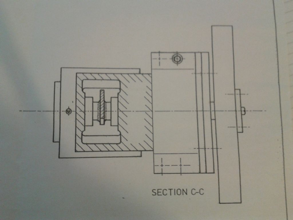

                                            Hi all, I think I may be on the same assignment I can link some photo's for you.. bare with me.
                                            Brad
                                            #115270
                                            Brad Christian
                                              @bradchristian60007

                                                I think Brad is on the same assignment as the mysterious Chris Beck so at least we know what the drawings look like.
                                                What we don't know is what the assignment is for, and therefore whether we would be doing someones homework (or their job!).
                                                I don't mind helping with homework but I think if this thread is to continue then the OP should have the grace to explain why he is asking the question.
                                                Ian
                                                #115276
                                                Jeff Dayman
                                                  @jeffdayman43397
                                                  Holy smokes! someone dreamed up a real clanger with that assembly. Where do we start? There's a lot more than 30 things wrong that I see….
                                                  A good general technique to figure out whether an assembly will even go together is to make paper tracings of the parts and slide them past each other on the assembly to see if they clear. Old fashioned, yes, but cheap and it works.
                                                  Another hint is that with rotating machinery for power transmission, each part attached to a shaft needs to be located (usually with a male/female cylinder to cylinder or cone to cone fit) and prevented from rotating relative to each other some way, like keys or dowels or ribs in slots.
                                                  It wouldn't hurt to read up on stress / strength in flywheels either – machinery's handbook has a good section about that.
                                                  It would be nice if our picture poster and the OP told us what class this is for and why they are asking the forum to chime in.

                                                    Thanks Brad,
                                                    I was expecting super duper CAD drawings – I guess this quiz has been handed down through generations!
                                                    I can see parts poorly located, wrongly fitted, over-sized, under-sized. There are ill-proportioned fittings and poorly designed joints, challenging machining operations and just plain bad design.
                                                    With the warning that I'm not a trained engineer, iI suggest you ask yourself:
                                                    • How does each of the parts move – will they clash or can they shift from their designed position?
                                                    • Are bearings correctly chosen and oriented for their designed loads.
                                                    • How would you machine each part – are there things getting in the way that cold be designed out?
                                                    • Look at the proportions of parts – is anythhing oversized or undersized relative to other parts carrying similar loads.
                                                    • Where would stress concentrate in the design – are there sharp internal corners or thin sections in these places?
                                                    • What makes an efficient flywheel?
                                                    • Could anything be changed to make assembly easier?
                                                    • How are parts mated together – do they have reliable secure joints where fixings just keep them secure, or do the fixings carry the loads?
                                                    Go through that list and you should be getting near your 20 things.
