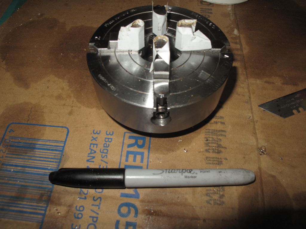

        I currently have a 4" Pratt Bernard independant chuck that its jaws are looking worn out, either that or the sloop in the jaws suggest it is a chinese fake.
        Any suggestions for a good quality replacement, perhaps with bigger jaws as the current one isnt up to holding very much?img_4850.jpg

                I'll give you 10 quid for that worn out counterfeit chuck you have in the pic.
                #490855
                not done it yet
                  @notdoneityet
                  I’ll give you 11 quid for it!🙂 Apart from ‘looking’ worn out, what is actually wrong with the chuck?
                  I often use a 100mm chuck on a larger lathe than yours. Likely half the weight of the usual chucks in general use.
                  It’s definitely a fake if it is really marked as “Pratt Bernard”.
                  #490856
                    Going by the marks on the tape the front of the jaws are not making contact assuming it was used on something parallel.
                    Bison would be another option for a replacement.

                        Seriously, there have been posts on here before of as new PB chuck with mis-manufactured jaws that did not grip parallel. Easiest fix is take the jaws to a machine shop with a surface grinder and get the gripping faces ground square to the surface that slides in the chuck body. Or you can grind them in situ in your lathe with s toolpost mounted Dremel tool. Search this forum for past threads on Pratt Burnerd jaws or similar for further info.

                            A few more photos would help. It's not clear to me what the problem is. Jon says the jaws look worn, and then covers them with tape! Could be the jaw faces have been abused, or screws & teeth mangled by excessive tightening, or perhaps the wrong jaws have been fitted. (Not all pre-loved lathe owners are geniuses!)
                            Reassuringly expensive products are not immune to mistakes or being thrashed. Assuming the chuck body and screws are OK, possible to buy replacement jaws for Pratt Bernerd chucks, though unfortunately the company is a Price on Application operation. Whether or not spare jaws can be found for an old chuck is another question.
                            Assuming the worst and a replacement is necessary, ask if buying a 'decent' chuck is worth the money. 'Decent' is deeply suspect as an engineering specification. Professionals look for 'value for money' and 'fit for purpose' rather than 'decent,' 'good' or 'quality'. Those words waste money galore because best is the enemy of good enough.
                            Expensive tools tend to save time rather than provide marvellous extra capabilities. And they usually resist wear and tear longer in busy workshops. Being smooth in operation makes centring work in a 4-jaw that much faster – but not more accurate, or with a stronger grip! Down to the operator to decide if smooth operation and long-life are worth spending money on. Time wasted by second-class tooling is irrelevant to the experimental moderate precision work I do. Same tools would be a major problem if I machined for a living: time is money.

                              Interesting points, firstly I am fairly new to using 4 jaw independent chucks. I have don a fare bit more on my 4" PB self centering chuck, which I think is the grip tru version. As most will appreciate the jaws of the former are more robust being larger and give me confidence they can grip much larger work.
                              The PB 4 jaw 4" PB chuck is the light duty version. the jaws in there current state rock back and forth and side to side! I don't think the scroll is seriously damaged so I think replacement jaws could be ordered.
                              However I am looking to hold the same same scale of work that I can with the 3 jaw, plus odd shaped stuff eg rectangular. I suspect that the light duty 4 jaw has been used beyond its normal load capacity leading to slackness in the jaws.

                                  That 4 jaw doesn't have a scroll. If it is a fake you won't be able to get new jaws and ones from PB won't fit any better if at all.

                                            I have exactly the same PB chuck on my ML10. It is in the same state as yours (which isn't a copy but the real McCoy)
                                            It was knackered when I purchased the lathe, but everything else was fine. I suspect it is far too lightweight for any serious work apart from very small objects.
                                            I took the Bull by the horns and enlarged the slots and loctited in some spacers to bring it back to nominal. The jaws were OK. It isn't perfect but infinitely better than it was.
