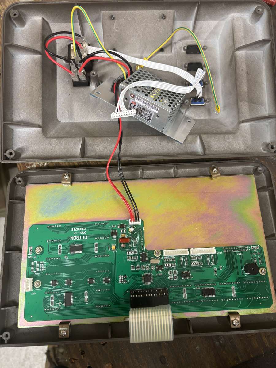

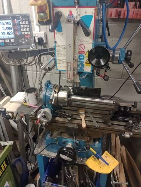

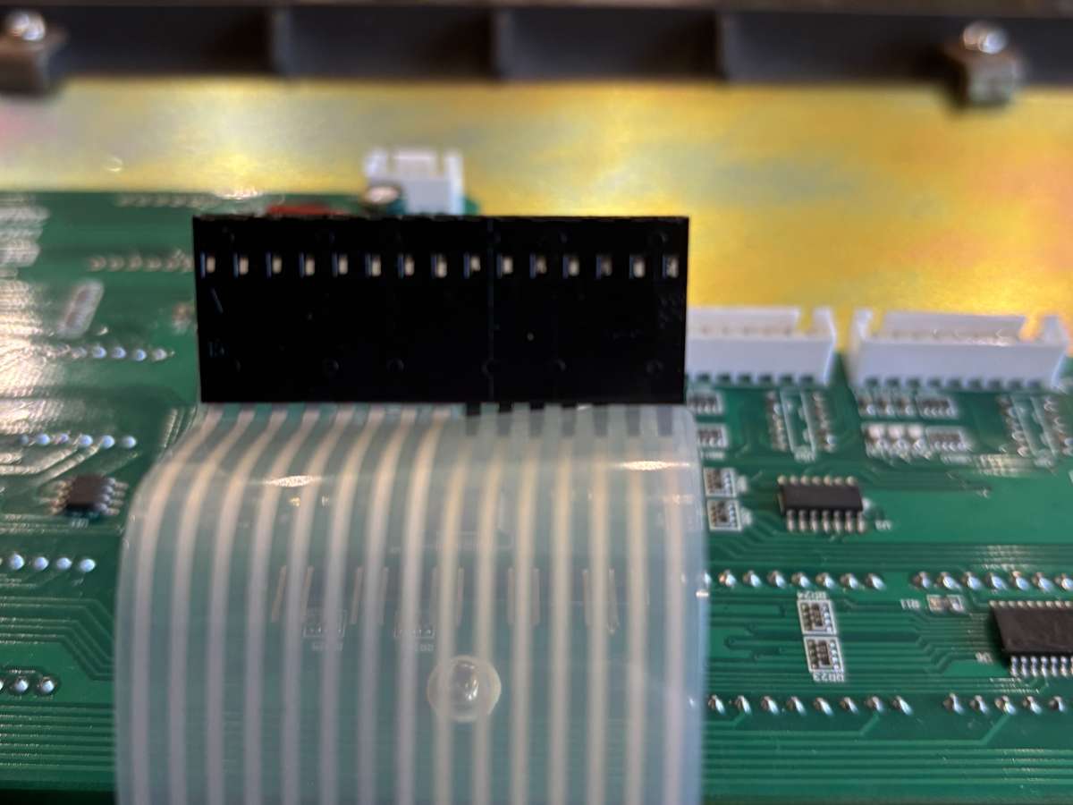

      In the midst of milling a cylinder casting for the Halls Rotary engine on my Warco WM16-V mill last night the DRO readout suddenly and very annoyingly (as in I’ve lost my datum) expired. The 2 mains fuses tested to be OK so I opened up the unit to find the internal power supply is working fine and all internal connections seem good, so sadly it appears that the PCB has failed.

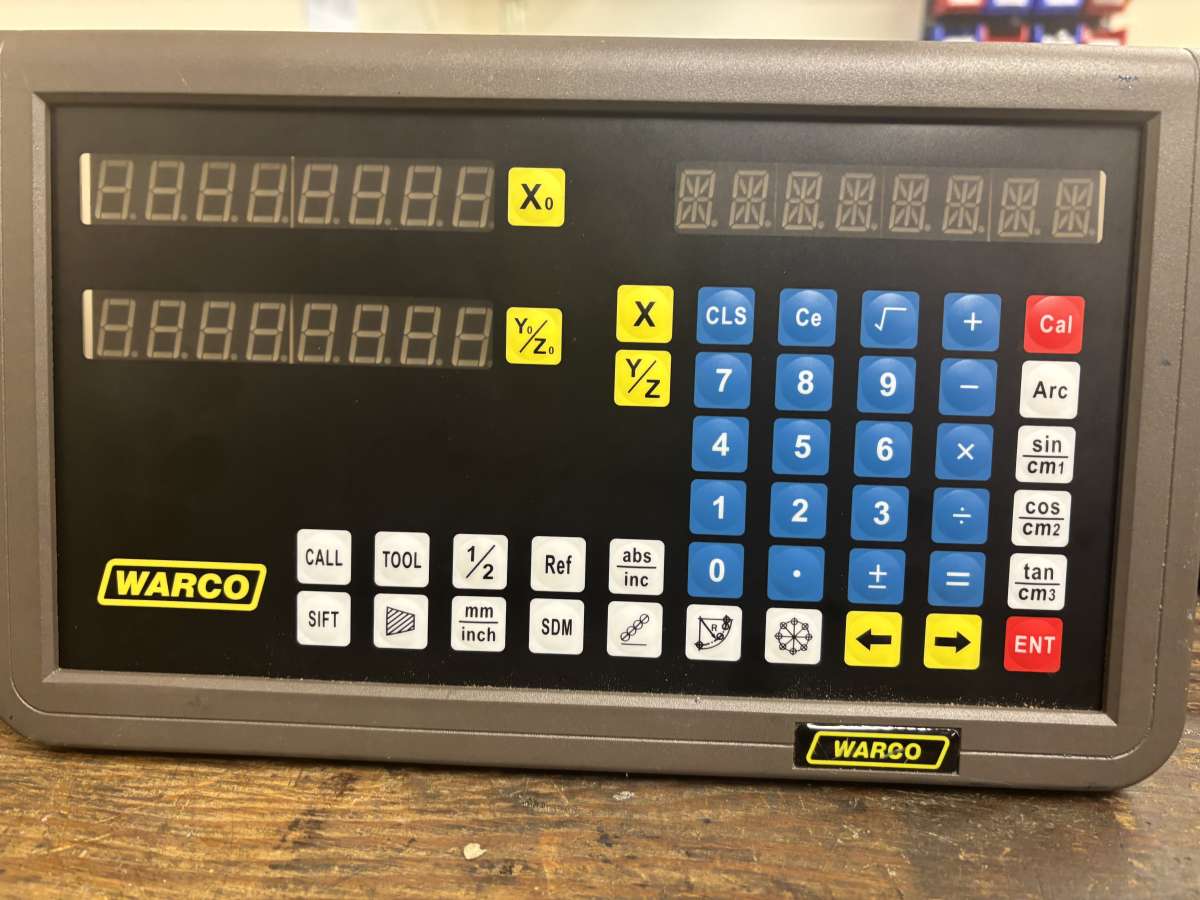

      The failed unit is a 2-axis Ditron D60 (badged as Warco) supplied by Warco several years ago, but they don’t sell it any longer. Warco supply a modern equivalent but a) it’s currently out of stock and b) it costs £189.  I have found the actual Ditron unit online but cost is still £150+.
      Before ordering I’m just wondering if anyone has encountered this before and has found a lower cost alternative, or even has a Ditron D60 DRO readout they don’t need ??

        Does the display have a ribbon connector? If so they can loosen.

          This LED type is better. They are £115 on eBay much better functionality with visual display of functionality, hole layout etc. I’ve had the ones like yours and sold them on. There seem to be 2 types of wiring for the chinese scales. If you are lucky they will just work if not you will need to swop some wires on the plugs. I have a diagram of scale plug wiring somewhere from when I upgraded to the LCD ones.

              Hi Dave, thanks for the suggestion. It does indeed have a printed ribbon connector as you can see at the bottom of this pic, I checked it is firmly mated.
              On power-up it goes through a self-check routine and the key-press beeper beeps as the display cycles round, but it isn’t beeping either, so it’s not just a display problem.

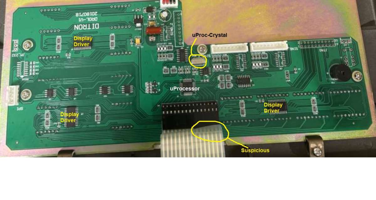

                        Since all appears dead, most likely it is the u Processor not doing it’s job.  Straight failure of such device is rather rare, and often can rather be attributed to associated components – often the crystal. the crystal has 2 pins, one each going to a pin on the uProc. Also from each pin to ground will be a capacitor – in your case a small surface mount device. if one of these has failed – cracked, end not soldered properly – no oscillation, and the uP is dead. Worth checking that out under a magnifier. Also worth removing the PCB from the front panel – 4 screws – and checking the underside as well. Most times the PCB mechanical mounting stress causes small SMD devices to fail – crack, or break a poor solder joint.
                        The ‘suspicious’ label refers to the ribbon cable bulge – does not look kosher, but that cable is possibly only the keyboard interface.
                        Partially dead is often not worth repairing, esp if old, as it means finding replacement IC’s etc – totally dead is sometimes easier as most times it is a single component sitting in a critical path, ie, its failure kills all, so, PSU, Crystal oscillator, uP reset circuit, etc

                            I like Joe’s suggestion – the crystal!  Easy enough to check if you have an oscilloscope or a radio that covers the range.  Another way is there may enough RF coming off a crystal pin to rectify the protective diodes in a analogue multimeter.   Putting one lead on results in a reading, so the crystal is working.
                            Decided to test this on the Arduino Nano I’m using for the Flashing LEDs topic.  Oh dear, I’ve half killed the Nano, probably by shorting two pins together – clumsy repairmen are a menace!
                            Power OK, oscillator still running, onboard serial IO LED flashing as expected,  but USB and the hour, minute and seconds LEDs are all dead.  Pretty sure this Nano is done for.   Condensation or a sliver of swarf can do the same sort of damage.
                            I shall have to replace the Nano…

                              Hi Joseph, many thanks for your really helpful response. I suspected the oscillator, it looks OK physically, I am currently trying to scrounge an oscilloscope to see if it’s running. The ribbon is just for the keypad as you thought, I initially thought it had delaminated but it seems it was made like that. I will check the oscillator if I can borrow an oscilloscope, and if its not running will call it quits – I need to get milling again!
                              Dave thanks for the link, I did wonder whether there is standard pin-out for the transducers / D-types as there are no pin designations on anything. If I do have to change display units hopefully I can just connect up to the currently installed devices as they work very well and it would be a shame to disturb.IMG_3040IMG_3039IMG_3038

                                  Dave’s idea of using a multimeter is not good…That usually stops the oscillator and leave the uP pin at a logic level that you the interpret as ‘working’..
                                  You could check as well what goes on under the crystal – in production the SMD devices are normally fitted first. When they do the leaded devices, esp if done manually and the solderer is a little judicious with solder, it wicks thru the hole and makes a dome on the other side of the pcb – under the crystal. Few mnfrs fit insulators between crystal and the board. If a ball of solder touches the crystal case, it’s sort of OK, but if if both pins have balls, the crystal  be shorted. Measure with an ohm meter between the ends of capacitors CJ1 and 2 – they appear to be the two caps connected to the crystal. One end of the caps should go to ground and be common. The other ends should not be connected to each other..

                                    Dave – sorry, isee you said -one lead- so no DC would be measured – but no AC either as the osc stops..

                                      Dave, no shorts around the crystal. Will let you know what happens if I get access to to an oscilloscope

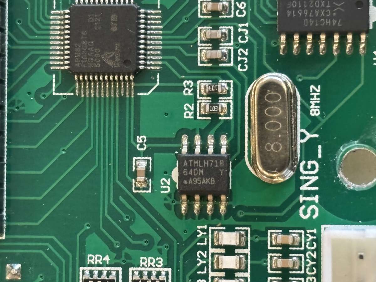

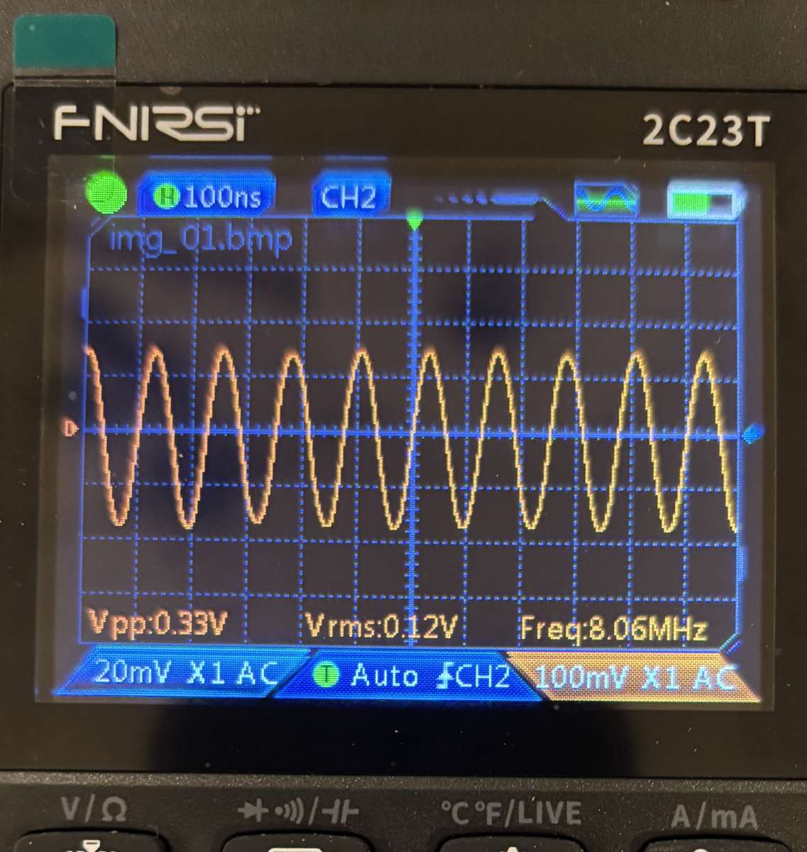

                                              I have managed to get use of an oscilloscope, the crystal is indeed oscillating at 8MHz, though I don’t know if the amplitude of the oscillation is OK at 0.33 V peak – peak? This is measured with AC coupling from ground to a pin of the oscillator. The microprocessor is completely dead.

                                                  The oscillation is good.
                                                  The CPU looks like an STM32F103 – the reset pin is on pin 7, right next to the crystal connections ( 5 and 6) . Check that the pin is Hi when power is on, and try short it to ground momentarily ( before the bofs get upset with this since the reset driver might be an active device , a quick short to ground won’t kill anything…).
                                                  It the CPU does not wake up, then try to scope the pins on the attached E2Prom – U2 ( actually an AT24C01 or 2).
                                                  Pin 5 = SDA and 6 = SCL
                                                  Look at pin 6 = the CPU would very soon after reset try to read data from the E2Prom and generate clocks on pin 6 to do this – You may need to play with the scope trigger to see the clocks..they would probably be around 1us period clocks, and probably in a group minimum of 8 clocks.
                                                  The E2Prom stores your settings ( inch/metric, etc) and would be read to restores these settings.
                                                  Pin 8 of said chip should be 3.3v ( I think you did say you checked for correct voltages on the board?)
                                                  Since you have the scope, it is worth looking at other CPU pins to see if it attempts at all to access display drivers, etc – The STM32F103 data sheet, page 26, shows the 48pin device pinout. Look on the PCB to see which pins are connected and scope the pin after a reset..Sometimes best to set the scope in ‘normal trigger’ mode, ie, not auto trigger, set for 1V div, DC coupled, set the trigger line midway – 1 to 2v above ground, and fiddle..

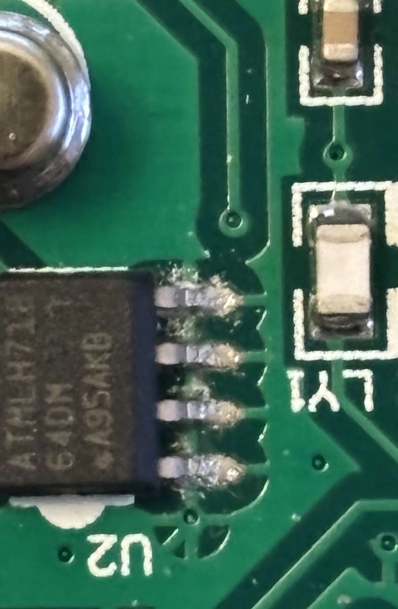

                                                    Many thanks Joseph. The processor is marked as ARM APM32 F103CBT6, but the OSC pins are 5&6 and the NRST is on pin 7 as you say. The reset is always high and grounding doesn’t bring it to life.
                                                    U2 is marked as Atmel ATMLH718, which I think is equivalent to AT24C01 but have struggled to find a data sheet.

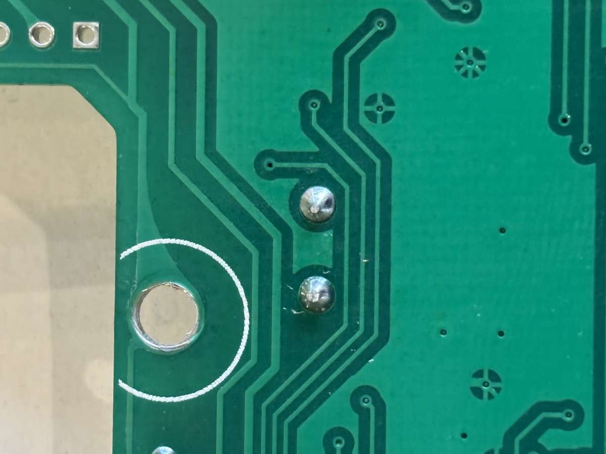

                                                    The SCL line (pin 6) just goes high on reset, no sign of any clock pulses. The odd thing is that the 3 address lines (pins 1,2, &3) are all connected to ground?
                                                    IMG_3077
                                                    I have indeed checked the supplies on the chips and all seem fine.
                                                    The CPU does seem to be completely dead unfortunately.

                                                      I have a data sheet if you would like – can email it to you – but if there is no CPU activity it won’t help…
                                                      The address lines all at gnd is ok – they are used to set the I2C address of the device – allowing 8 devices on the same I2C bus.
                                                      The ARM number is the same as the STM32F103. I use the STM devices a lot and have never had a processor just die on me, or at least that I have not killed…So I am still suspicious of the failure you have – so unlikely for the processor to die like that.
