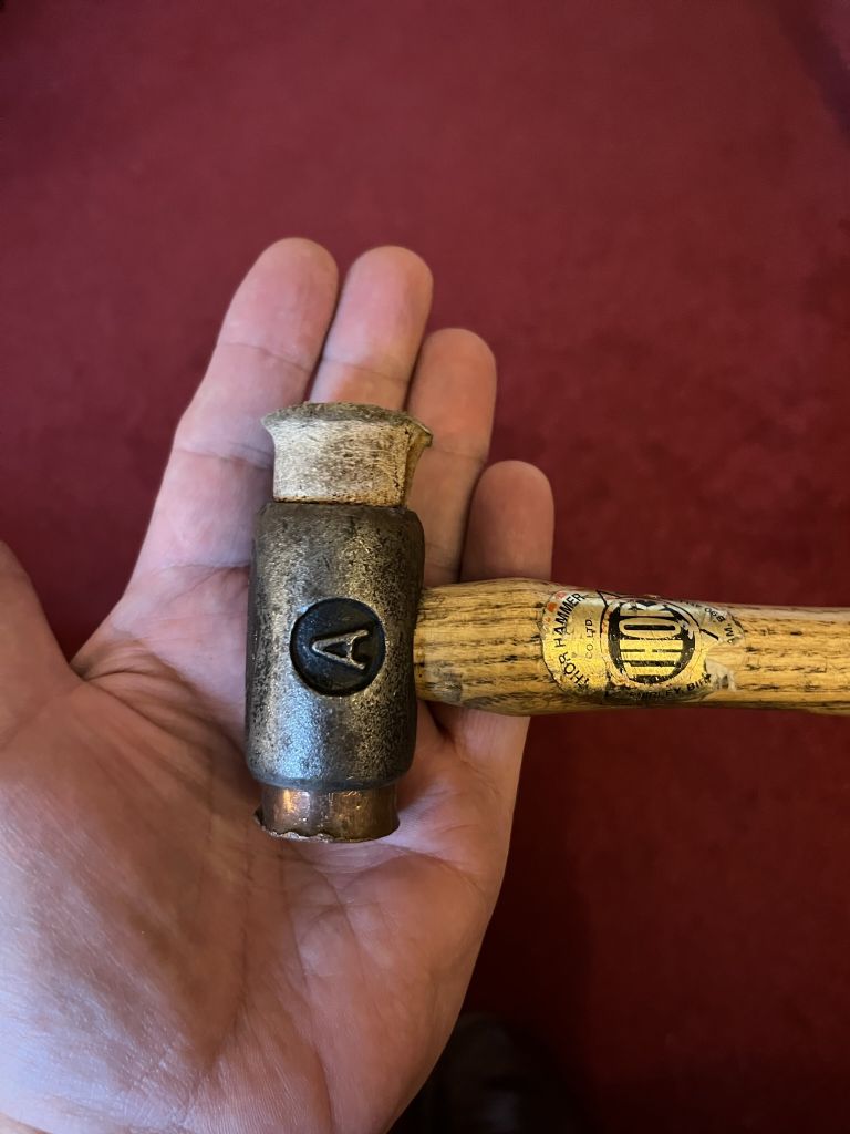

      Mike Poole
        @mikepoole82104
        My Thor A
        Thor A
        #636402

          Posted by JasonB on 06/03/2023 14:45:27:
          The do make a smaller size A with 25mm dia ends.
          Are you hitting the work after tightening the vice, if it is just nipped up then you are more likely to get things jumping about as well as getting jaw lift when finally tightened.
          OK I'll have a look for the 25mm Thor Hammer.
          The work is usually nipped up, but not fully tight. It seems to sometimes seat on one side, but not the other, and takes a few ever lighter taps side-to-side to seat it (sometimes I can hear when everything is seated OK). I thought that something with less spring might make it easier and less hit-and-miss. It's like every time the vice is tightened, it can very slightly displace the work, and when I'm trying to get something square, it's a pain. By the time the vice is fully tight, there's always that bit of doubt left that something hasn't lifted.
