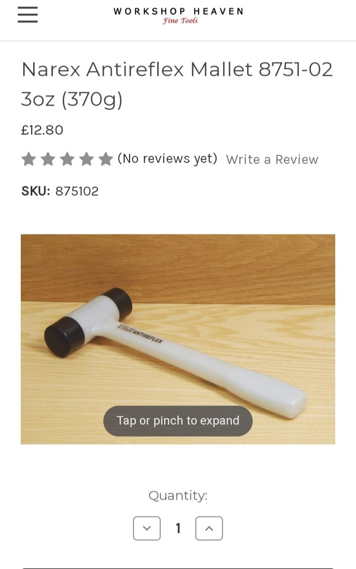

      Posted by Pete. on 01/03/2023 22:41:16:
      Narex make the most suitable hammers for machine use imo, they are fully plastic […]
      That’s presumably the one to which Jason was referring.
      … I admit I had never seen one until you posted that.

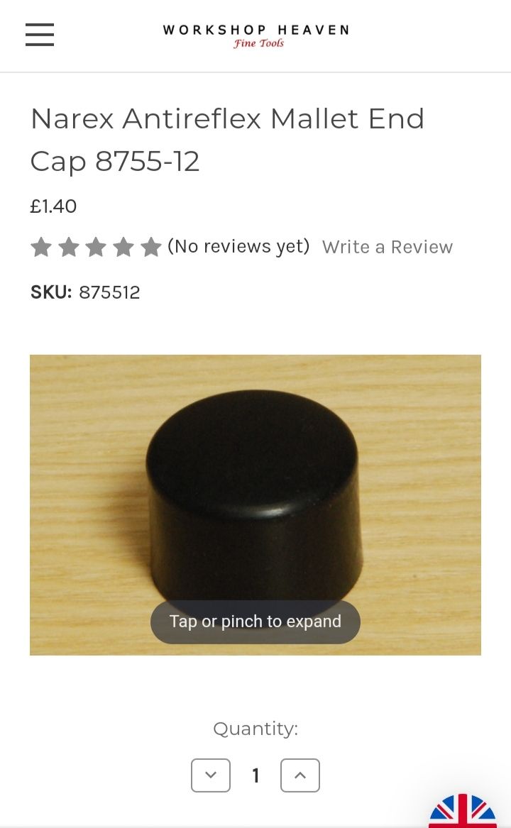

                                      Narex make the most suitable hammers for machine use imo, they are fully plastic so won't damage the machine in any way, are dead blow and have replacement faces available.
                                      I ordered one of these – arrived today. I must admit it's blow is not very dead – in fact if anything it bounces worse than my existing Thor copper hammer. There doesn't sound to be much more than a pinch of "lead" in it either.

                                        Copper naturally absorbs shock it will always be better than plastic in this regard, if you want a copper version (didn't mention in original post) I would have recommended the copper faced version below, or rubber faced faced option etc…

                                            Pete.
                                              @pete-2
                                              Posted by JasonB on 04/03/2023 20:58:42:
                                              So why was the Narex suggested if copper is better with regards bounce
                                              Because an opinion on dead blow hammers was asked for.
                                              Because a specific task was mentioned, tapping work down in a vice, my copper mallet leaves copper smeared on what I use it on, so it wouldn't be my first choice for using on workpiece.
                                              I use both for different things, dead blow hammers come with many different faces, because it has a dead blow feature shouldn't change the face material chosen for a specific task, I don't use my copper mallet for centre punching because it's a small area and digs in to the face, I do use my dead blow ball pein though.
                                              #636380
                                              Dr_GMJN
                                                @dr_gmjn
                                                Just to conclude this thread:
                                                I did mention I had a copper/hide hammer in my second post. I've actually got about six Thor hammers of various sizes and types, but that's another story. I wanted a smaller hammer than the smallest Thor one I've currently got, specifically for the model engineering work I'm doing.
                                                The Narex hammer (the smallest one available at 180g) is described as being "bounceless" and having "zero recoil".
                                                Which sounded fine. On arrival, it was the perfect size, but it is absolutely not "bounceless" and does not have "zero recoil". After doing a quick subjective test between the Narex and with a similarly sized solid metal hammer, and the Thor copper face, they all bounce by about the same amount when struck on a solid metal surface (BTW on another point raised; I've never hit anything hard enough with a copper hammer to leave traces of copper on the surface).
                                                The only one of the three to have zero recoil was in fact the hide face of the Thor hammer. Unfortunately the face is really too large to precisely tap a lot of the jobs I want to use it on, and also not particularly well defined.
                                                I think a very small hide hammer would do the job, but I'm not sure they're available.
                                                Anyway, I contacted the Narex supplier this morning, who said they would give a full refund, so nothing lost, but yet another hammer gained.
