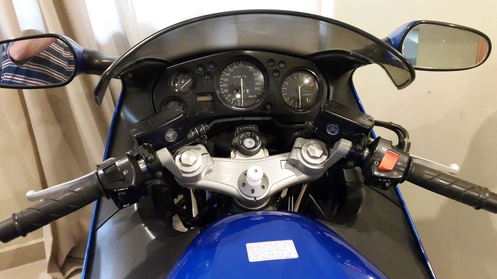

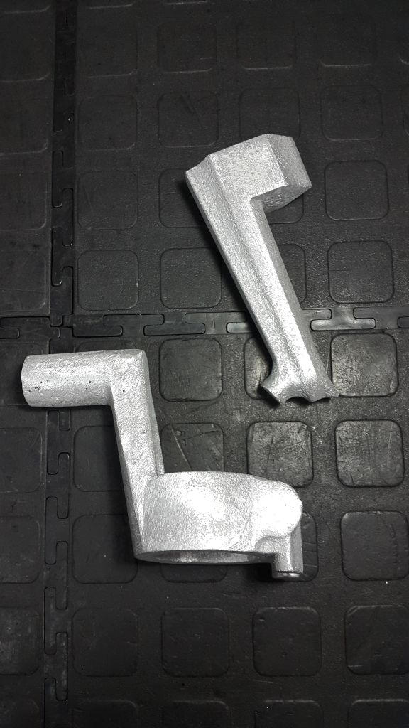

                    Starch works as a degasser (for aluminium) or footpowder. If you have turbulence when pouring you will get gas pickup especially if you have too much superheat.
                    Cast these recently to make my bike a little more comfy.

                            Posted by Luker on 21/10/2022 14:07:41:
                            Nice bar risers Luker, cost me a fair bit when I had to buy some for my Blackbird a few yeads ago.

                                  Posted by Bezzer on 21/10/2022 19:05:11:
                                  Thanks Bezzer. Made my bike a dream to ride! I redesigned the risers completely. They moved back with less of an angle backwards, raised and the vertical angle is different aswell. These were cast from Mag wheels, and I didn't get any gas issues or inclusions. I didn't de-gas any of the castings done on this day. Cost me nothing to do, even the wheels were free from a friend that moved…
                                  Sand additives and dusting was normal flour.
