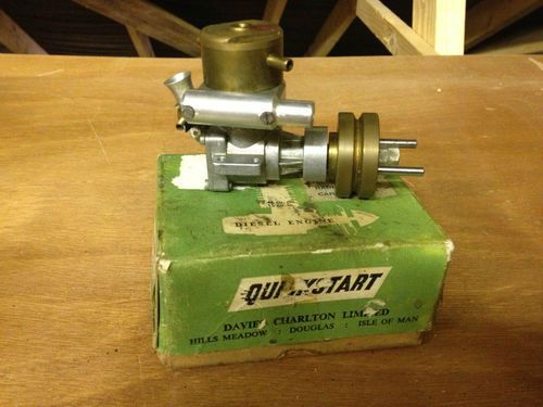

      hello
      I have recently bought 2.5cc Dc Rapier marine, for christmas lol. It's definatley not for sale, as i have been searching and searching and searching for one of these. My dad has a rapier marine also, but is missing the r/c carb and the liner, which one day we might actually get round to making. Anyway, mine, it too is r/c, boxed, empty sales card, and the tool for taking the exhaust ring off. What would an engine like this be worth?
      Thanks
      Rich laugh

        Jeff Dayman
          @jeffdayman43397
          About 10 UK pounds as is, 30 UK pounds running, I would imagine, not that I would make an offer, I wouldn't, anyway.
          Old does not necessarily equal valuable.
          Just my opinion. Others may disagree. Your mileage may vary.
          JD

            Well its got to be worth way more than that as a non working aero rapier without rc carb fetched 40 pounds and an aero rapier with just the needle type venturi can fetch anythin from about 80 up. I saw on ebay a while back an NIB limited aero rapier came for about 200. I know the marine version of the rapier are pretty scarce since ive only ever seen one for sale…which is infact the one i own now.
            Thanks
            rich

              It would be a great mistake to confuse ebay cost with actual value. Unless of course you are a "collector", where people seem to be prepared to pay silly money for what used to be called grey porridge.
              cheers
              bp

                It's worth what someone will pay. If no one wants it it's worthless. Simple. If you don't want to sell and you want to keep it why worry about monetary value?
                Terry

                  Some of these old engines do fetch a good price as they are now "collectors" items, hopefully Ramon will see this post and be able to shed some light on the price as hes into old diesel engines.
                  J

                          This is definately a small marine engine takes me back may years please (about 50) do not sell it on, the 2 ports one for water comeing in and other for water going out just like the big ones. The flywheel you put a cord around it gave it a good yank should start still has the compression screw and needle in wraping so was to be run on a nitro mixture. the 2 pins they are for connecting to to the prop shaft.
                          At a good auction I would say 40-60 but they take 20% commision plus plus plus so could end up with as little as 15.00…. SO please keep this in the family.
                          Regards and enjoy your little find.
                          But if you are asking what it is worth in your header are you planning to sell it…
                          Bob
                          Edited By Springbok on 12/11/2012 09:19:54

                                Hi Rich and others, Have just caught up with this as been off for quite awhile.
                                I see the dreaded adverts are spoiling yet another thread but that's another issue with this bloody format on here – sorry David but it is frustrating
                                DC Rapier value – ah now, how long is a piece of string. Firstly Rich I'm really pleased you have managed to get yourself a good example as obviously this particular engine means something to you. It's value is very much down to what ever someone wishes to pay as has already been said. That's not to hedge bets but simply the way it is.
                                For nostalgic reasons I too was looking for an aircooled DC Rapier for quite sometime. A friend contacted me to say there was one on Ebay and we both watched with incredulity as obviously two people fought each other and pushed the price to well over two hundred pounds. This was not even an original 'still in box' but one that had been rebuilt, and re-anodised. Why this should attract such a price is beyond all who I know with an interest in such engines. A dealer, selling one 'as new in box' would probably ask around a hundred or so but at a local swapmeet you'd probably pick one up for a lot less.
                                Some diesel engines however do have extremely good value on the resale market – of the commercially made engines Oliver Tigers and Eta 15's particularly, good examples fetching well over a hundred regularly but the average engine – ED Racer, Frog 2.49 (to keep to 2.5cc) will be considerably down on that though there are always exceptions.
                                You've answered your own question actually in that really, it's quite 'priceless' – to you – as it obviously means a lot. I have had over some fifty odd years so many many engines but only one ever really meant anything (Dooling 29) and in a weak moment I foolishly let that go to my eternal regret.
                                Starting diesels – once the normal compression is found it's fairly straight forward but when a silencer is attached it can get a bit fraught as you are not able to give the exhaust a direct prime having to rely on a carb prime or finger choking to get the fuel into the cylinder and doing this it is very easy to flood the engine. Flooding leads to having to back off the comp screw usually leading to losing settings.
                                It's much easier if you drill a small hole in the silencer just opposite the exhaust port to enable a small prime, open the needle no more than a turn from running setting and fundementaly leave the compression alone or at most back it off no more than half a turn. Once the engine fires let it 'burp' a bit until it warms up – it may stop and need to be restarted – don't be tempted to mess around with the compression if it does as within a couple of short burpy runs or so it will continue to run then, as it warms, close the needle gradually to lean it and then adjust the compression to give a smooth run. Hope that's not teaching granny.
                                Just one last thing – I'm sure you know this already but Springboks reference to 'Nitro' fuel is misleading as this is for glow motors only. Ether based model 'diesel' fuel is what is required.
                                Good luck with it – at least flywheels don't bite your fingerssmiley
                                regards – Ramon

                                  Thank you for correcting me as I said it has been many years since I used these in a model, well over 50.
                                  Have fun
                                  Bob

                                      Rich, Many engines come up weekly on Ebay
                                      Click on Categories – then Toys and Games – then Radio Control then put 'engines' or 'vintage engines' in the search.
                                      If you want to diseminate Aircraft from Boats click the arrow to the right of Categories then Toys and games then RC – you then get a choice of aircraft or boats.
                                      Barton Model Products are sellers of vintage engines and if you take a look at 'Gildings' auctioneers you can surprise yourself at what some will pay – at an auction – for (at times) some pretty basic engines
                                      Regards – Ramon

                                        Hello, nice engine. Judging from the photos it looks in new or nearly new condition.
                                        On Ebay, if accurately described, with plenty of close-up photos, worldwide postage, listed in r/c boats and r/c aero engines, it should go for anything from £80 to £120. Ebay take 10% from the selling price.
                                        Davies Charlton engines were at one time (1950's?) based in Barnoldwick Lancashire. I live very close to 'Barlick' and have asked quite a few people over the years if the have any memories of the company and its products, but have always come up with nothing, even though the company regularly had full-page ad's in the aeromodelling press. They eventually moved their company to The Isle of Man.
                                        My brother had the air-cooled version. It was well made and very easy to start and adjust with KeilKraft nitrated diesel fuel.

                                          I follow the sales of diesels on Ebay fairly regularly. The high priced example quoted is highly unusual and not to be taken as a bench mark. The DC Rapier is more desirable and scarcer than the Sabres. This example is Marine with flywheel and silencer, and has the box, which is worth quite a lot. Sabres go in the range £20 to about £45. I reckon this example to be worth maybe £45 – £65.
                                          Diesels can be choked in 3 ways – finger choked, prime through intake, and prime through exhaust and each one has its own particular requirement. Radial port diesels like a prime through the exhaust, but with a silencer fitted resort must be made to the intake prime. Some people are good diesel starters, and others struggle. The difference is in the speed of the flick and the setting of the propellor. I favout the prop set at 20 past 10. The flick should carry the arc well past TDC, and be very fast. Initially after the prime the compression can be slowly increased until it suddenly becomes a little hard. Then it is backed off slightly, which should result in firing. The needle setting is critical and taper on the needle and the threads vary. Before starting,some idea of the setting can be obatined by connecting a length of fuel tube to the spraybar nipple and blowing through. There should not be too much back pressure, but it should not be too easy to blow through. Some needles do not actually open the jet at all until maybe 2 turns.
